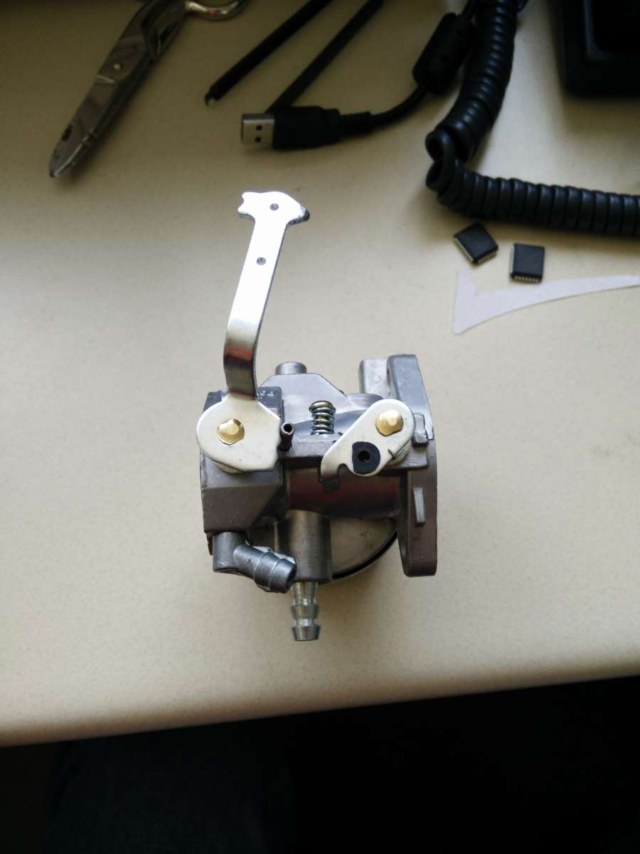

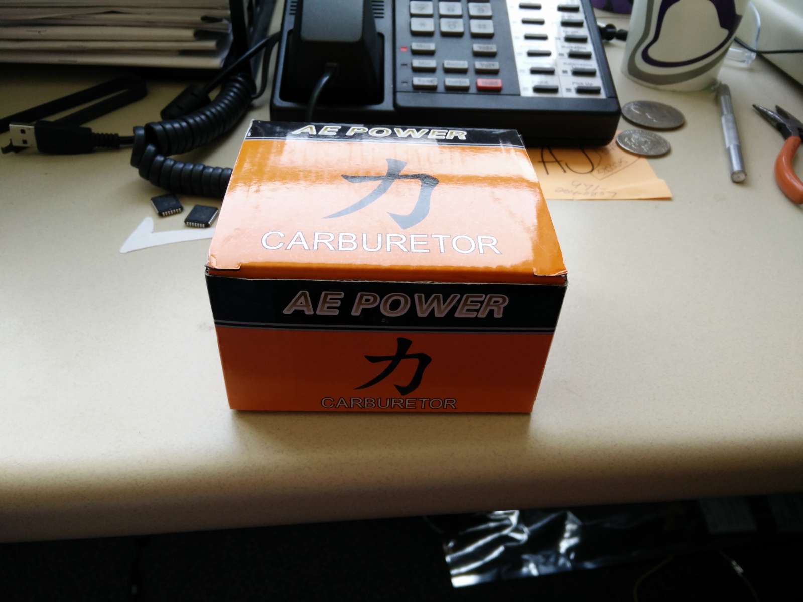

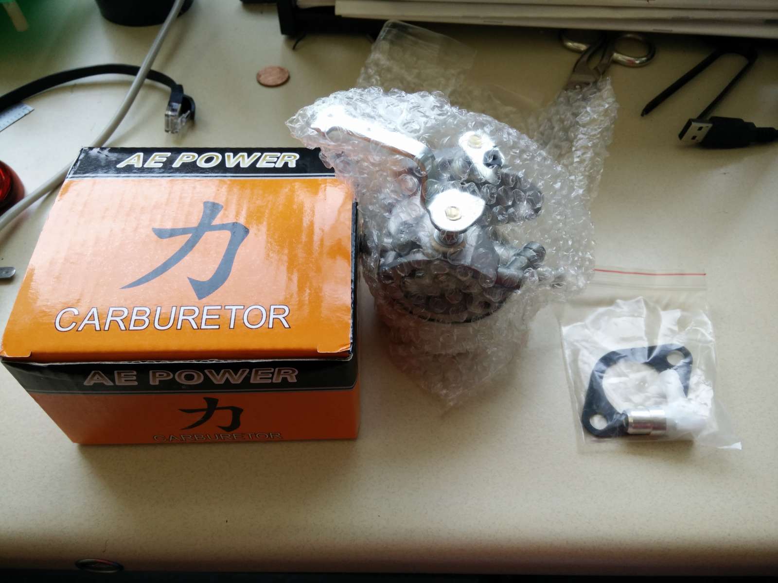

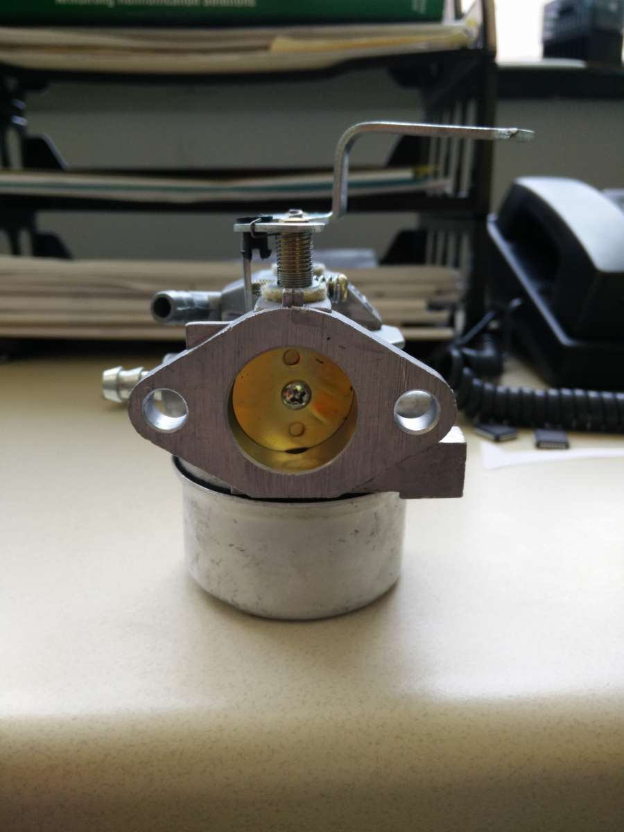

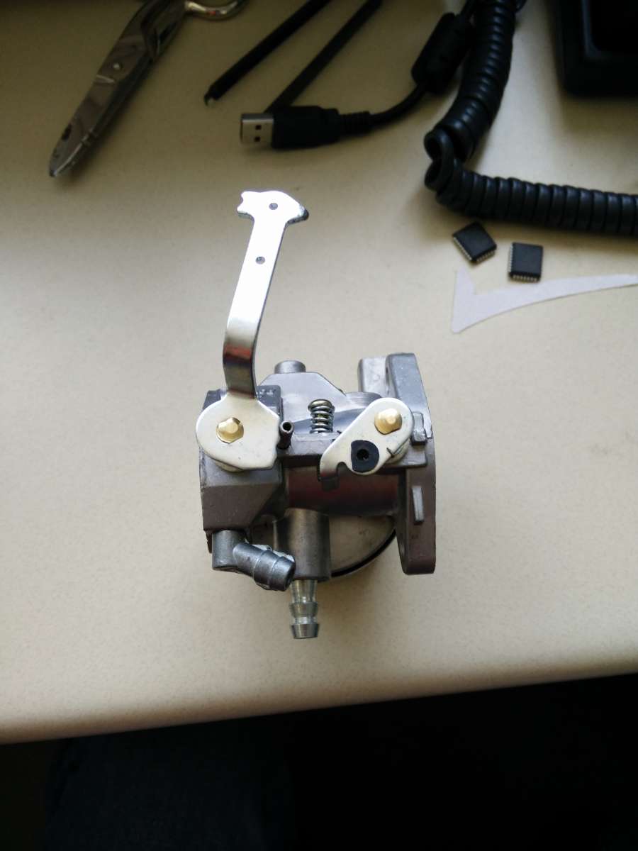

New Techy carbs was created by AJ WH Ranger

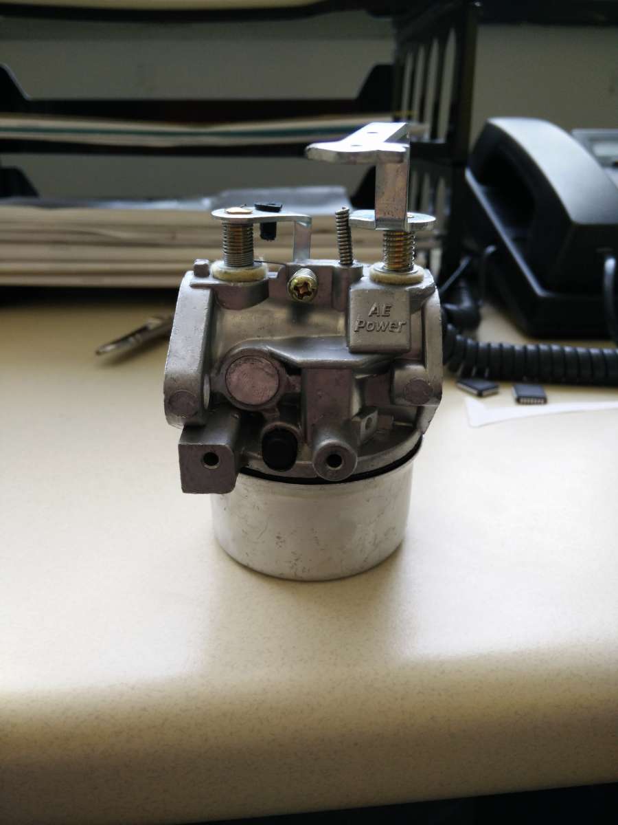

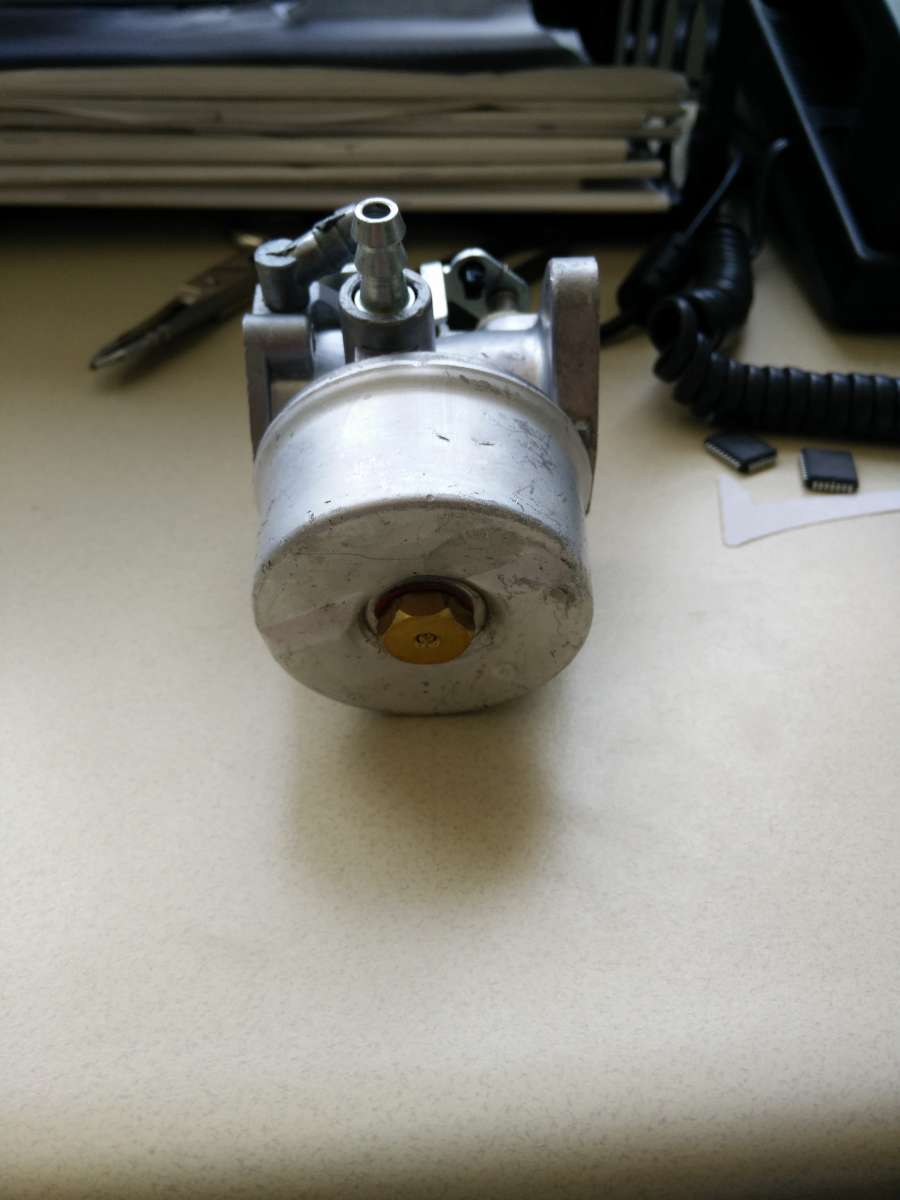

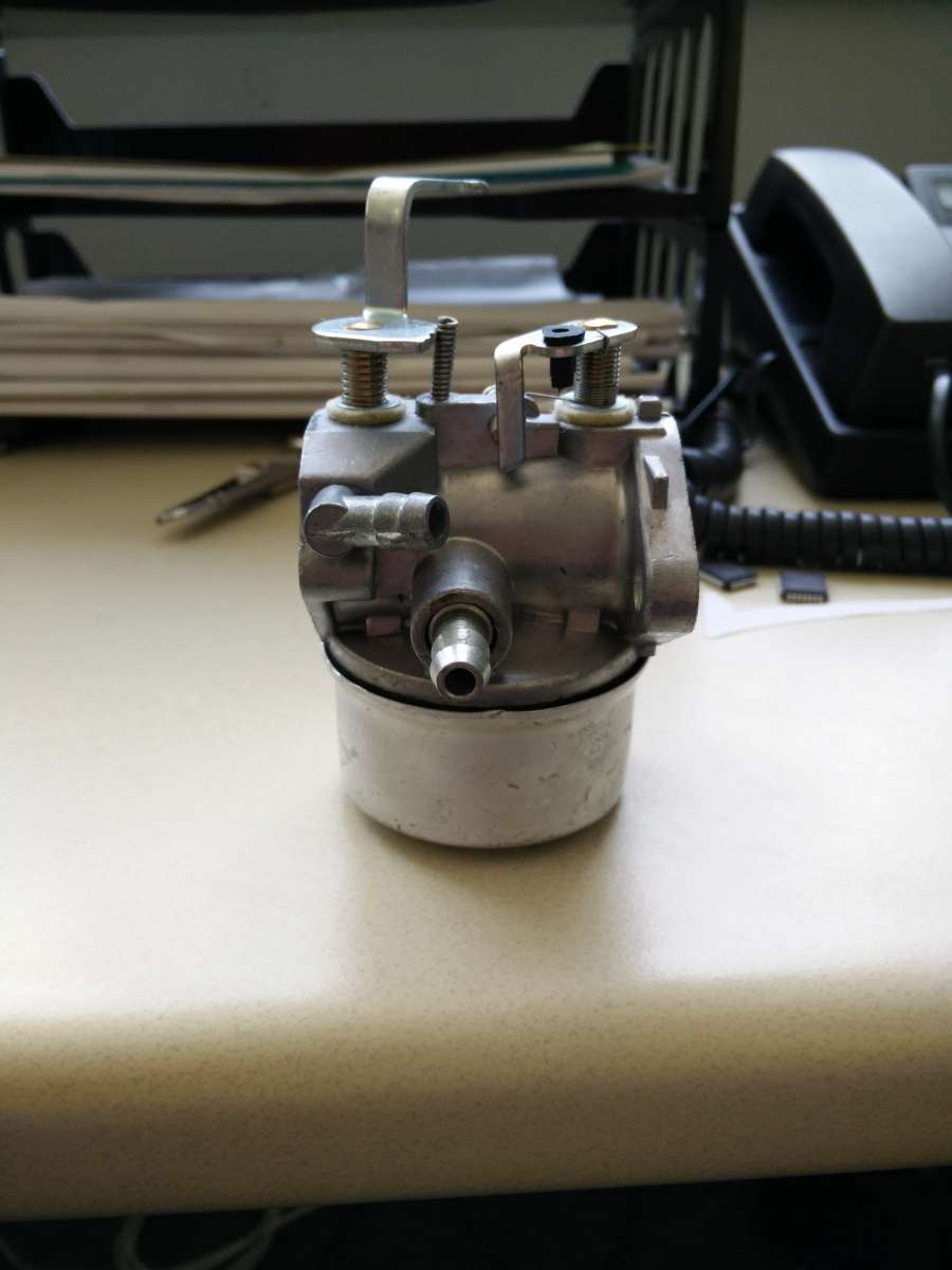

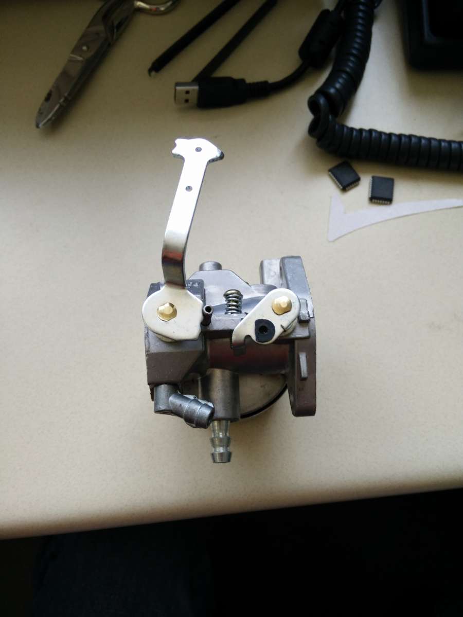

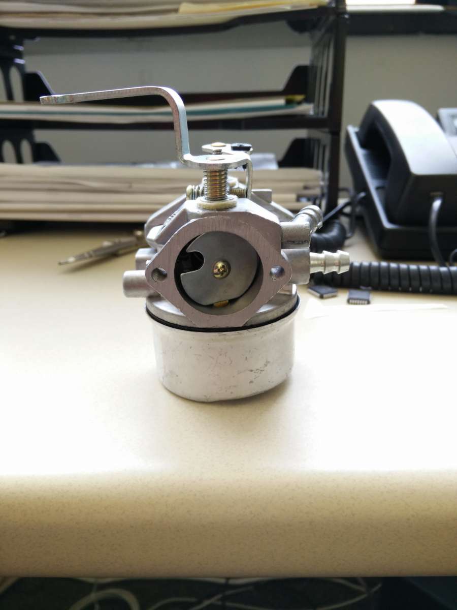

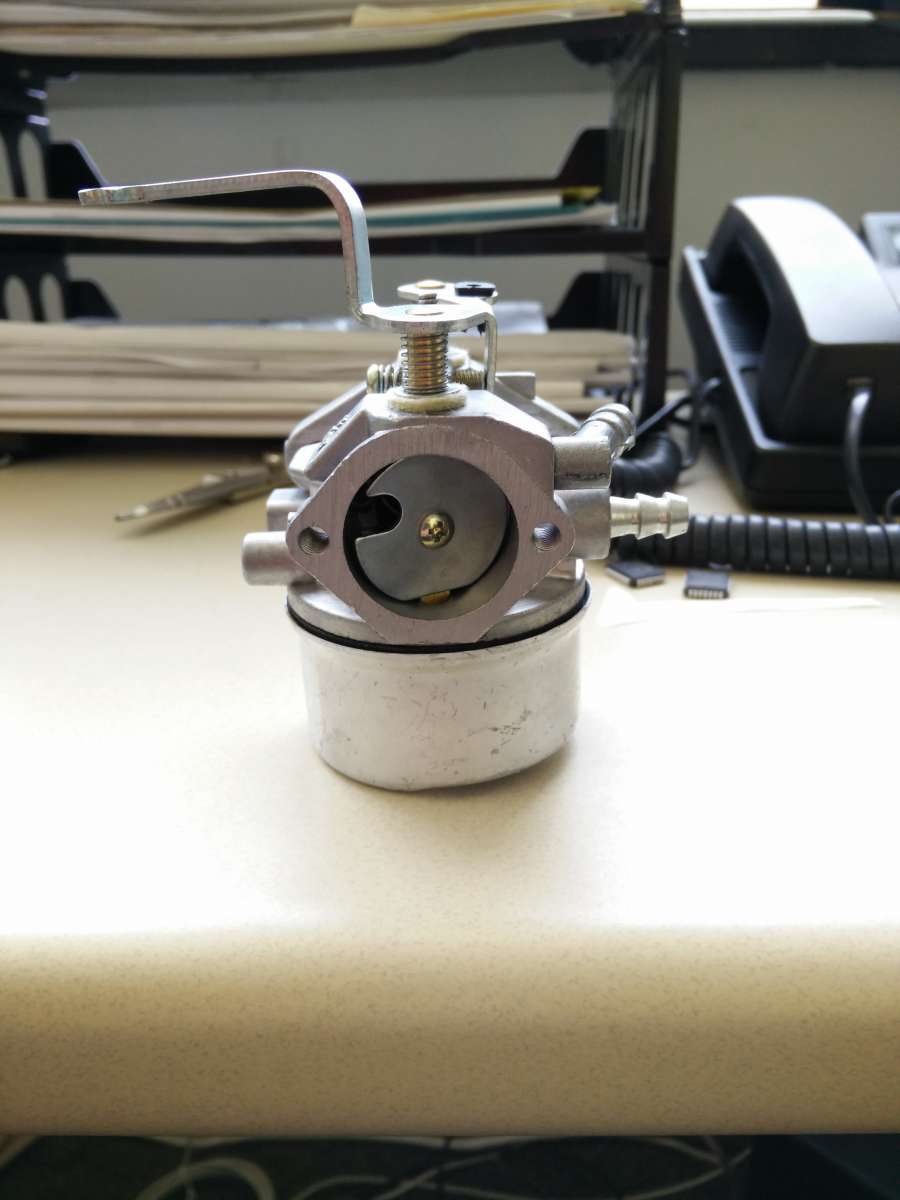

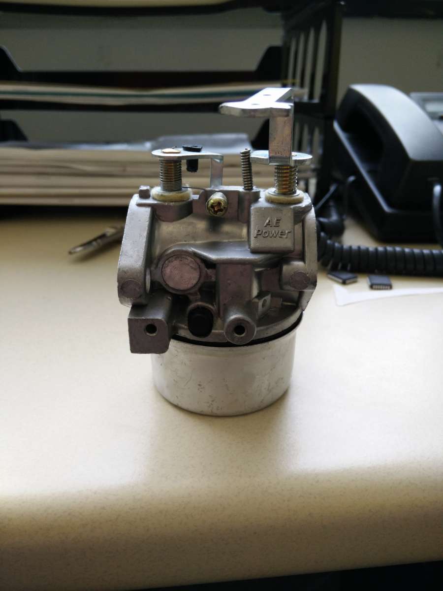

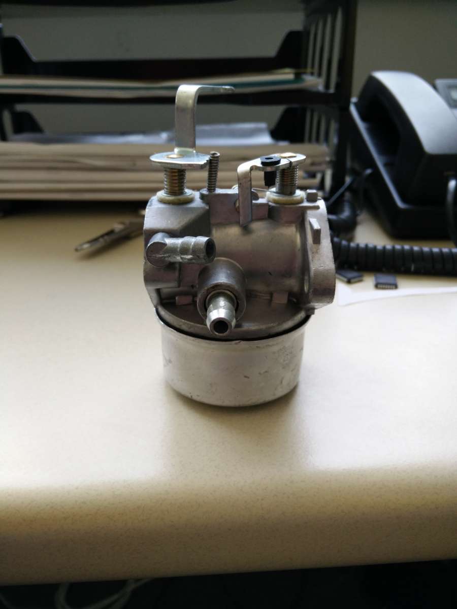

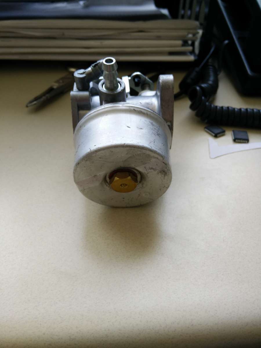

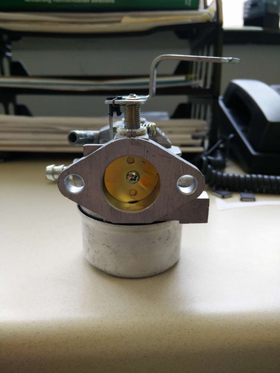

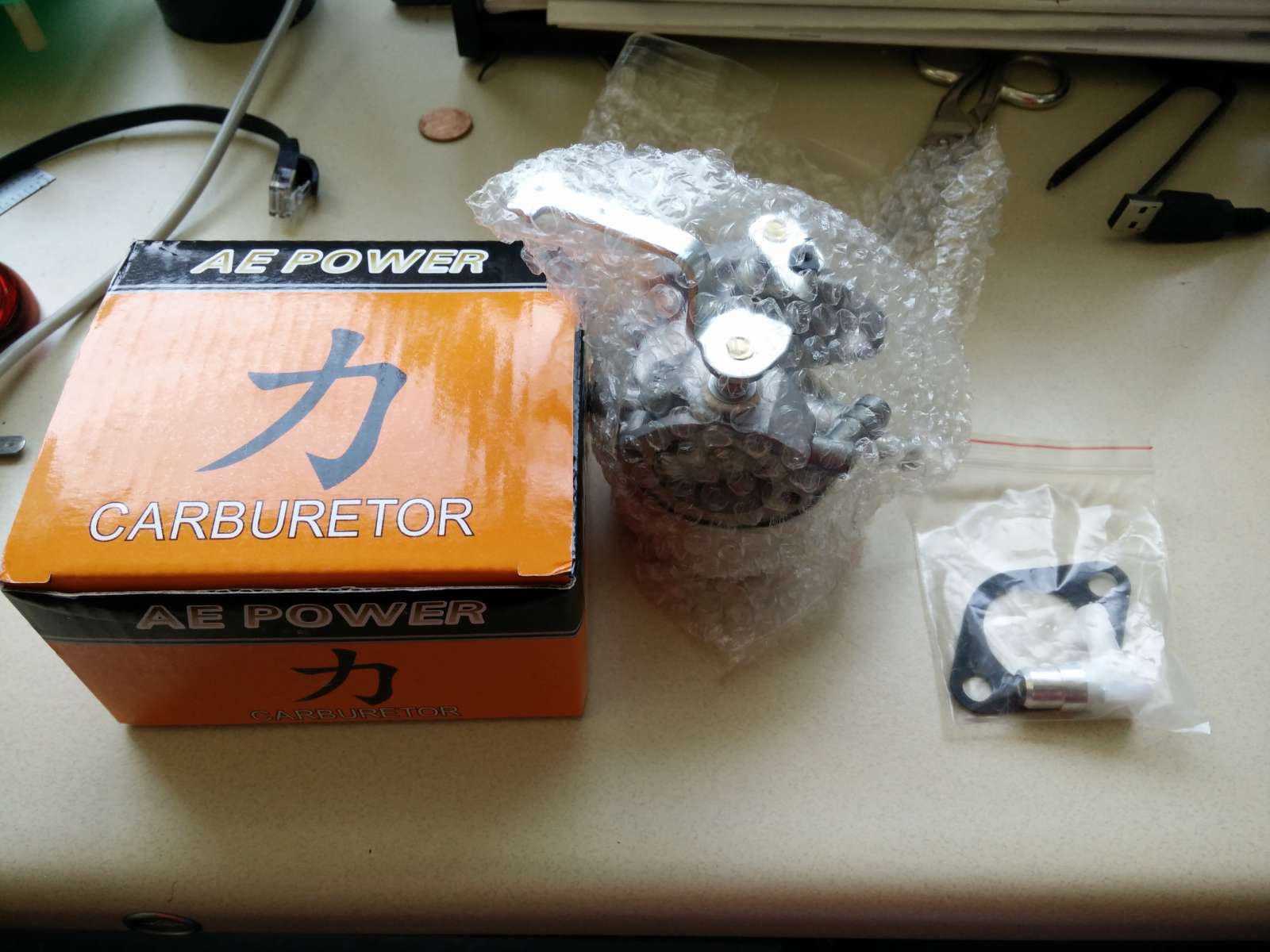

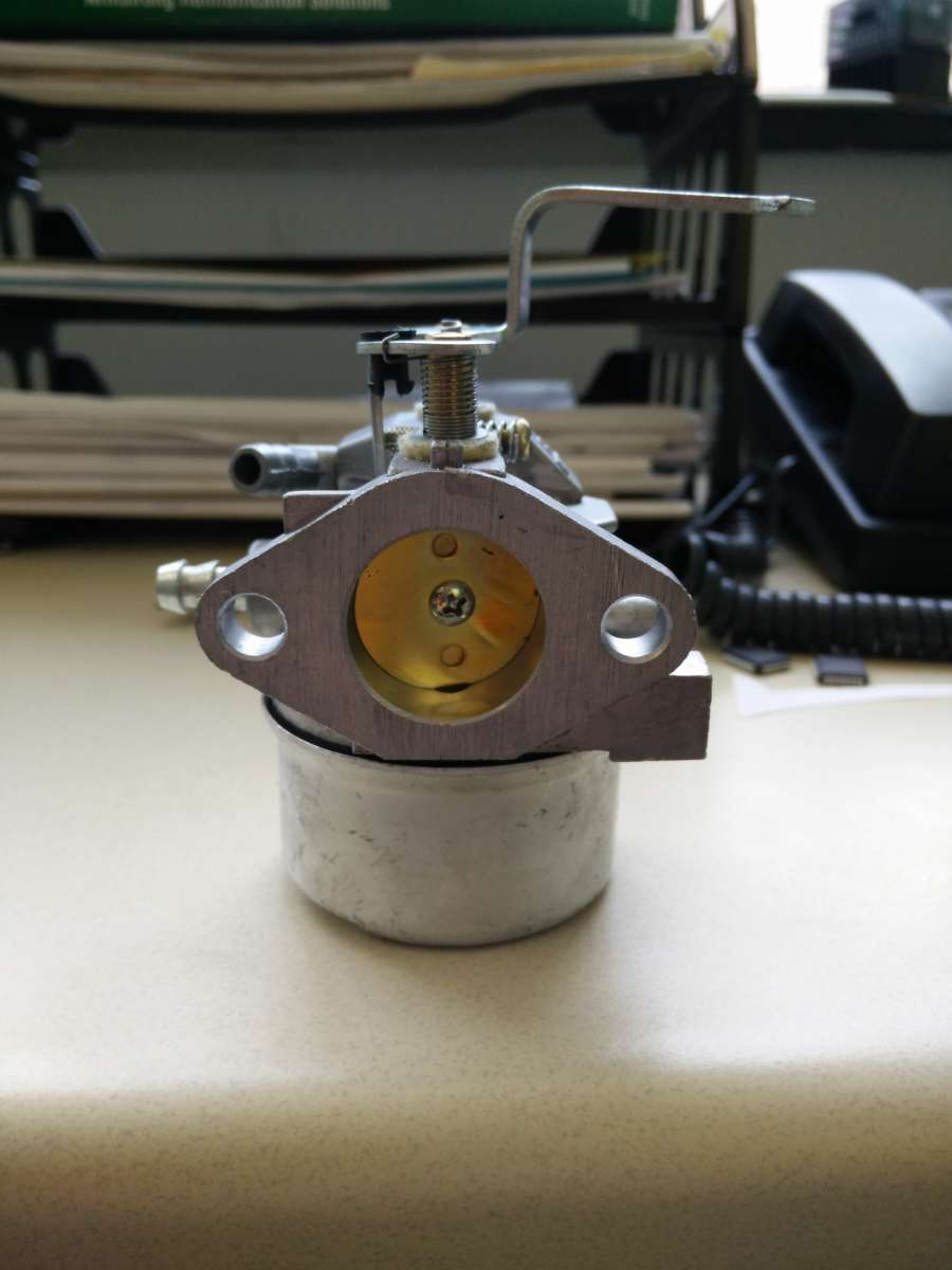

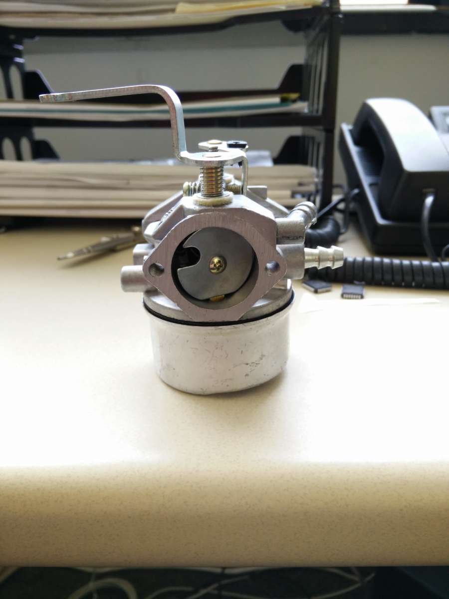

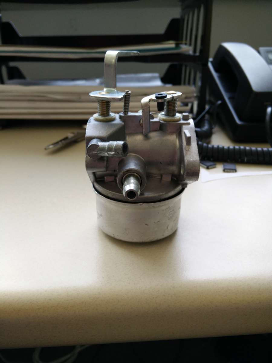

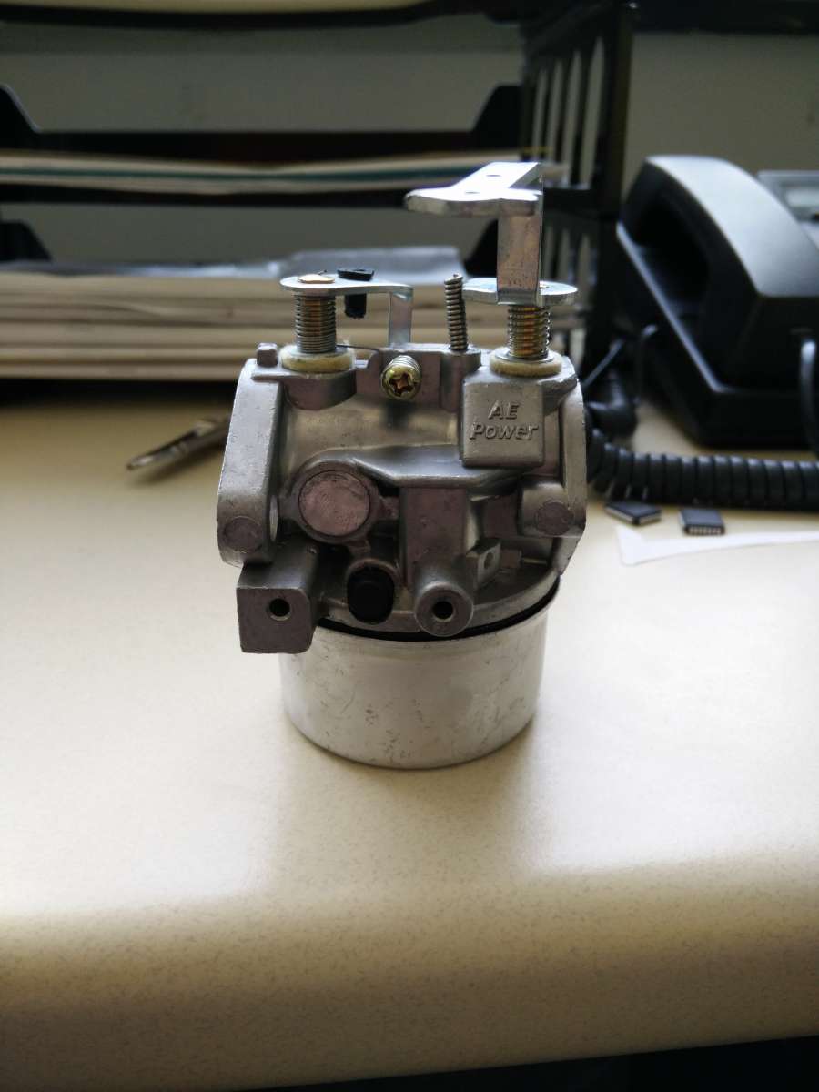

Here are the pictures of the new techy carbs I bought. They can be found here
www.ebay.com/itm/NEW-TECUMSEH-TROY-BILT-...&hash=item5b12c7c715
First thing I noticed is there is no adjustment screws like the originals??? :confused1

Don't know about that AJ.
I do know if there were a Techy carb that never needed adjustment I would think I had died and went to Heaven. :laughing

04 Jun 2015 12:24 #5334 by JustinW.73
Replied by JustinW.73 on topic New Techy carbs
Ya looks to me like those are the wrong ones. Those are the newer style that are non adjustable (obviously). Those look like ones that are for the snowblowers that had techys on. You need one like this:http://www.ebay.com/itm/Carburetor-Tecumseh-632334-632334A-Craftsman-HM70-HM80-HMSK80-Adjustable-Carb-/281588201440?pt=LH_DefaultDomain_0&hash=item418ff6f7e0
But, what engine do you have? All I need is model #'s. If its a HM70 HM80 or HMSK80 then it will work. If its not one of those then give me the model. I don't need serial.

04 Jun 2015 13:38 #5338 by M Bailey
Replied by M Bailey on topic New Techy carbs
AJ that is not the one originally listed. That looks like a CARB (California Air Resource Board) compliant carburetor required by the state of Kalifornia. Try one out and if they don't work as expected let me know and I'll take them off your hands, I need a couple of carbs for my DR Trimmer and chipper which those would be well suited for.

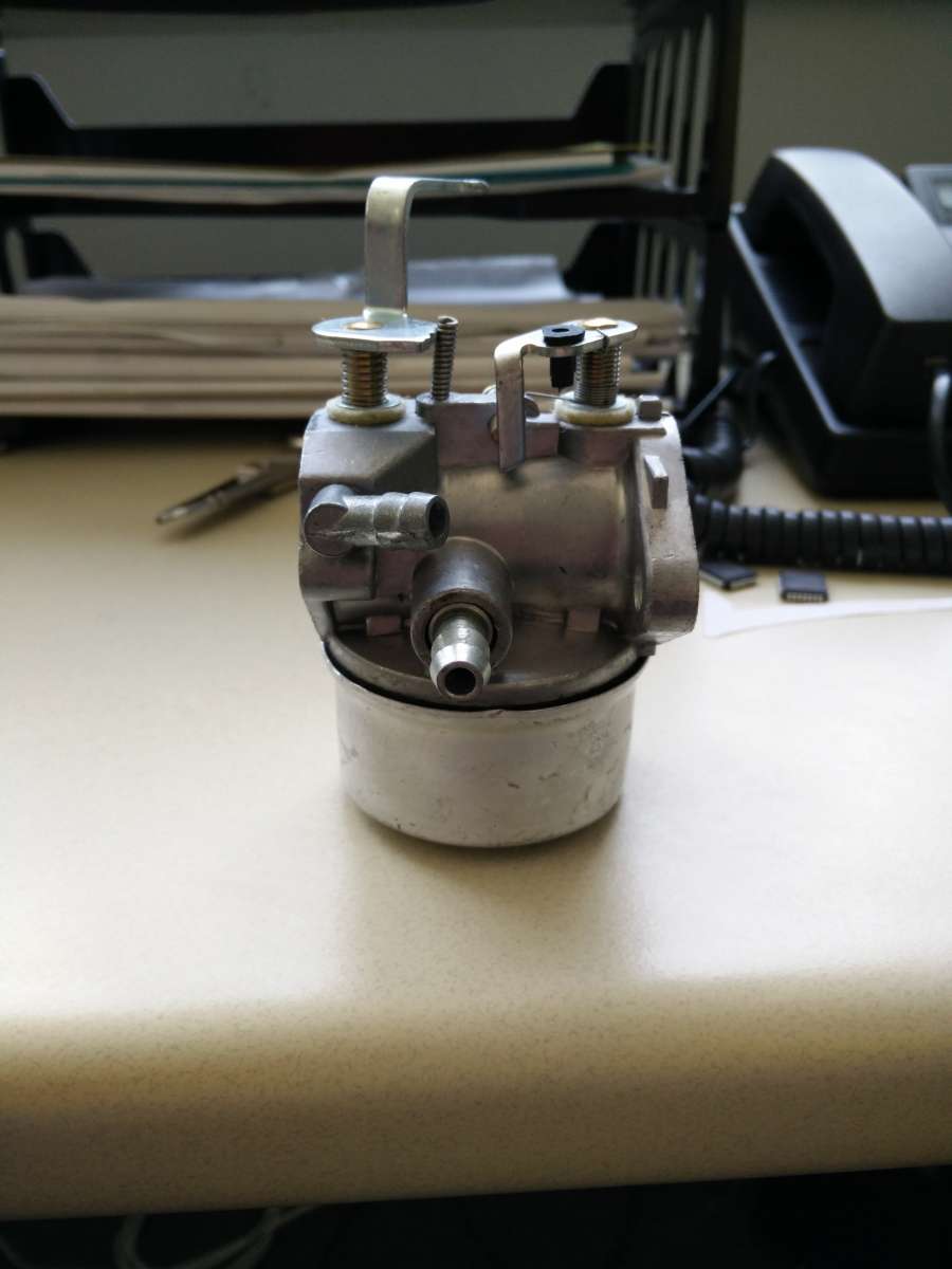

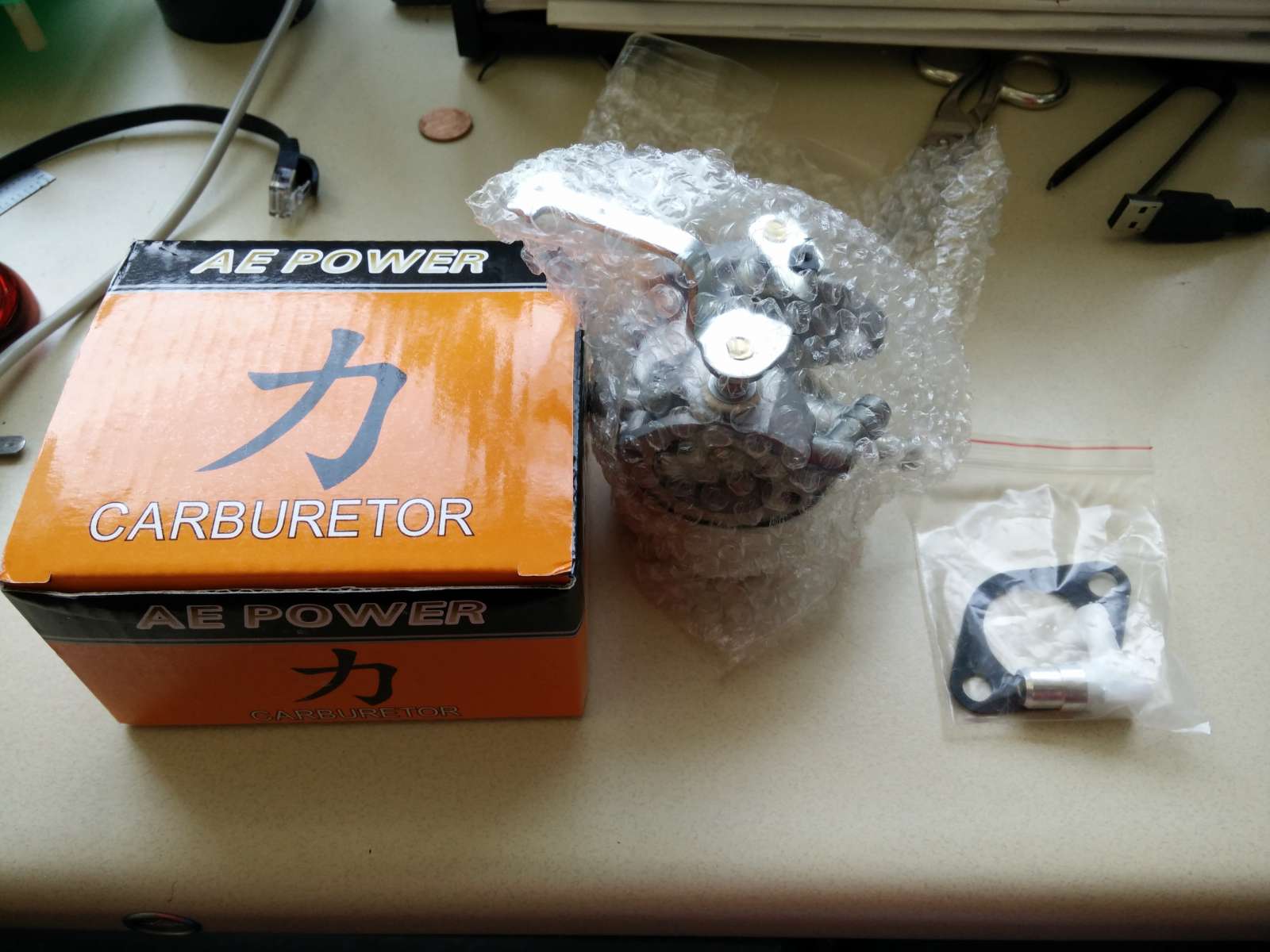

05 Jun 2015 08:41 #5360 by AJ WH Ranger
Replied by AJ WH Ranger on topic New Techy carbs
Well instead of going fishing last night, I decided I better throw on one of those carbs so I could mow my hay field. Haven't been home in like 2 weeks. Its getting very long.
Those didn't work for me. :angry :angry2 Should have went fishing.
You guys think these are the right ones?
www.ebay.com/itm/Carburetor-W-GASKE-for-...3D391157106453&rt=nc
05 Jun 2015 10:43 #5376 by JustinW.73
What's the model number on your old carb. And did it use an external primer
