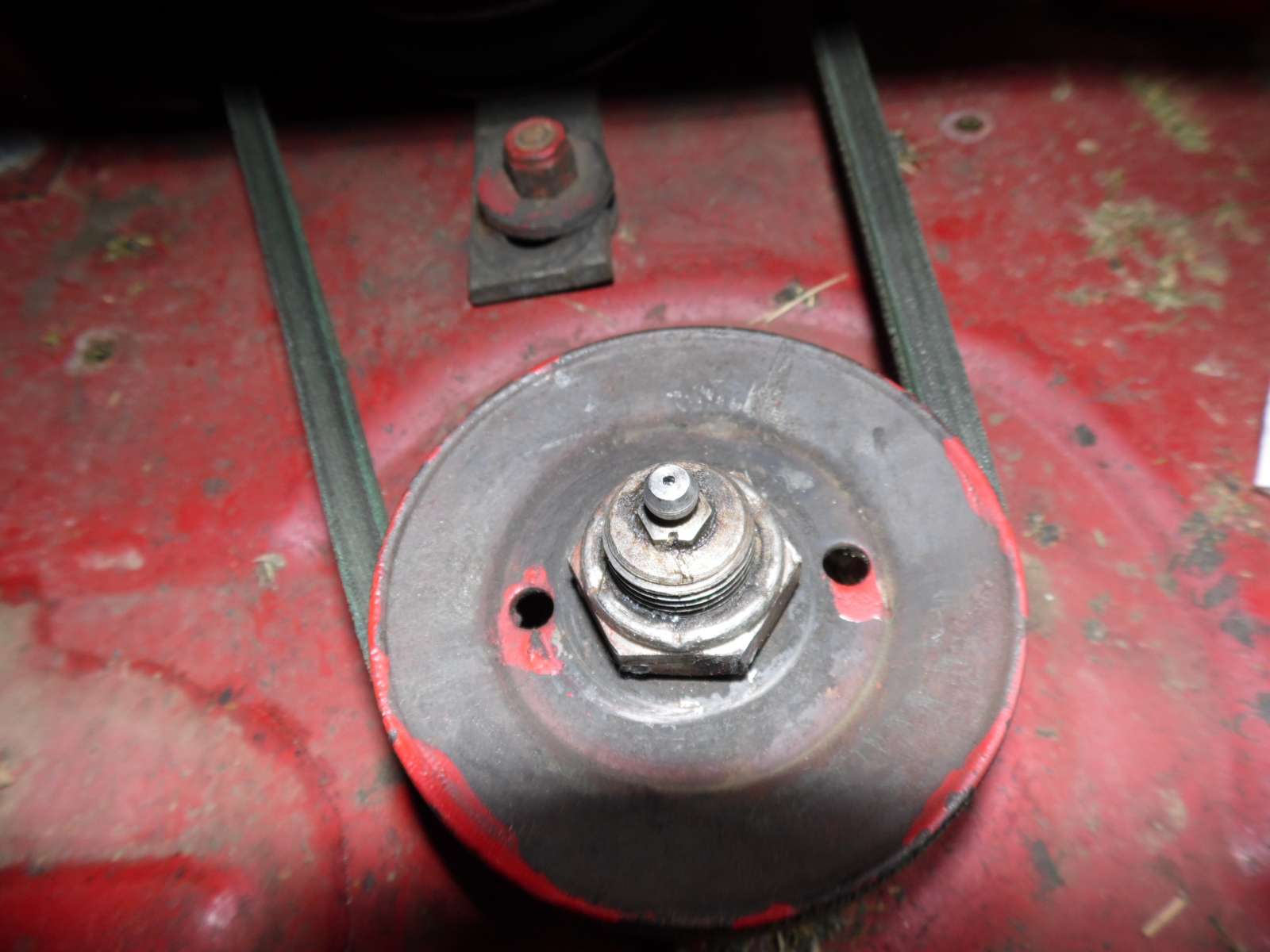

Kurt I don't own a 48" deck but see that they don't have a separate top seal like my 42" decks do. If the grease hole on your spindle shaft exits below the top bearing I'd just pull the inboard seals and grease them as usual. Take a look at your grease zerks and see if they have a slot cut in the side of them to relieve pressure and help prevent blowing the seal like the one below.

That looks exactly like my spindle Major. A slot makes some sense to me. When I rebuilt my finishing mower several years ago, it had a weep hole at the bottom of the housing that did exactly like your slot. I'll check it out when I get this apart
