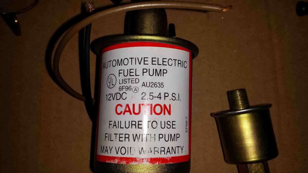

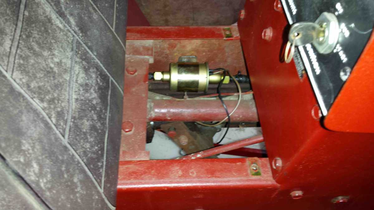

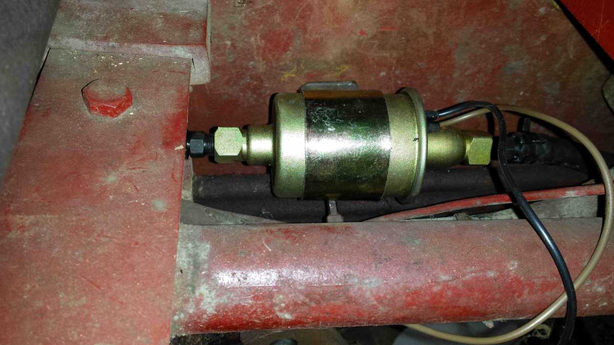

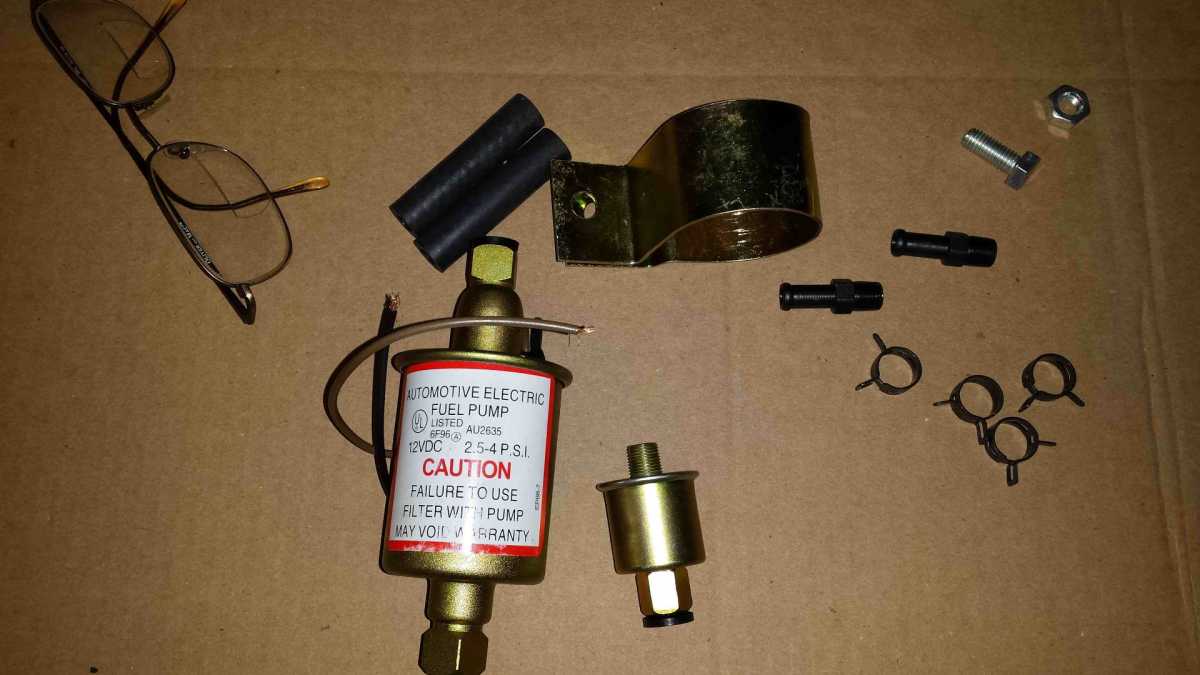

The D series has a vacuum pump that sometimes takes a while to get fuel to the engine after the tractor sits a while.. Always wanted to try an electric one....got one for a little over 15 bucks off ebay. They are bigger than I thought....kinda hard to find a good spot for them. Still have to wire it and add a new filter after the tank/before the pump. I did install a filter before the carb....a small one.

Really nice job Bob, looks like the prefect spot too. :thumb1
Does that tractor have an oil pressure switch or a place to put one?
