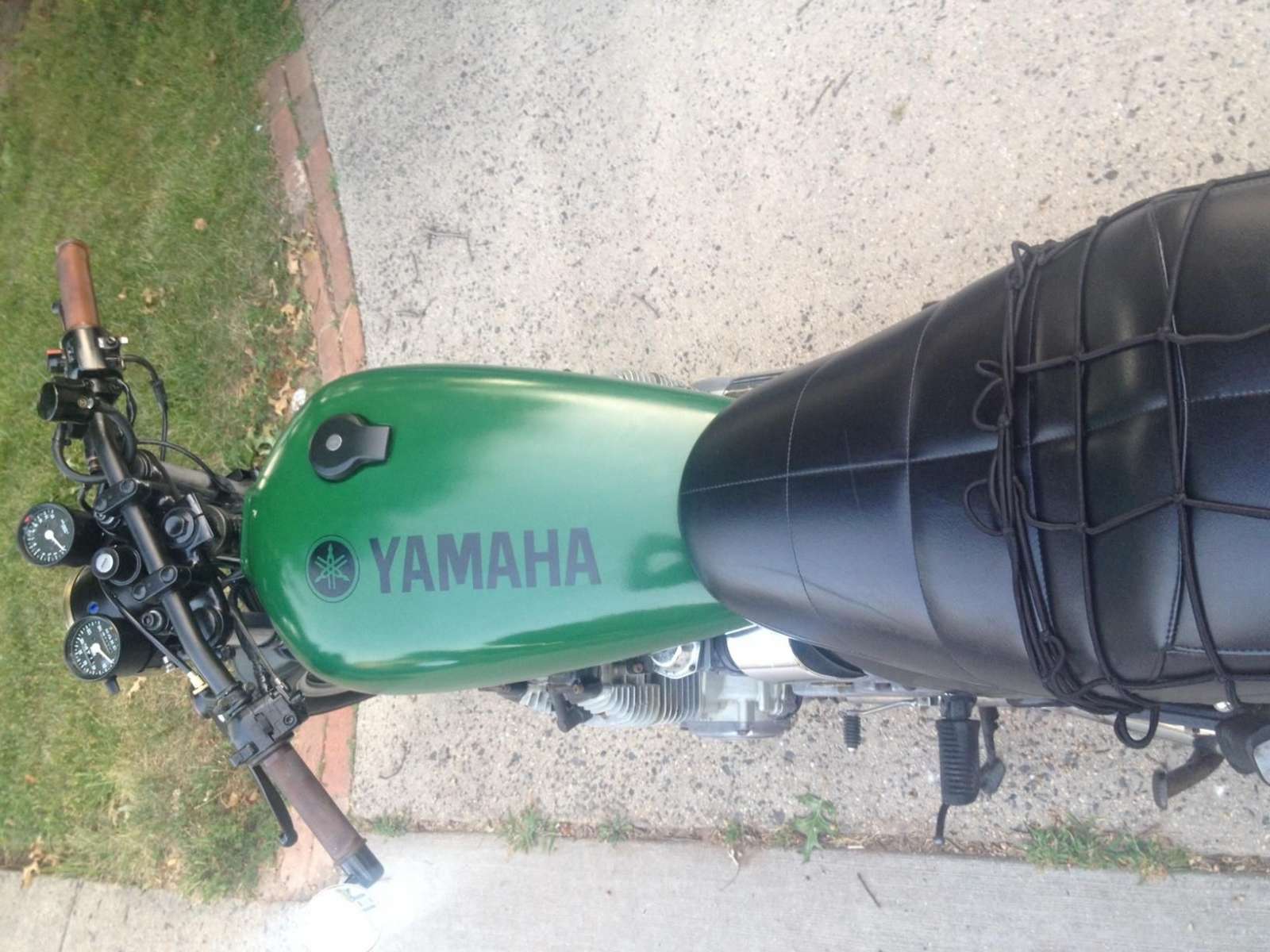

25 May 2015 06:14 - 25 May 2015 06:20 #4871 by Trouty56
Replied by Trouty56 on topic Clearcoat application
I keep reading about this stuff....guys use it a lot in the bike forums to coat gas tanks.....and use it over all types of paints.....Rustoleum, Valspar, Duplicolor....say wait a week....use precautions though like a full mask and paper suit.....this stuff can harden in the lungs....get into skin/eyes.......fuel protective coating is why they use it for tanks.....
This is over rustoleum......can't get the image to tag.....arggghhhh.......OK....I'll upload it then.....
Last edit: 25 May 2015 06:20 by Trouty56.
25 May 2015 07:09 #4873 by Trouty56
Also.....I received this from the guy who is doing the D series resto....the pic in the first post.......
I actually talked to the Rustoleum rep and was told the cure time for Rustoleum rattle can paint is 72 hours. I waited twice that long, and then used 2K Spraymax and it is KILLER!!
I have prior contact with him....he bought some lug bolts from me for his build months ago......
Geno....maybe the Germans figured out how to make this stuff work with all base coats.....IDK....but folks are using it.....
25 May 2015 08:06 #4875 by Geno
Replied by Geno on topic Clearcoat application
You never know, technology is changing every day with this stuff. Longer term results will tell if it will actually last. :)
