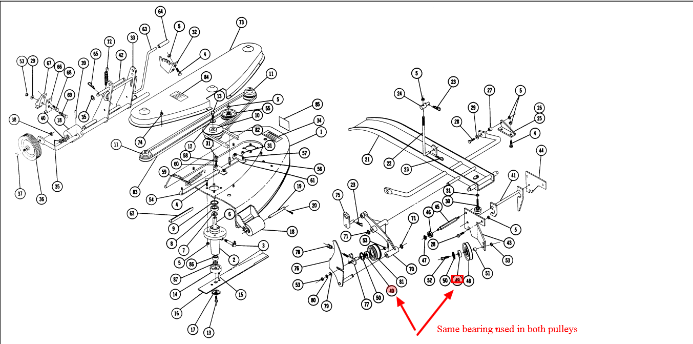

14 Sep 2016 17:00 - 14 Sep 2016 17:00 #12376 by Geno
Replied by Geno on topic 1056 mower deck issue
I'm getting there. Found a part number but the few people I called that show it in stock on the websites actually don't have them in stock. They are a weird thing. I have a few of them NOS but they would be pricey, the Toro made in China one was around $50-55 plus shipping most everywhere. I'm still on it but with everyone closing up here shortly I may have to pick this back up tomorrow.
I believe the deck is an RL-426, made in 66 for the 1056 tractor. Here's a diagram -
Last edit: 14 Sep 2016 17:00 by Geno.

15 Sep 2016 08:52 #12378 by Geno
I've checked everywhere, bearing places including Pacamor who made this bearing and no longer does, parts houses, Fastenal, you name it and no one has it. The biggest problem is the 3/8 id. I've also check several I have in the shop and they are all either locked up or tight.
Good news is I do have a few NOS parts . :)
