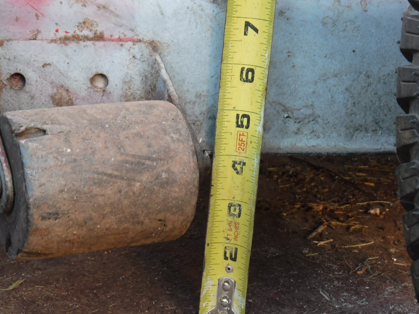

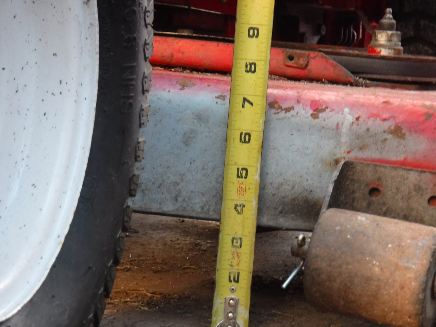

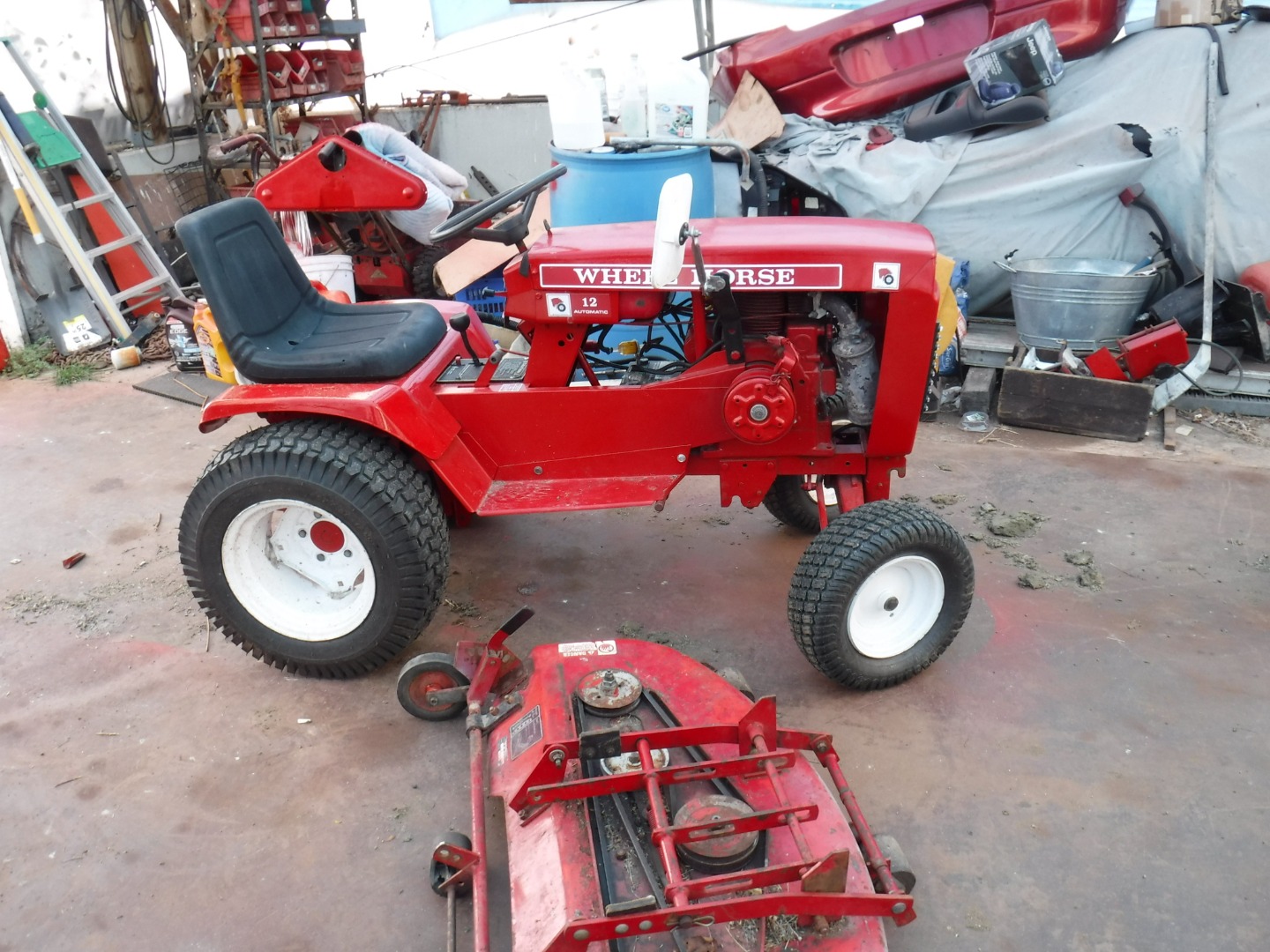

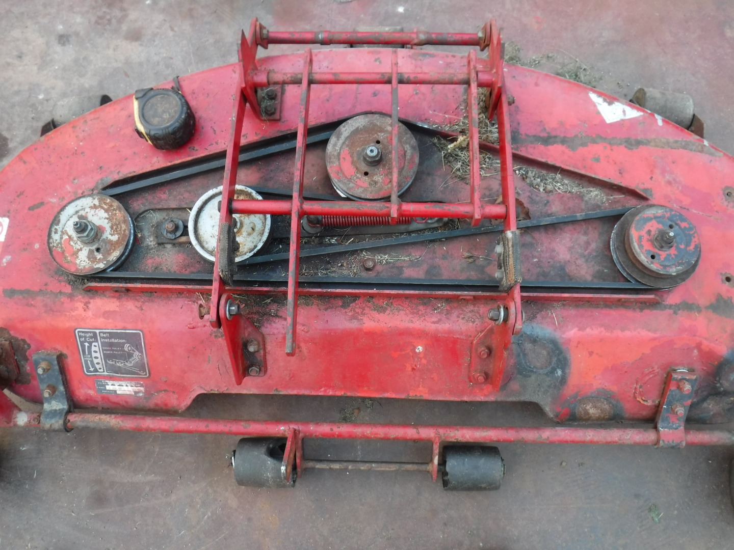

08 Oct 2020 17:43 #16413 by Guy
Replied by Guy on topic level 48 inch mower side to side
So here are some pics you will see on the left mower front is higher that is on the right side siting on the horse
08 Oct 2020 17:48 #16414 by Geno
Replied by Geno on topic level 48 inch mower side to side
Is it just the view or is the front antiscalp wheel mount and deck bent in on the left facing it?

09 Oct 2020 06:37 #16418 by Guy
It is just the view

09 Oct 2020 10:48 #16419 by JustinW.73
Replied by JustinW.73 on topic level 48 inch mower side to side
Looks like the mount on the crossbar is lower on the right than the left.
