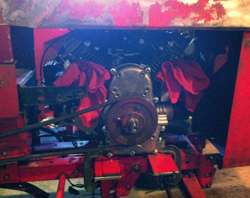

Some progress
Drive bushing installed and pulley mounted.
Motor mounts made.

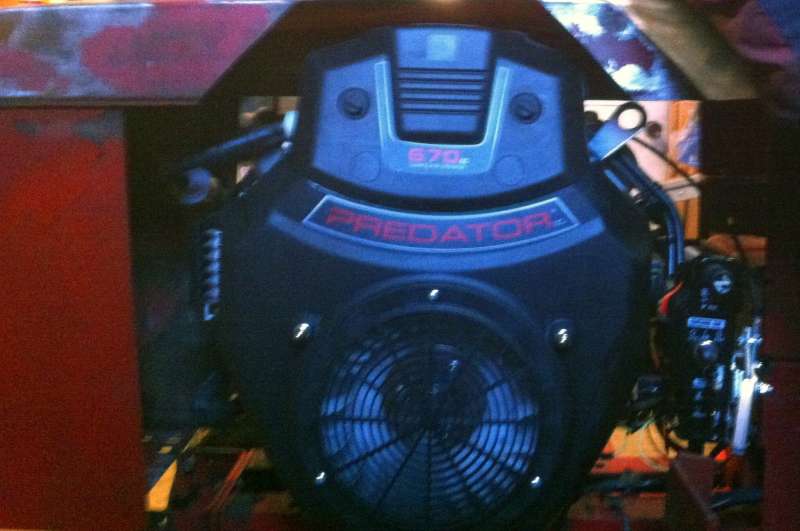

Test fit for engine position.

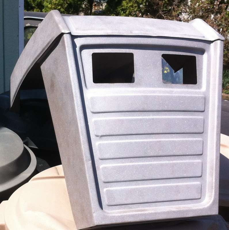

Test fit for hood.
Lots of room to work with.
The hood will be repaired (previous owner made this cutout for the Kohler)

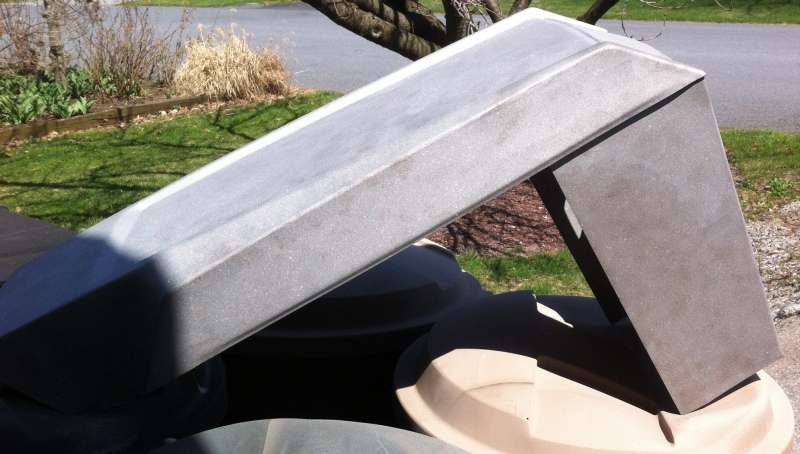

14 Apr 2015 06:34 #3219 by GT 14
Got some blasting done. :guns1
