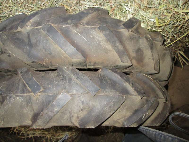

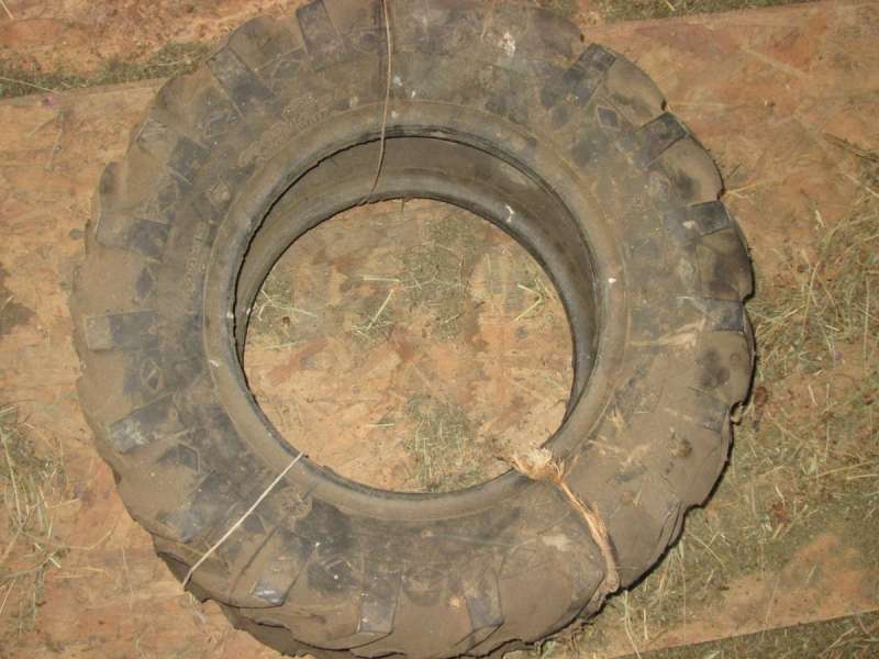

question for all of you to vote on i am able to get the following tires for the stock rims on my 654
will the 6 x 12 rims take these 5.00 x12 tires and still work and work good
i do have tubes to use if needed
i am waiting on a overall height measurement on the tire.
PO said they were never mounted
looks like a good bath would give me brand new correct period tires if they fit
04 Apr 2015 21:45 #2651 by Geno
Replied by Geno on topic 5.00 x 12 Goodyear Sure Grip Tire
They should work fine John. They will be 5" wide instead of the original 6" wide, and sometimes the narrower tires are a little tough to get aired up. :)
