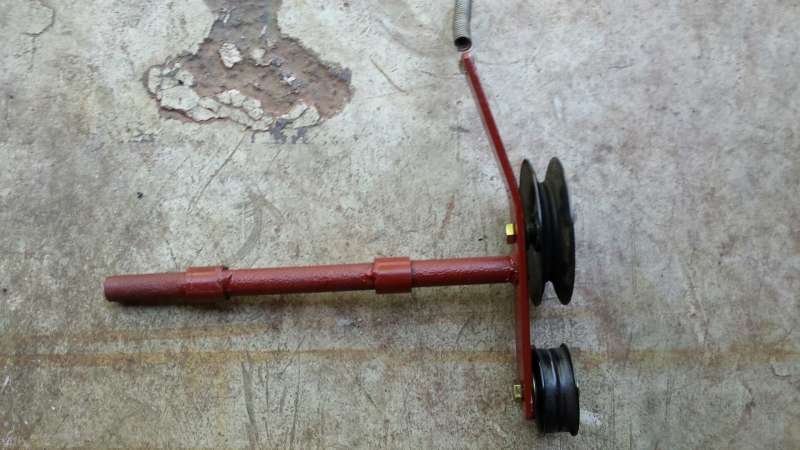

Talked to Geno today...I was getting ready to start making an idler for the tiller....I need it completed yet.... Geno sent some pics for me to look at. I kinda knew what I was going to try but the pictures helped confirm some of my ideas.....
items I started with....had everything I needed....GT...you would be proud......
1 piece of flat steel.....3/16 X 1 1/4 X 10 inches (might have been 1 1/2 inches wide)
1 flat idler pulley 2 1/2" diameter
1 V idler pulley 4" diameter
1 piece of 3/4 " round stock cut to about 12"
3/8 X 1 1/2 inch bolts and nuts (might have been 1 1/4 length)
some 1 inch pipe 3/4" ID (stops for mid attach....)
Drilled 3/8" holes at 3/4 inch and 5 1/4 inches.....
Drilled 1/2 inch hole at 4 inches (I don’t hove a 3/4 inch bit so I ground the end of the 3/4 inch round stock to fit the 1/2 inch hole....made a nice valley to weld it)
Drilled 1/4 inch hole 3/4 inch from other side for spring

Nice work Bob, looks just like it should. :thumb1

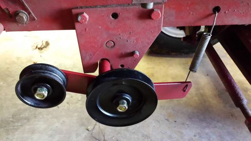

Thanks for the positive responses.....the bend in the flat stock is to line it up with the frame so the spring pulls more directly up..... I threw this old spring on there for now....be getting a better one at TSC when I pick up the belt....
