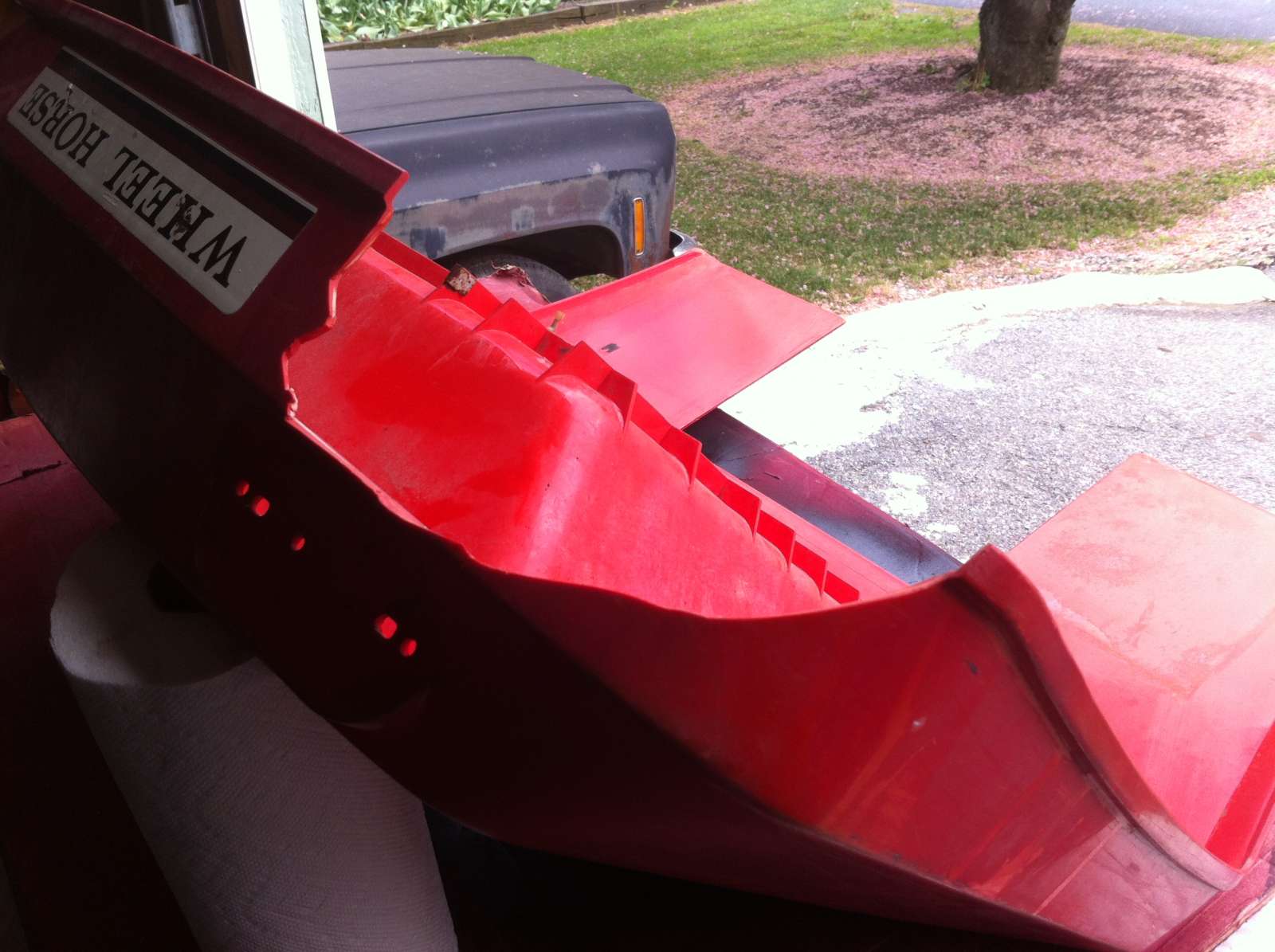

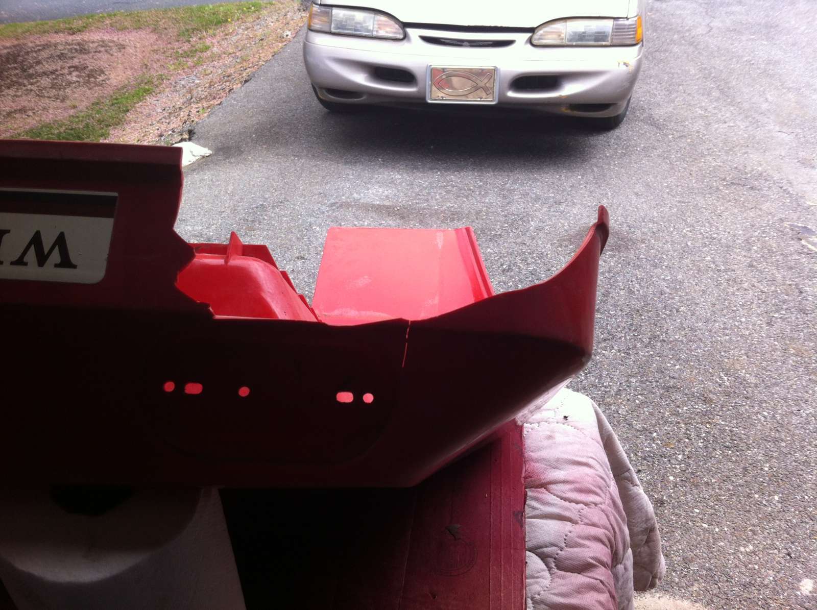

Ok starting to fix this junk fender for the 225
Updates to come.

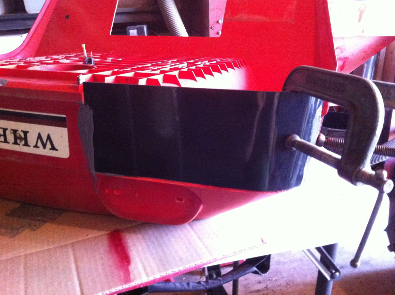

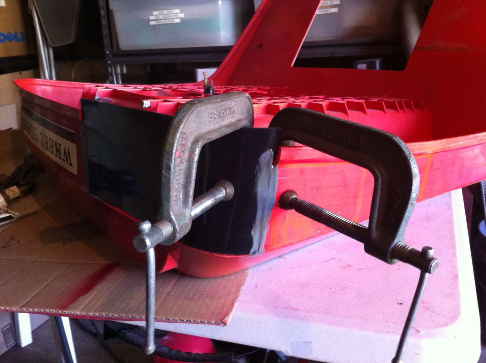

I have a sheet of 1/8 ABS and I am fabricating a patch. I think my trusty JB Weld will handle the job.

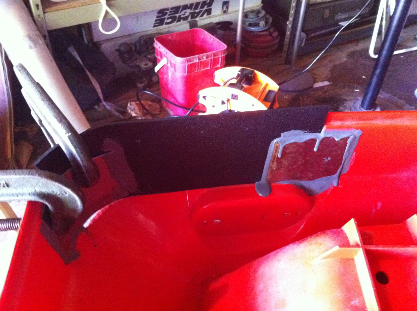

Here we go
Squared up the area, and cut and shaped 1/8" ABS. Used heat gun to get the curve.

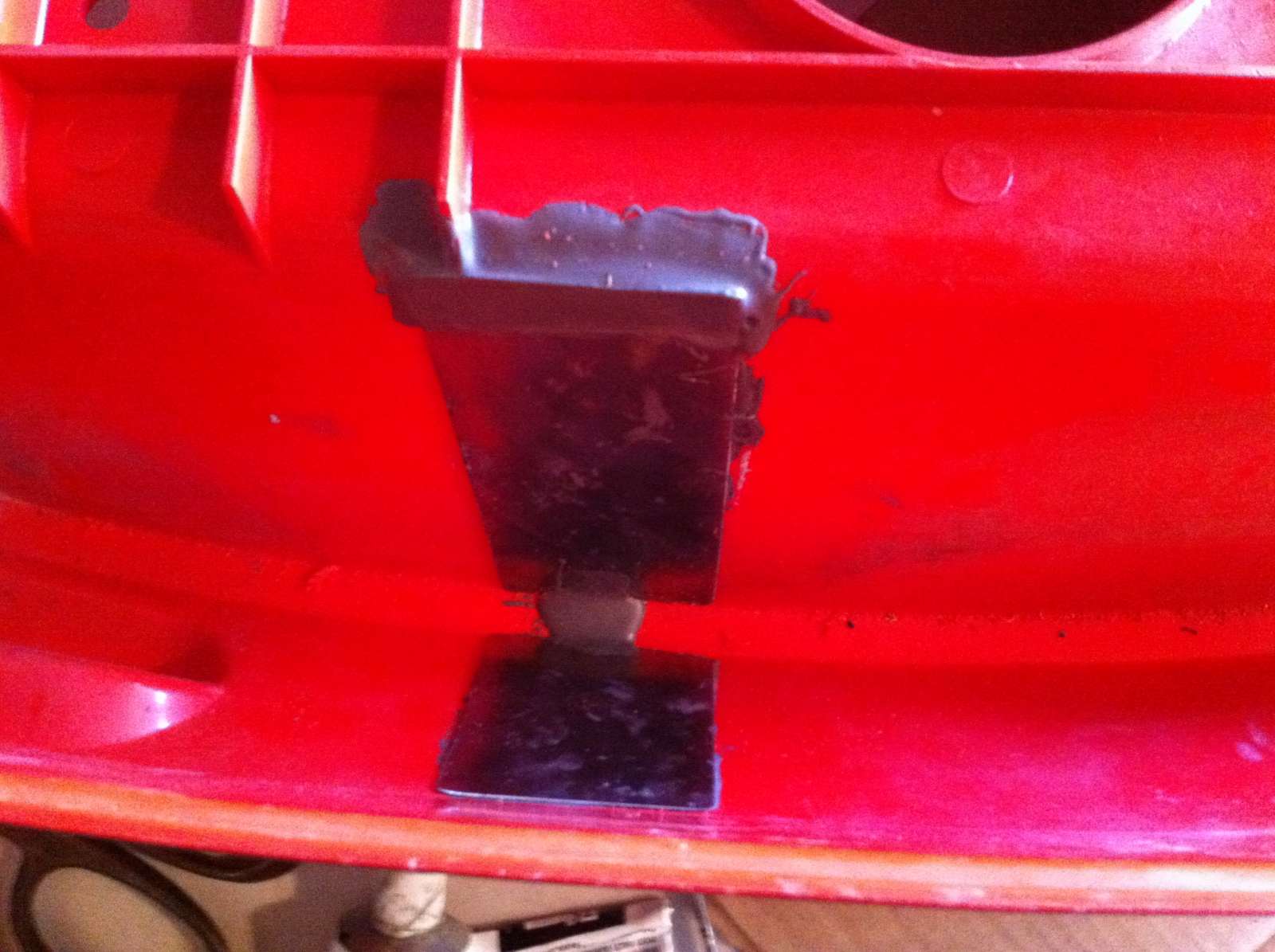

Decided that strength was needed so I am using small squares of sheet metal.
Covered the entire piece of metal with JB and clamped.
Also repaired a large crack down the middle with same process.

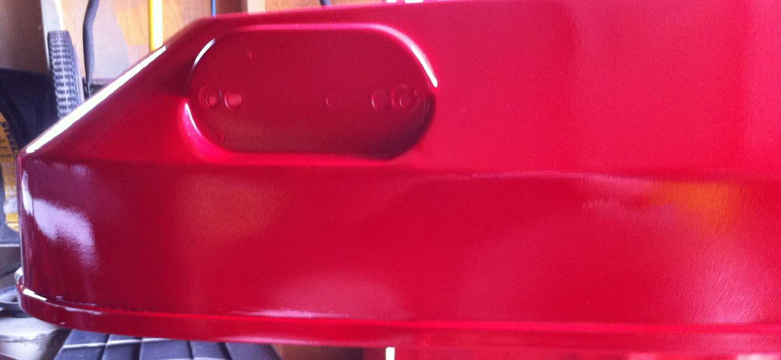

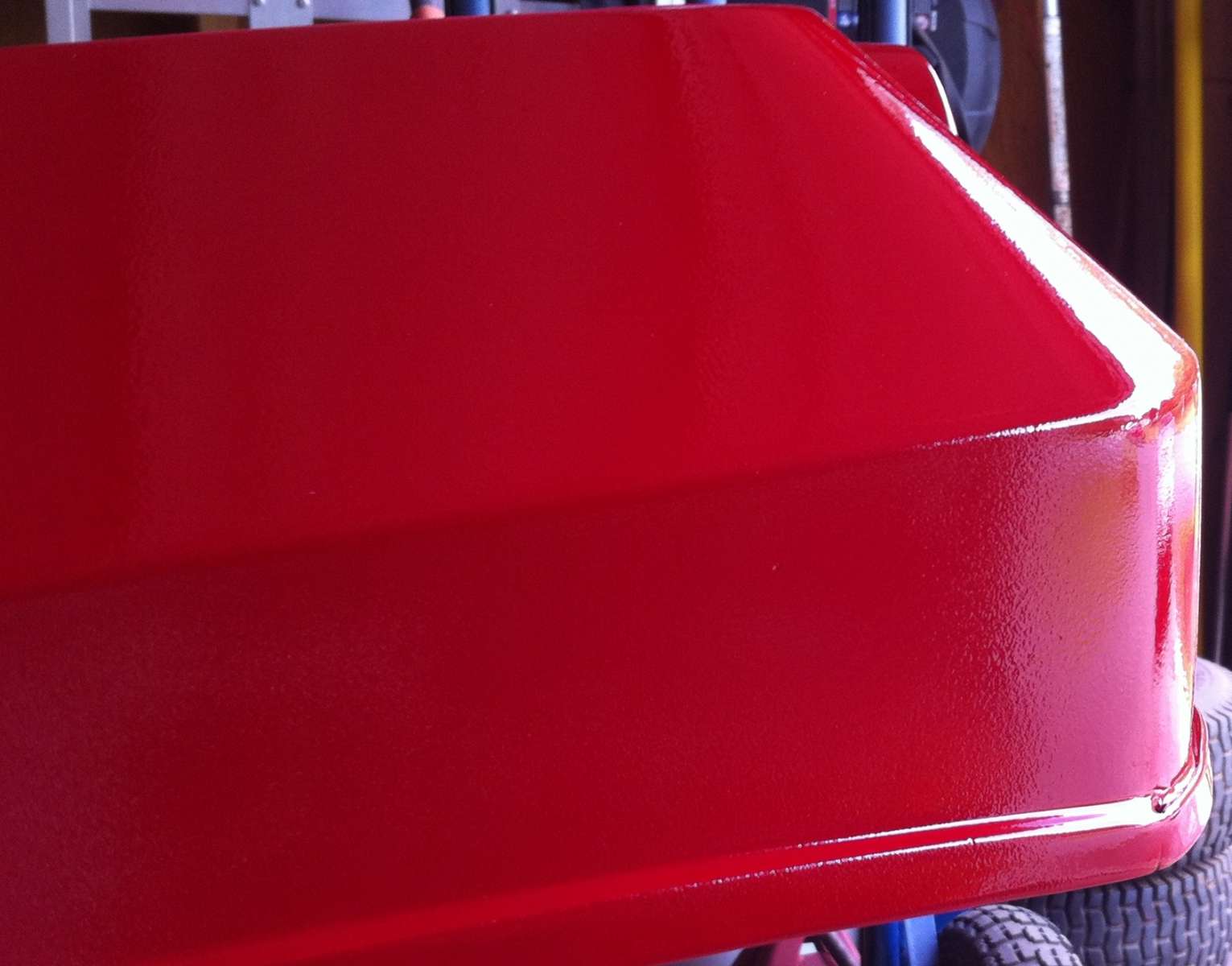

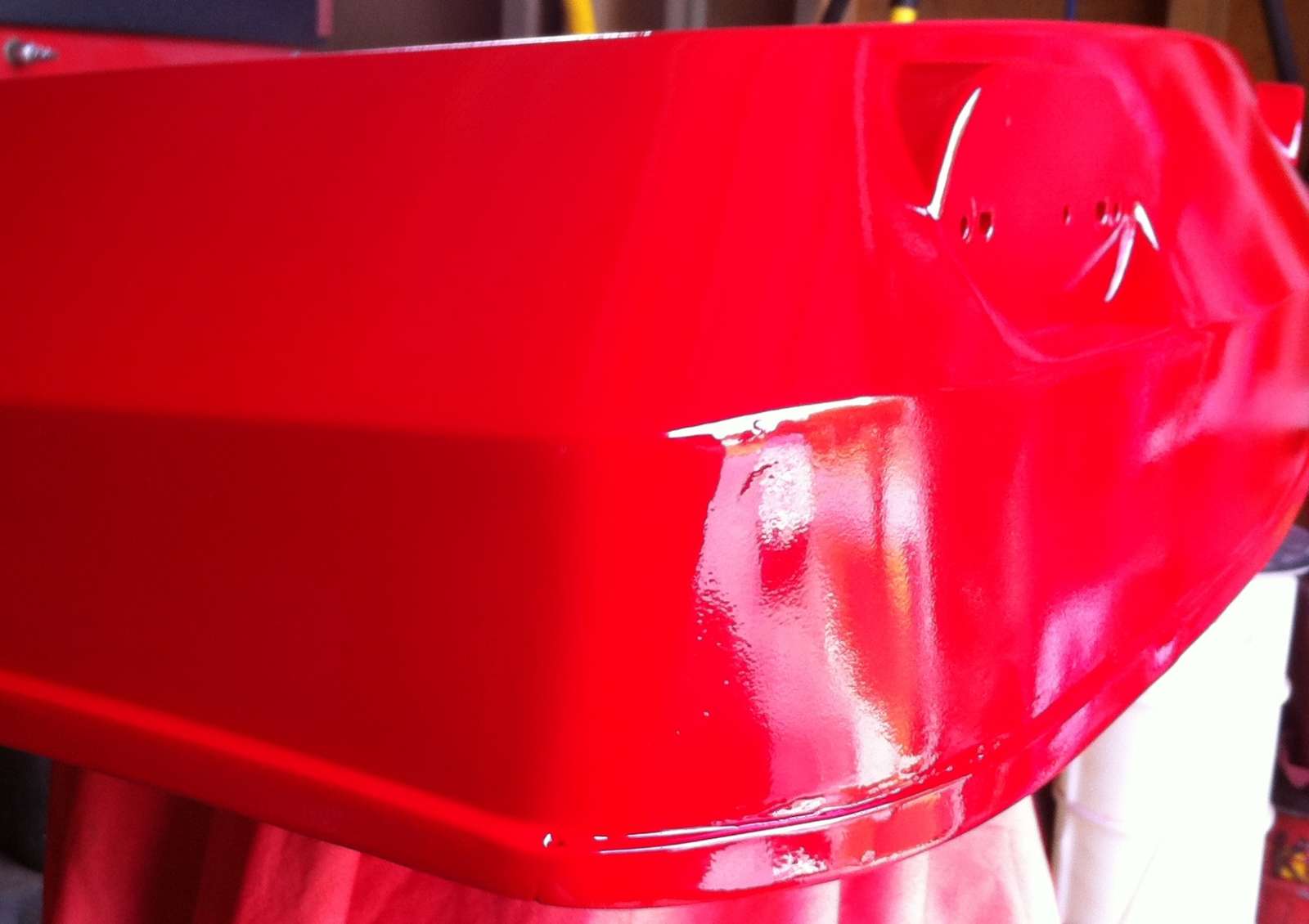

Finally the new fender has emerged!
