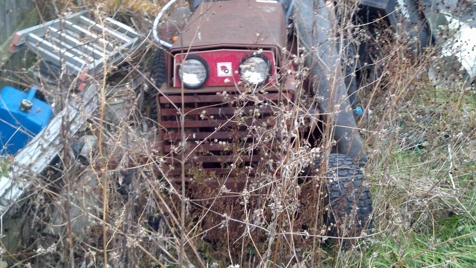

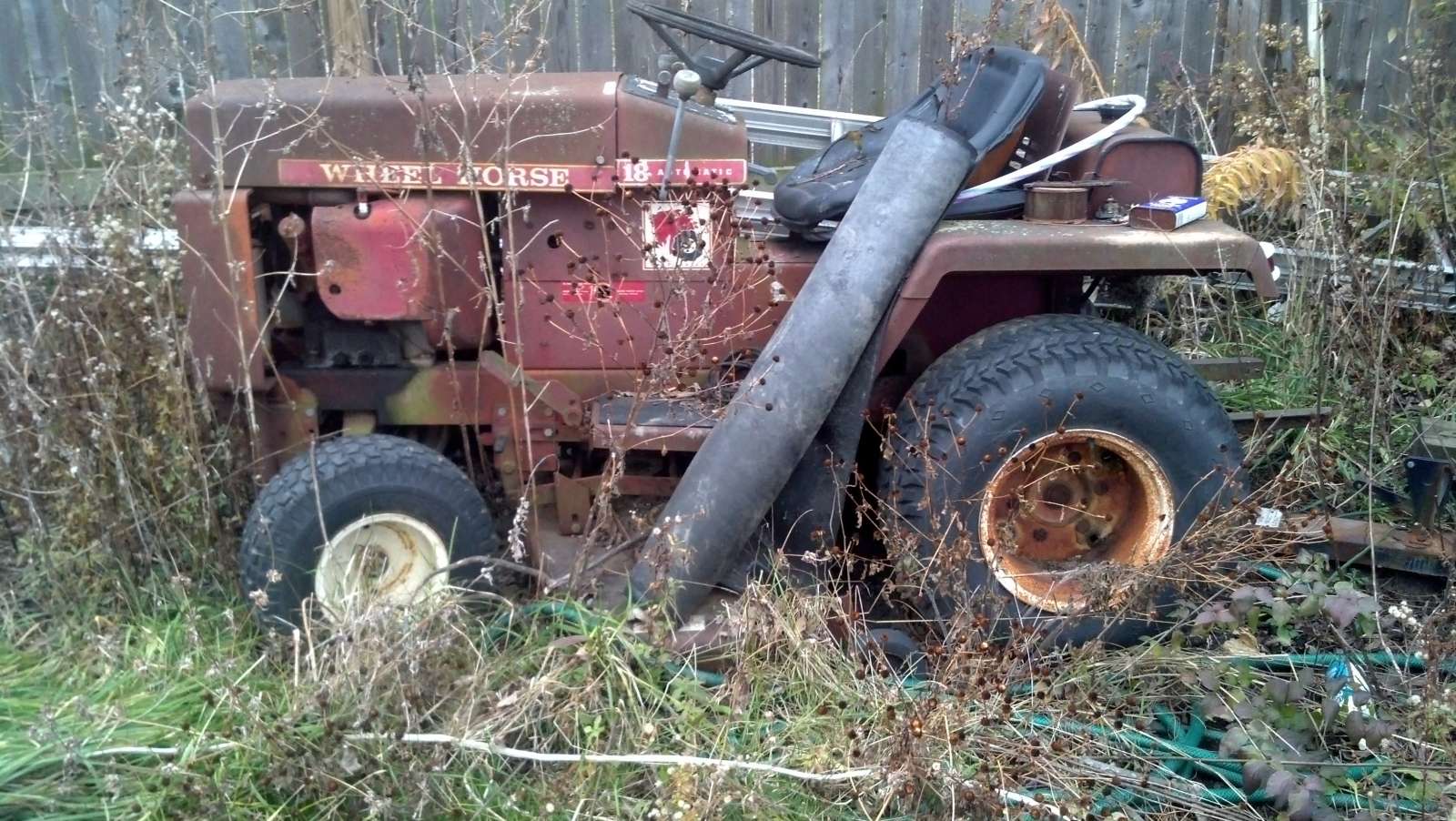

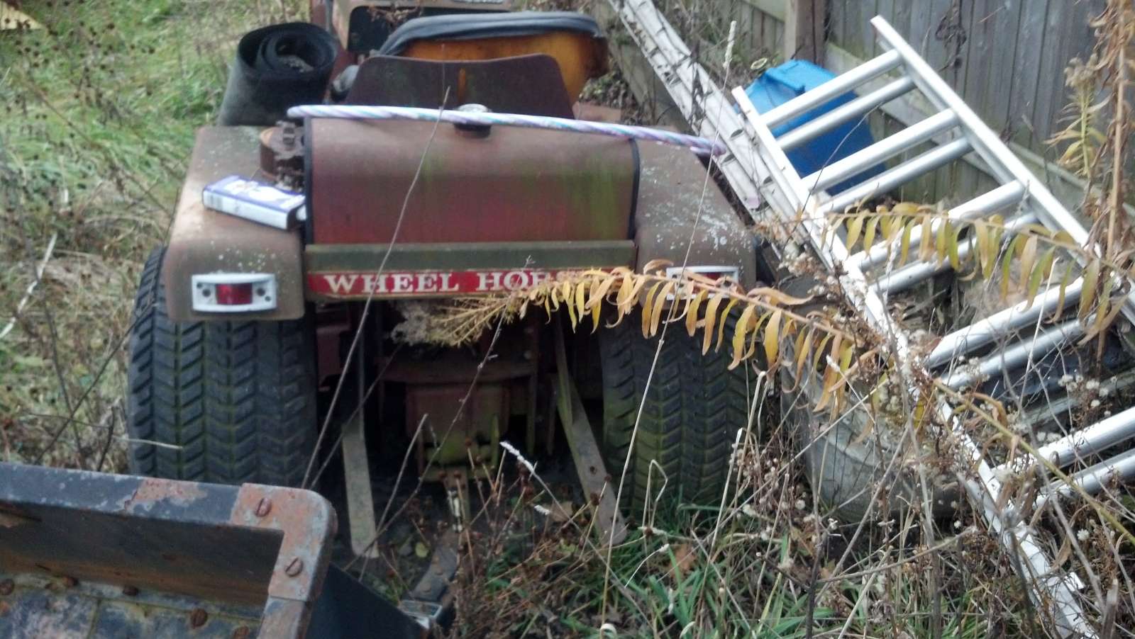

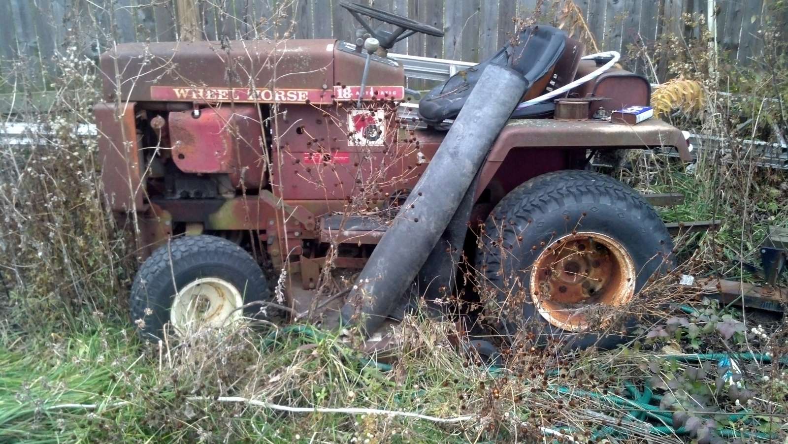

I purchased a non-running, incomplete "Plain Jane" 18 Automatic, for $200.00 in hopes to part it out and realize enough profit to buy my middle son a new laptop.

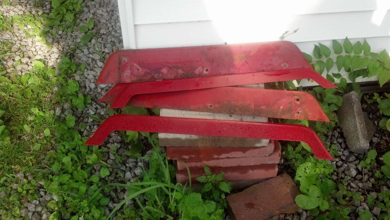

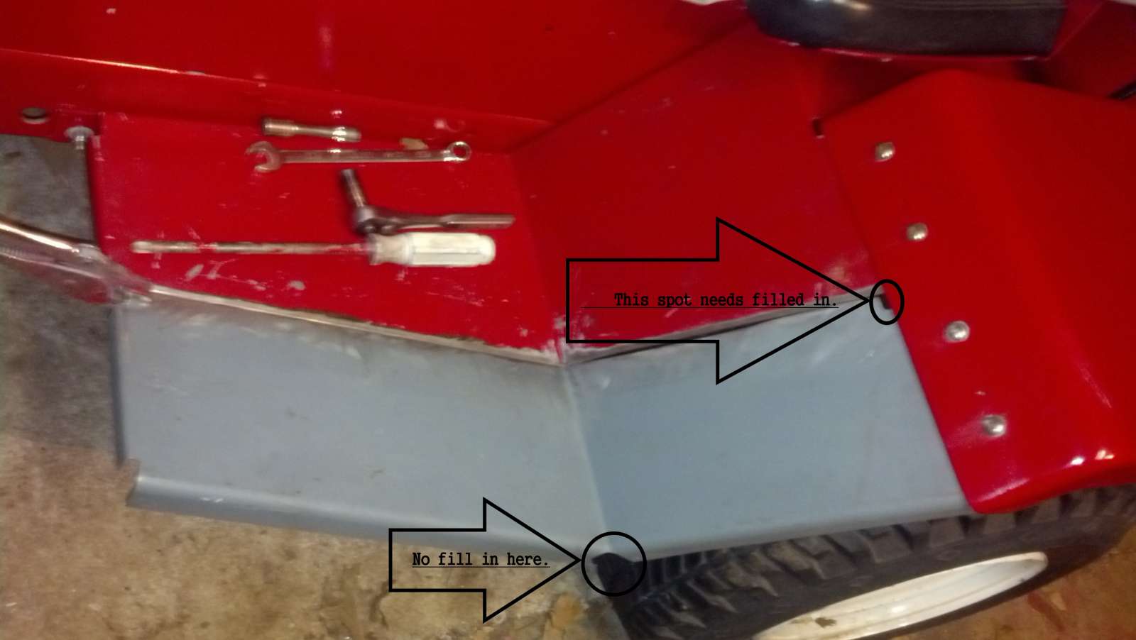

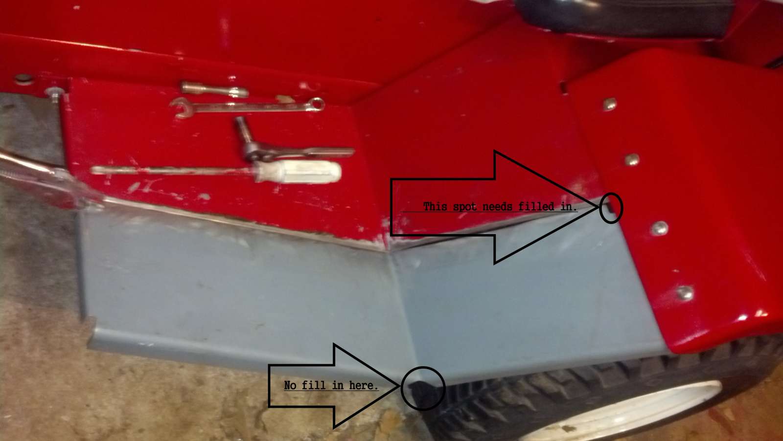

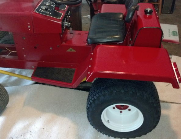

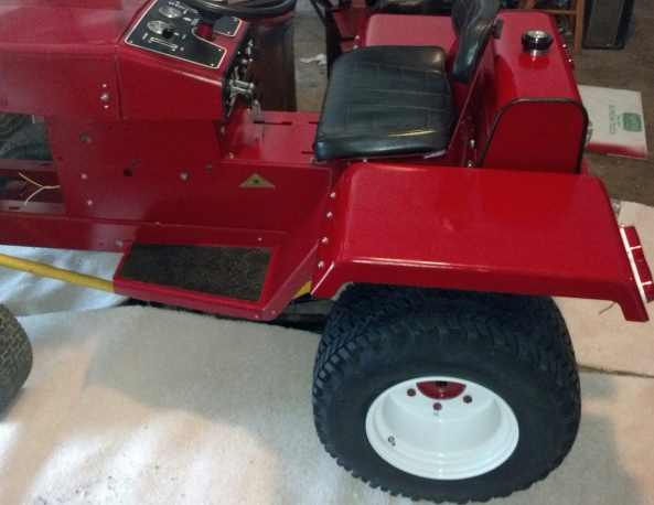

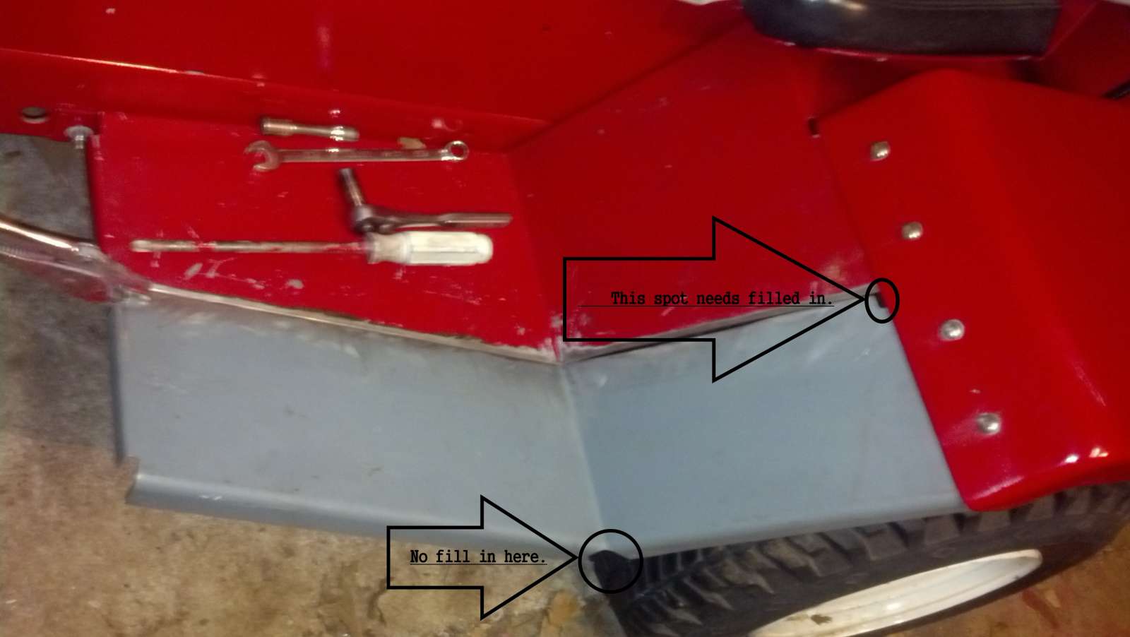

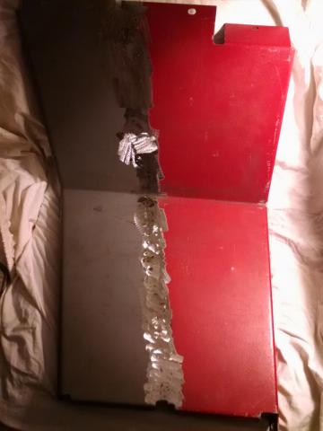

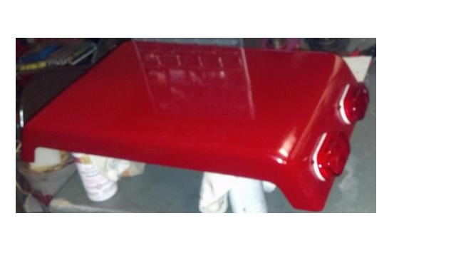

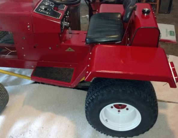

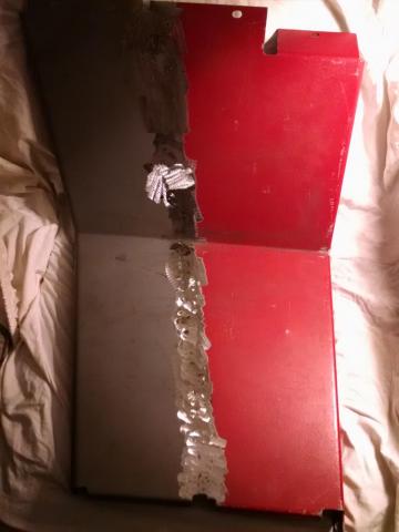

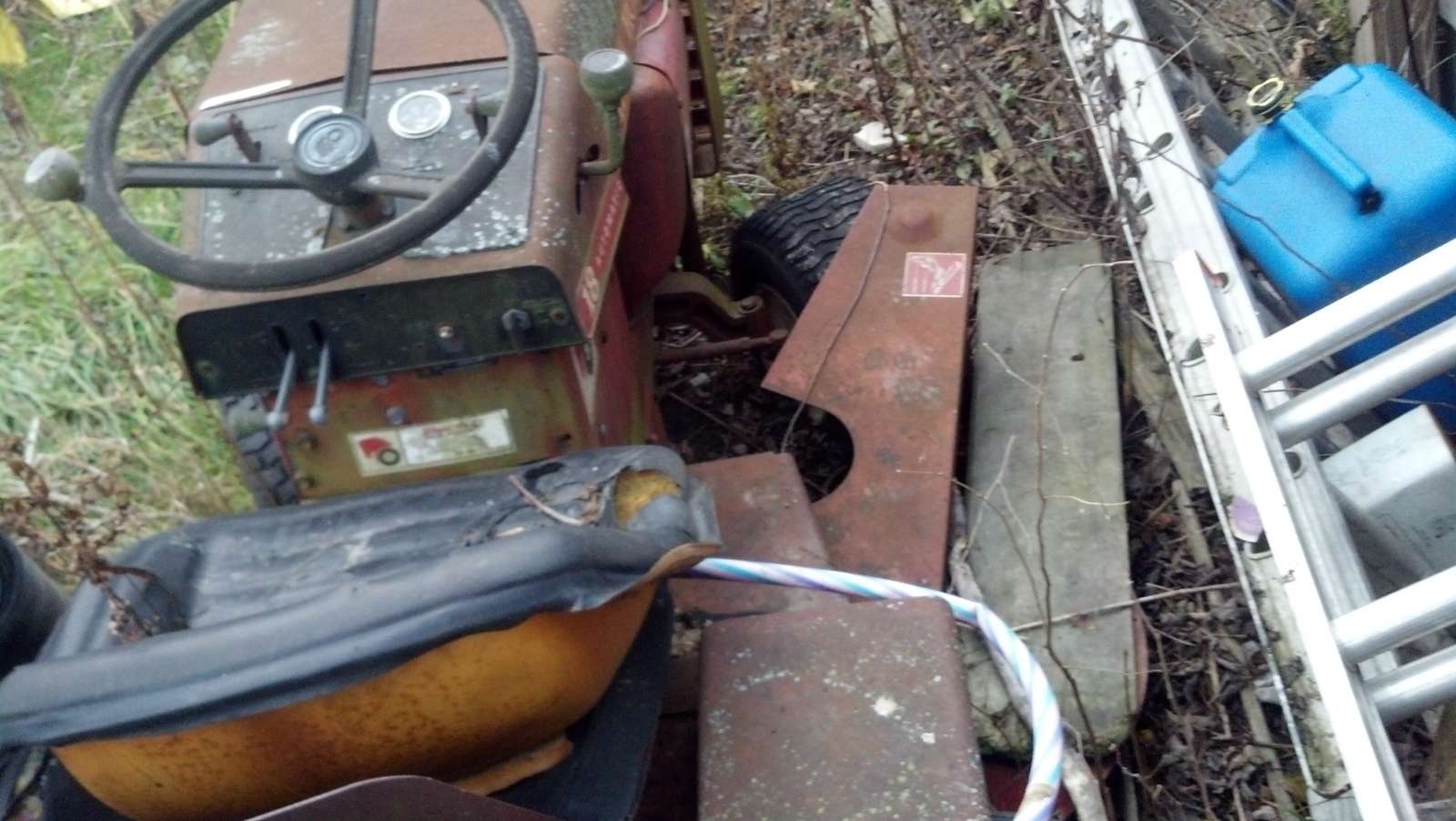

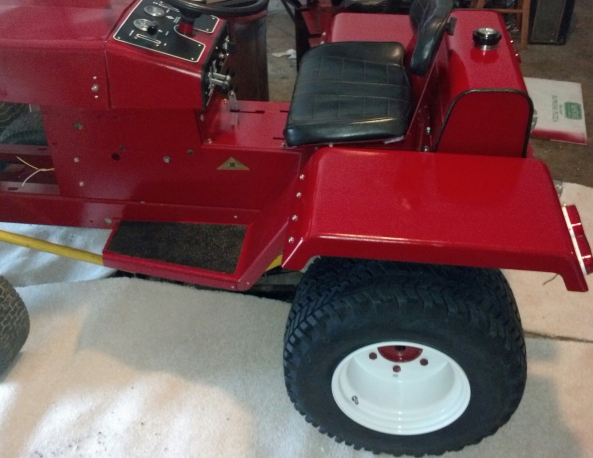

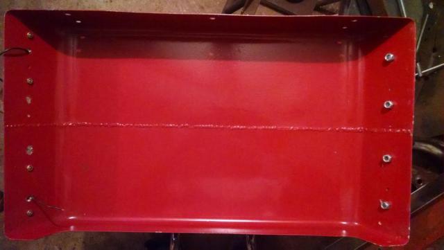

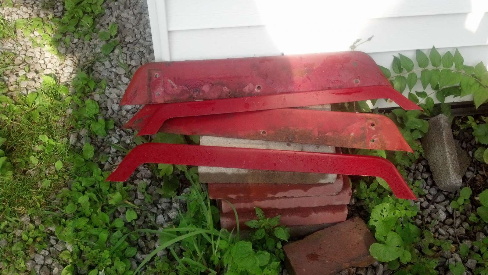

Prior to this I had not ever heard of this model and did not know anything about it {not even that I was supposed to turn the Tow valve counter-clockwise before pushing it.} Not long into a partial dis-assembly I decided to clean up a part before taking a picture of it to post it for sale. I then wondered what it would look like if I would sand, prime and paint it. Wow, I was impressed so I grabbed another, and another, and, and... and the next thing I knew I was in the thick of a restoration. Since this tractor was incomplete and I had still not bought my son a new laptop, I bought an 18 Automatic parts tractor. Now I had some of the parts that was missing and I could sell some of the other parts and attachments, to recoup my investment. I noticed that the fenders did not cover the whole width of the 12" wheels / tires, so I took the pair from my tractor I was restoring and the pair from my parts tractor to a friend who does welding, and asked if he would trim off opposing edges
and weld the other pieces together to make 2 extra wide fenders. He is quite handy at bodywork and agreed to do it. About $200.00 later I had a pair of extra wide fenders welded, bodywork finished, primed and painted.

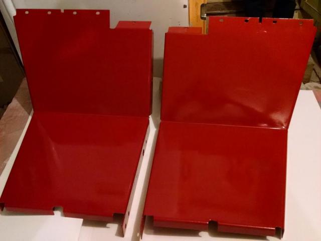

Now I had another problem to sort, the fenders were double wide, but the footrests were single wide.
Yep, I still had a good pair on the parts tractor, so this time I had a go at doing all the work myself,
except the welding,
which was done by my Nephew.
Now I was not just doing a restoration but a Resto-Mod. I guess I am getting ahead of myself, where was I? Oh yea Part 1:

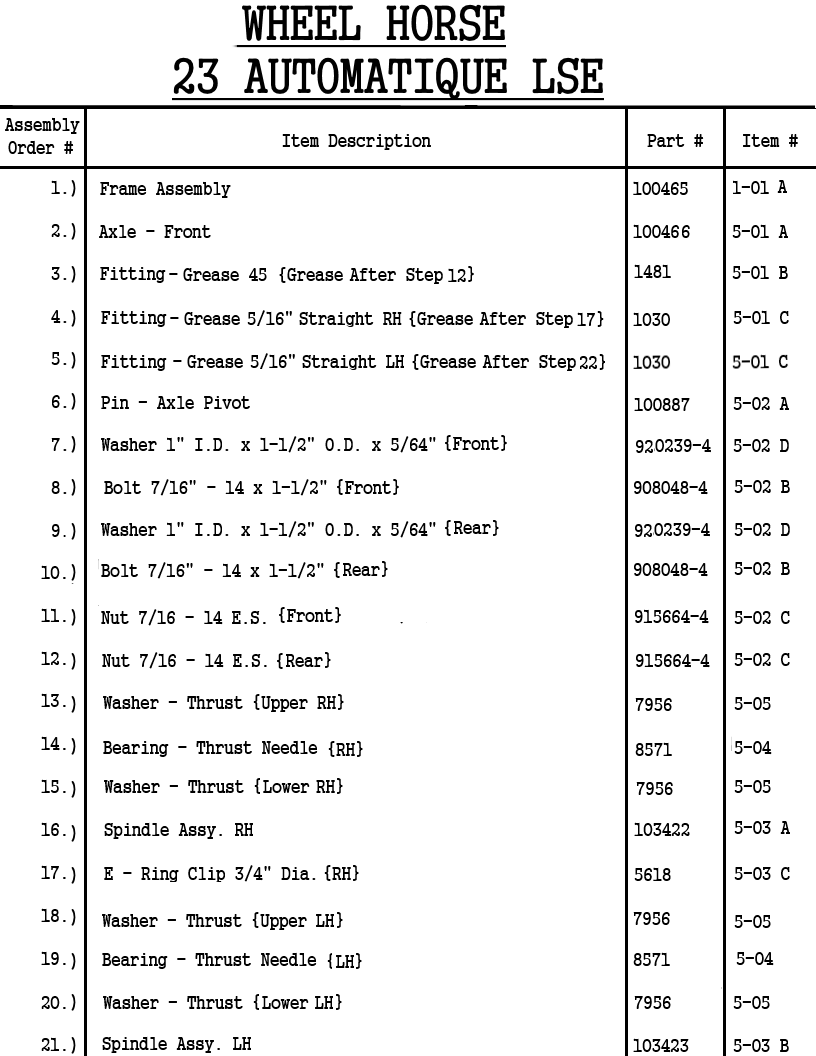

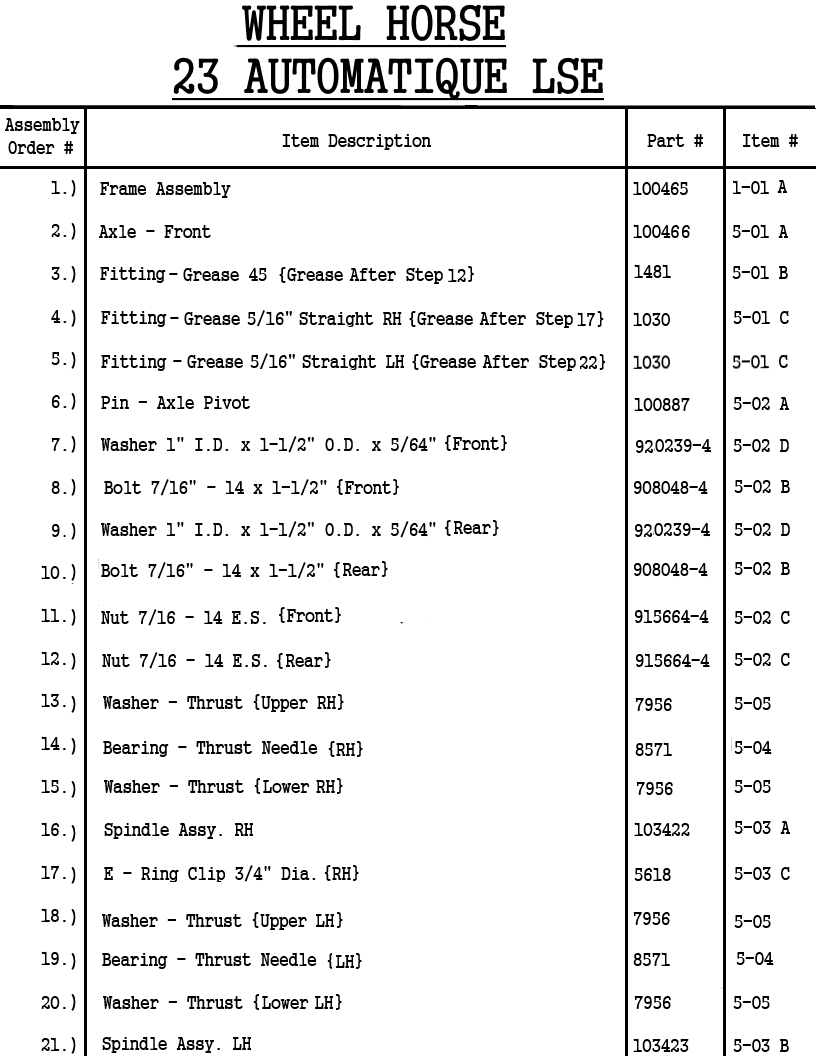

I rewrote the parts list from an 18 Automatic because it contained errors and I wanted something I could use as a simple checklist. I also began {term used rather loosely} to make what I am referring to as an Assembly Order list.
Essentially a list of how I think my tractor should be reassembled in a logical order. In this first part I will commit to complete steps 1-23. {Please note all Parts #'s and Item #'s on the Assembly Order list are correct for an 18 Automatic even though I am using the heavy duty 1" front end.}

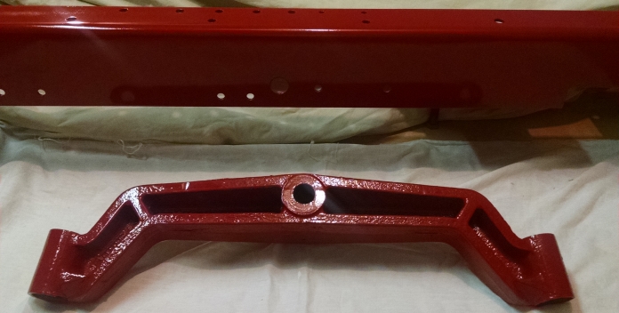

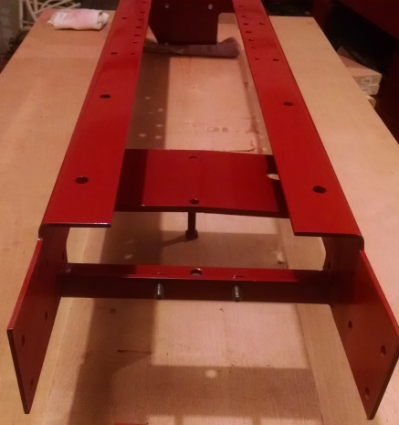

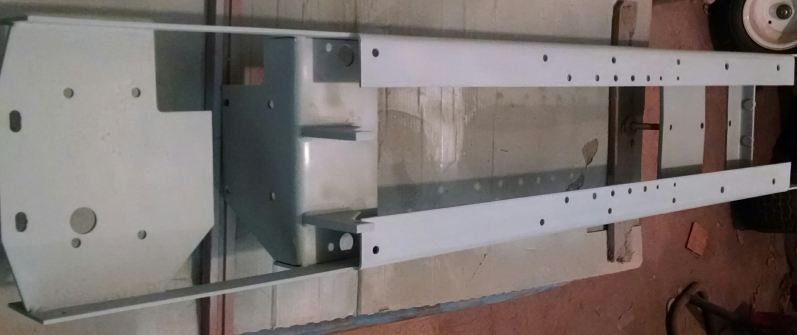

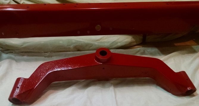

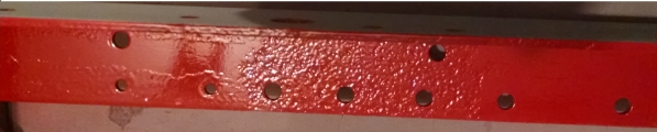

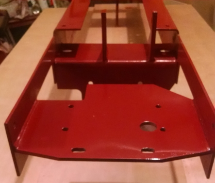

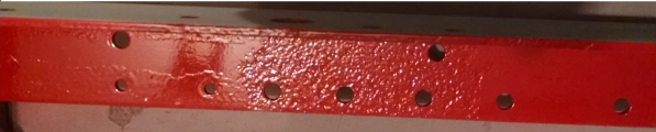

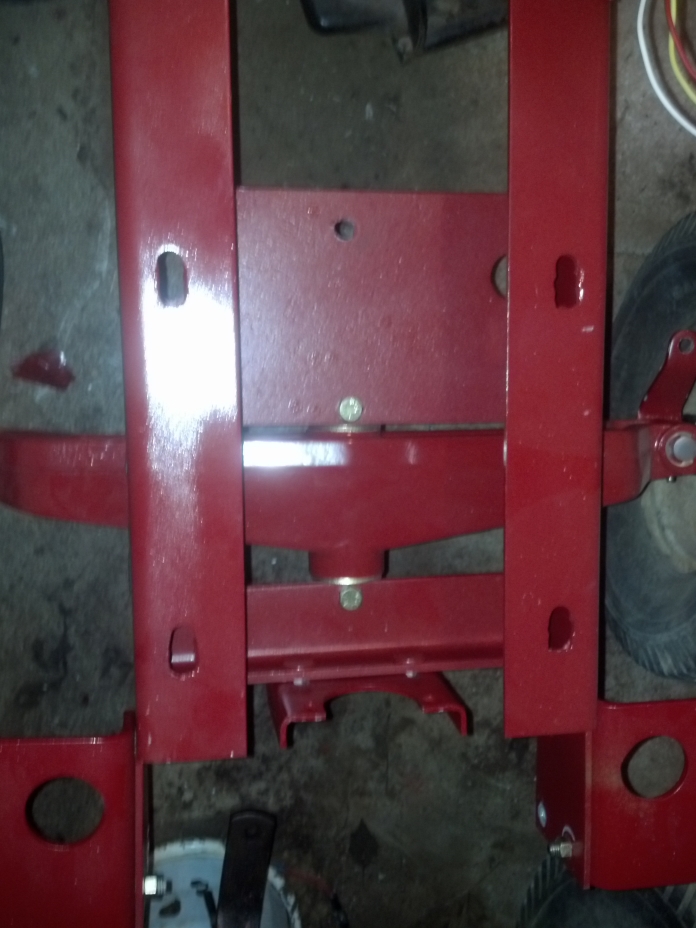

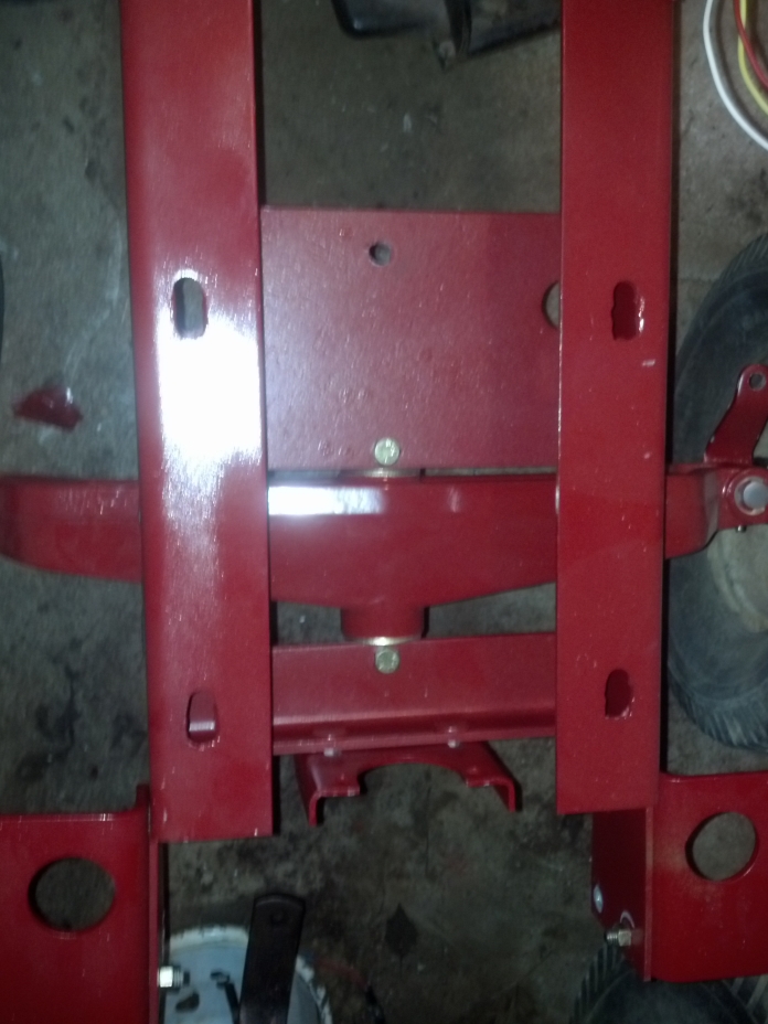

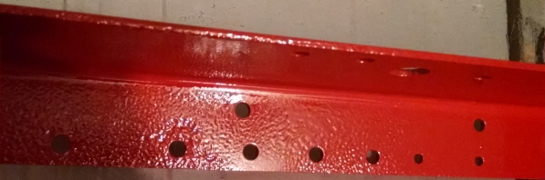

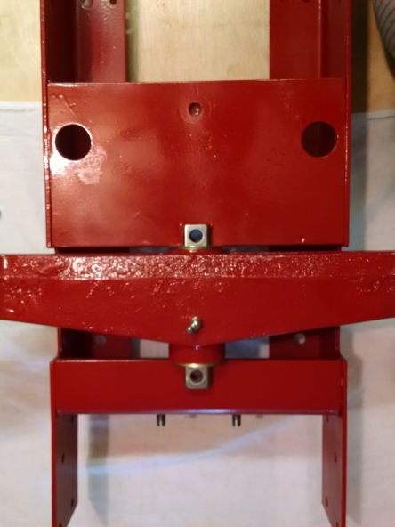

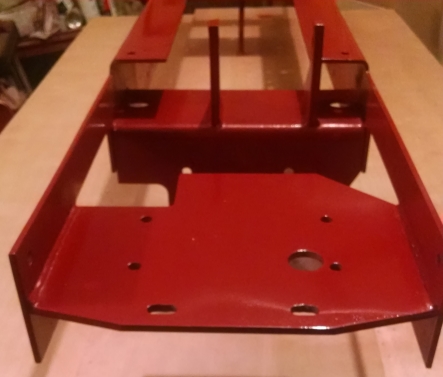

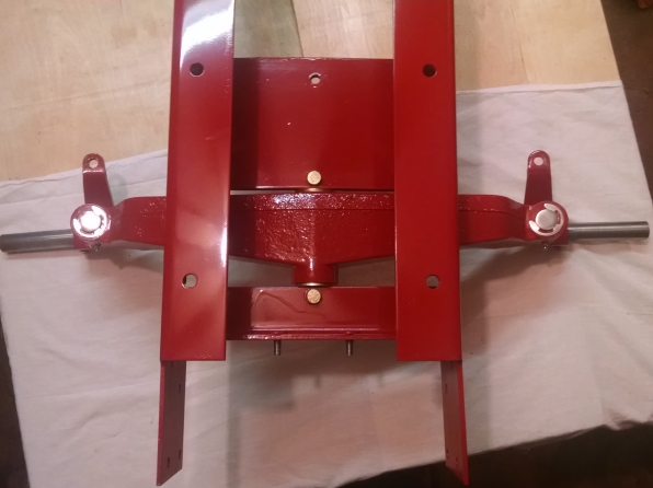

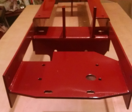

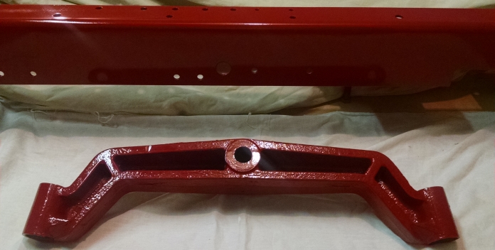

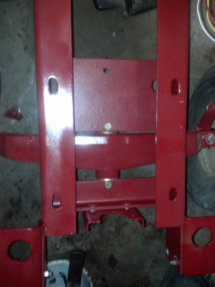

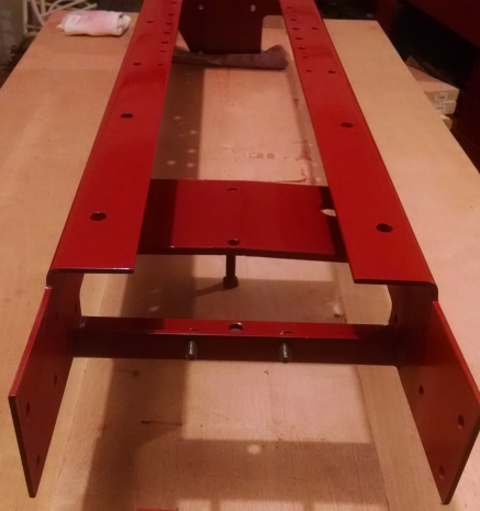

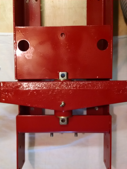

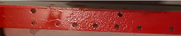

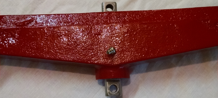

The frame from the tractor I am restoring had the engine mounting holes elongated
by a previous owner, but was an otherwise straight rust free frame. The frame from my parts tractor had all the parts removed and the engine mounting holes were perfect, however there was some pitting from rust on the top and sides of this frame.

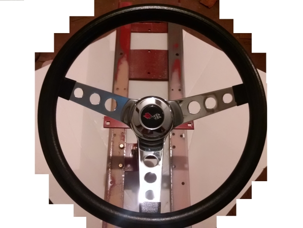

I had already removed the seat spring mount in order to add a hydro fan, so I decided I would do a little bodywork to this parts tractor frame and have a nice straight frame for my Resto-Mod tractor. I did manage to get one picture of the bodywork on the frame as seen in this "just for fun" picture I took of the mock-up of my Grant / LSE style steering wheel.

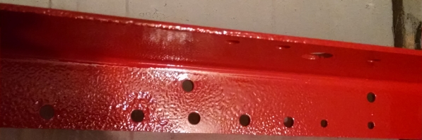

Then I sprayed 2 coats of Ruste-O rattle can primer on.
I also used Ruste-O rattle can Regal Red to spray on a couple coats of color.

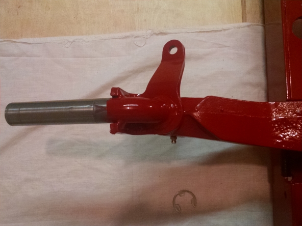

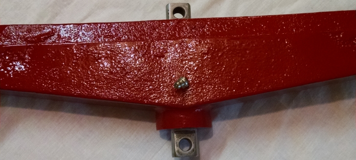

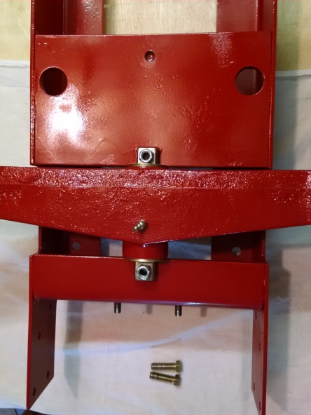

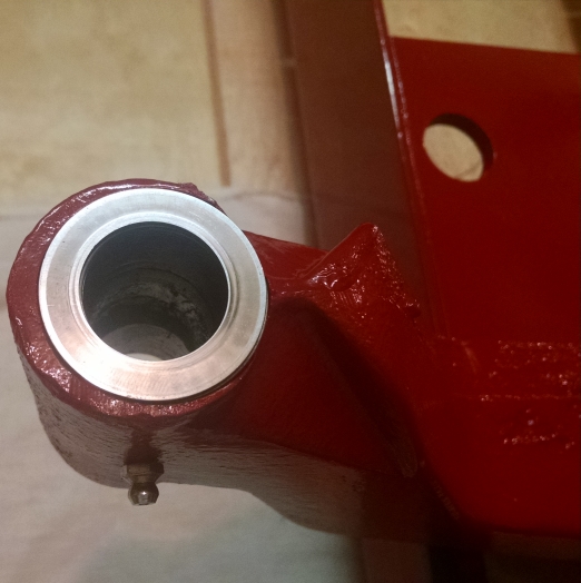

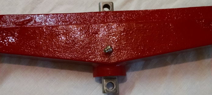

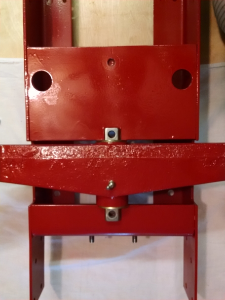

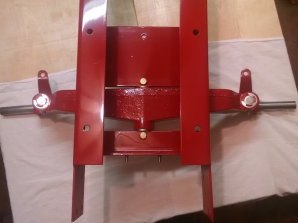

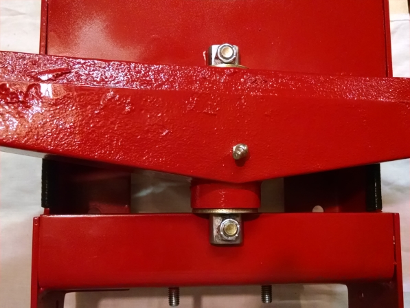

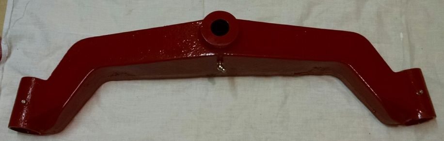

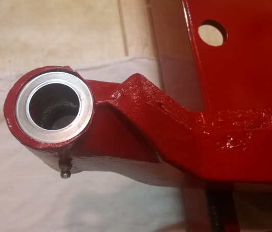

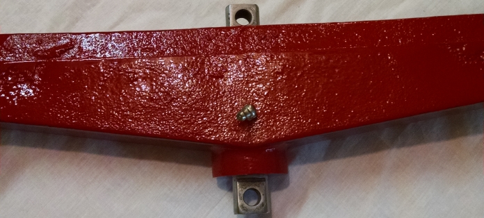

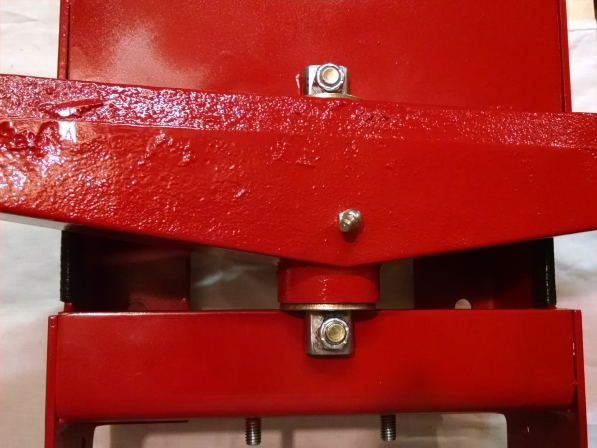

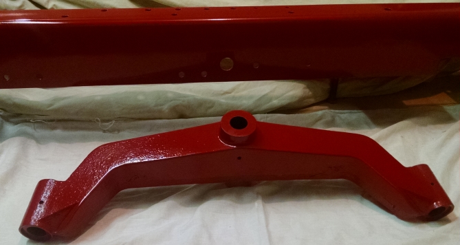

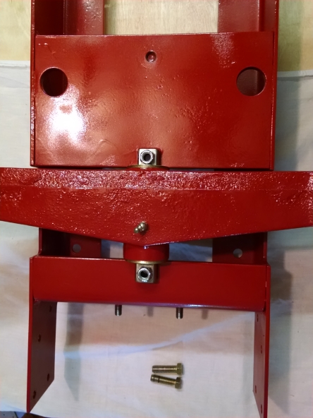

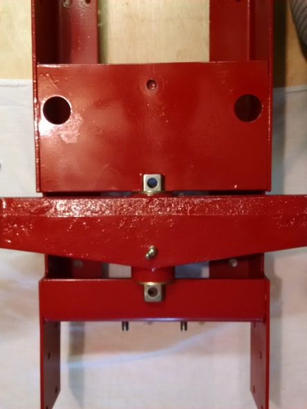

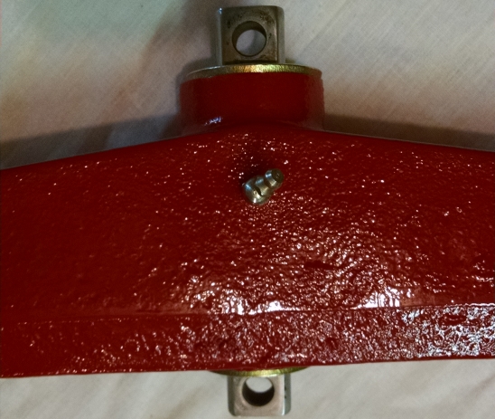

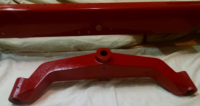

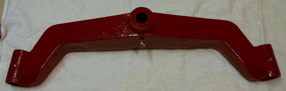

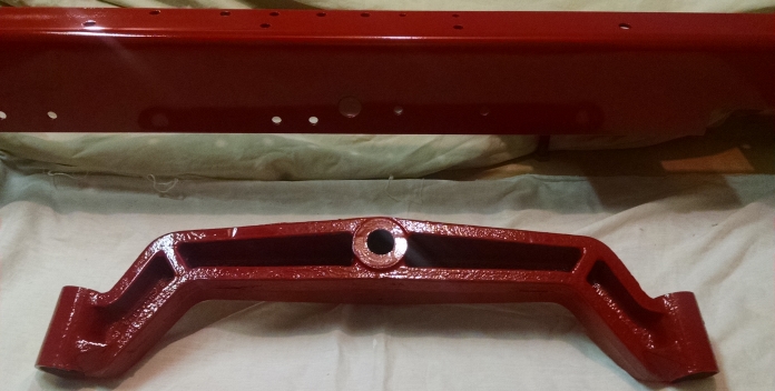

I used a heavy duty 1" axle instead of the 3/4" that came on the 18.

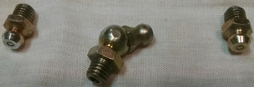

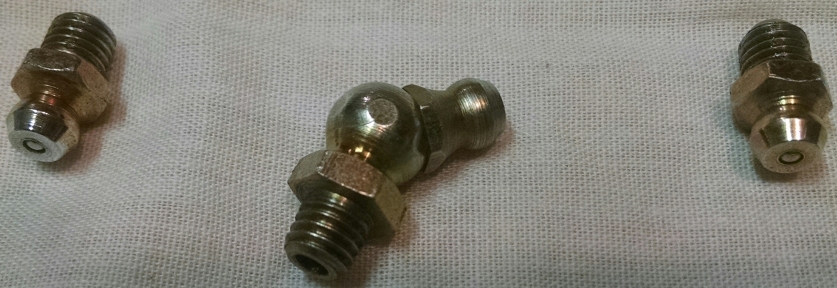

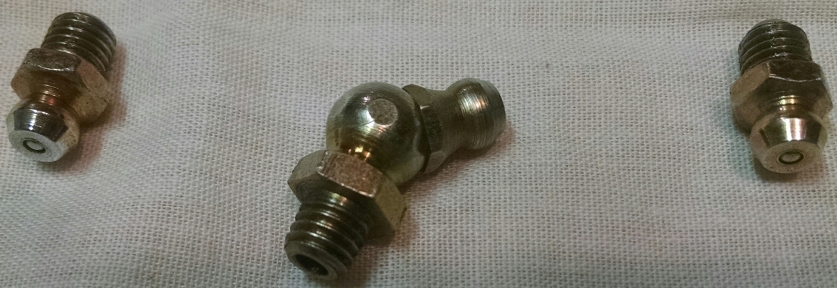

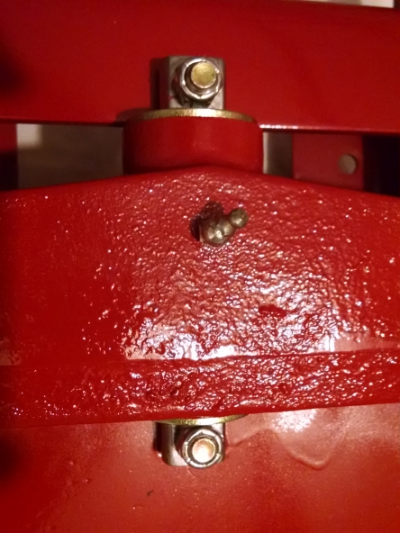

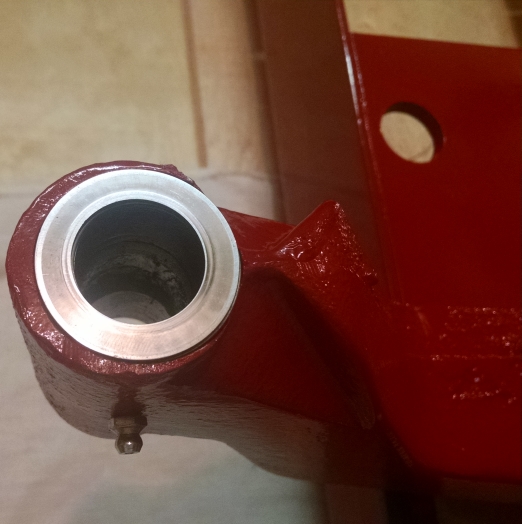

3 Grease zirks,
installed.

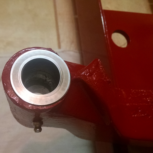

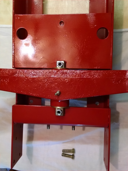

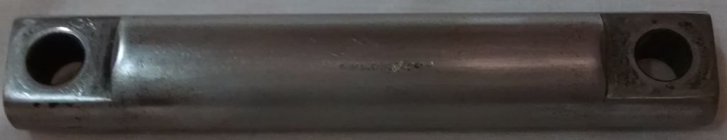

Axle pivot pin,
installed.

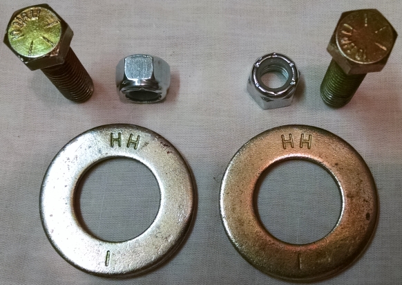

Washers,
installed.

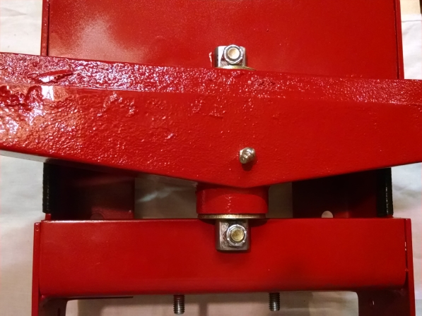

Axle mounted.

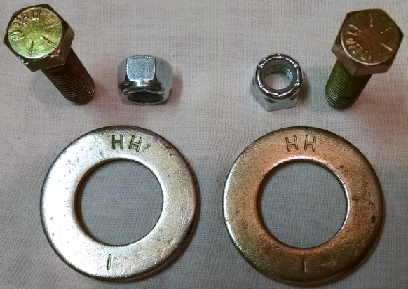

Hex Nyloc nuts,
Hex Bolts installed.

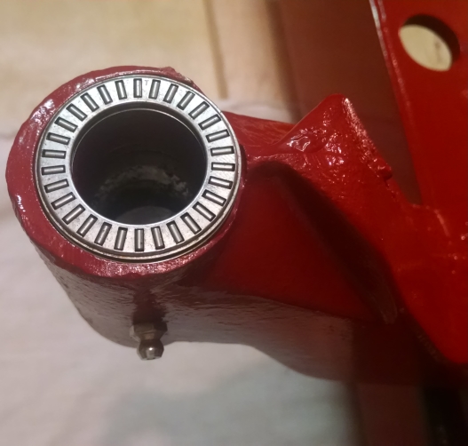

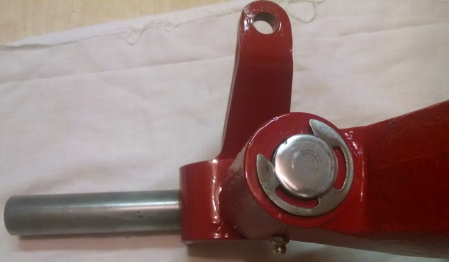

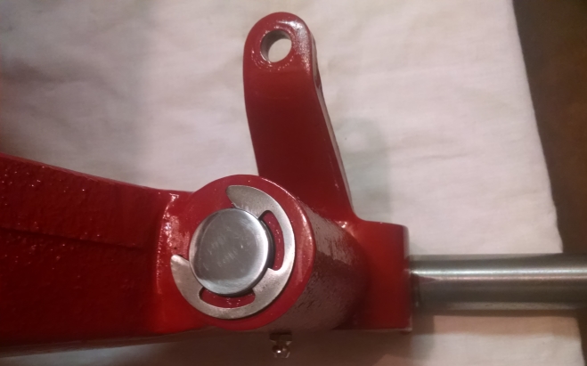

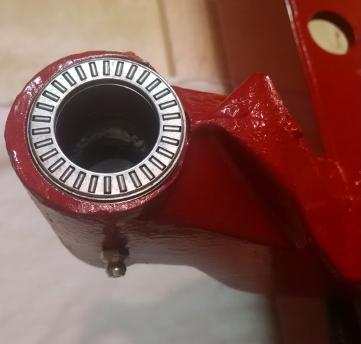

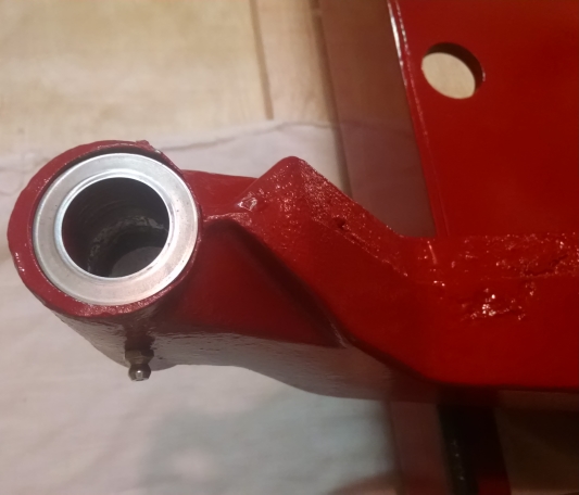

Upper thrust washer,
Thrust needle bearing,
Lower thrust washer.

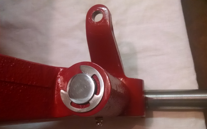

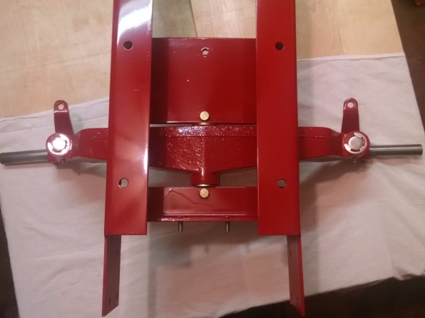

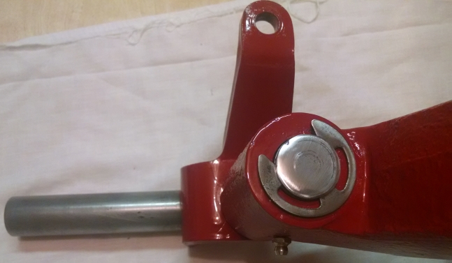

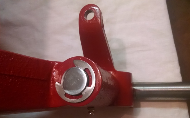

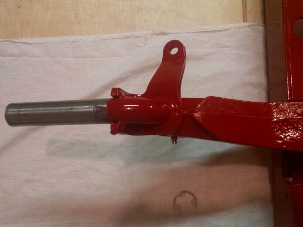

Left spindle,
Left "E"-Clip
Right spindle with "E"-Clip.
Assembly Order Part 1 complete.
I have taken some parts to be machined and welded, when these are finished I will be able to update with Part 2, Mark.

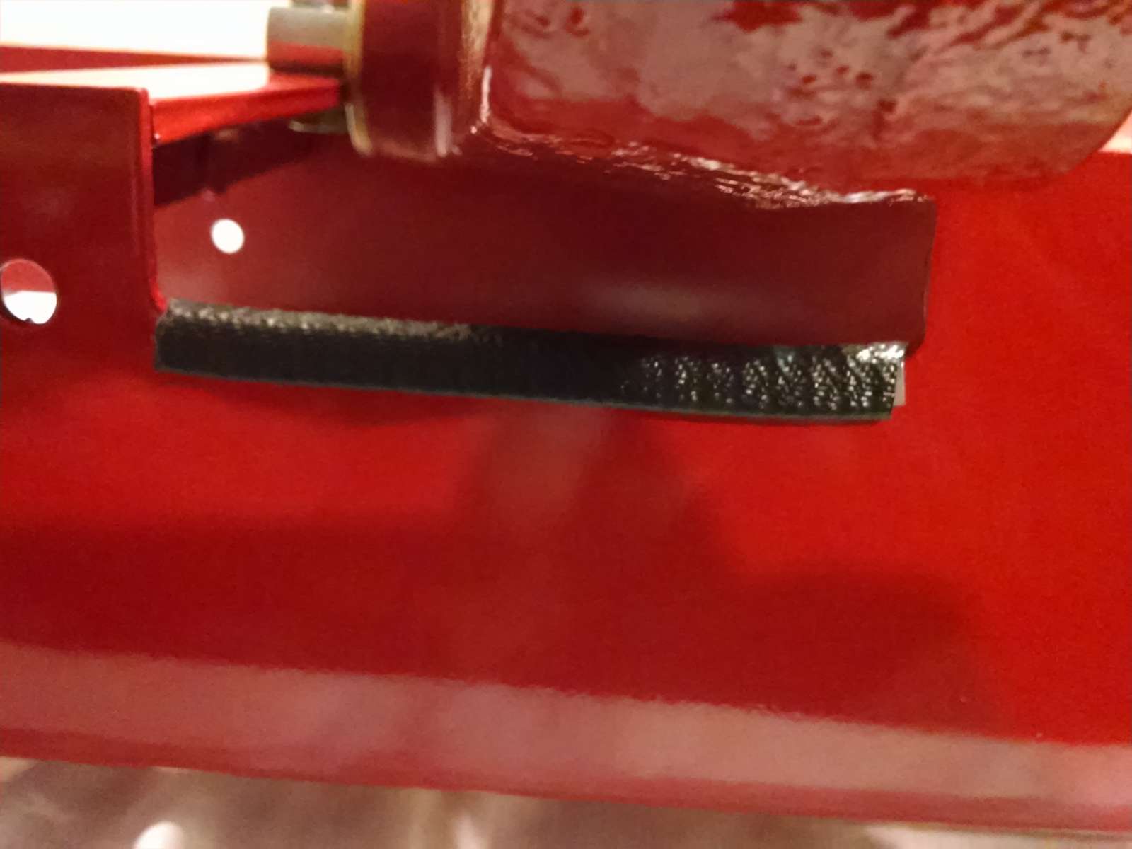

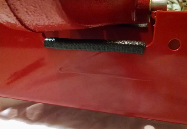

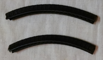

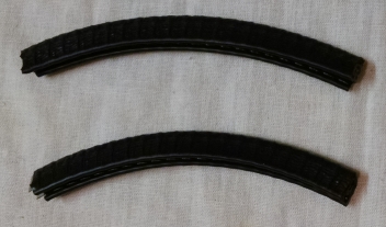

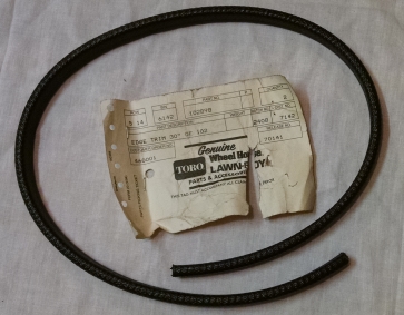

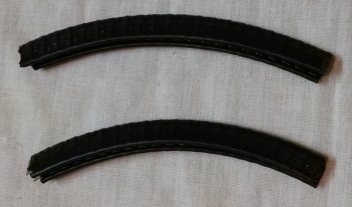

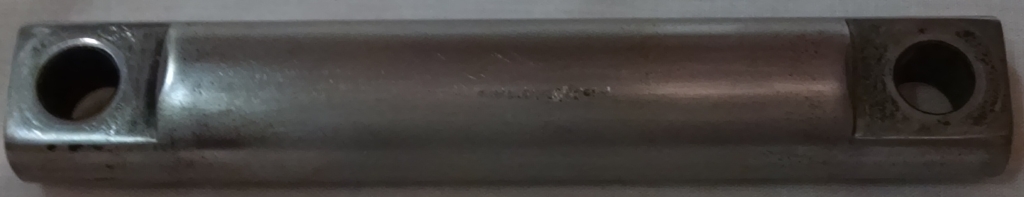

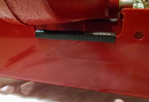

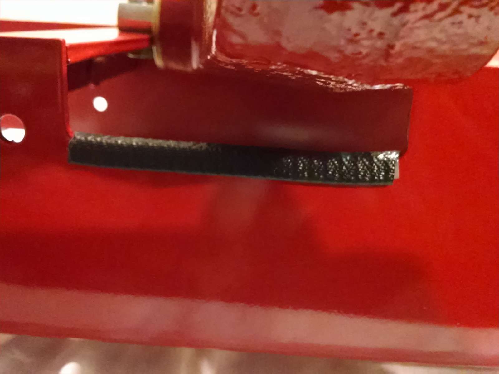

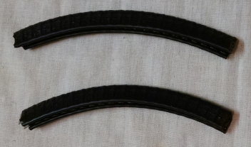

Thanks gentlemen, I inadvertently forgot to add the pics of the edge trim in the over axle openings.
These are not OEM but I just thought I would have a go at placing a couple pieces in here and see if they will stay, sort of to protect the axle from hitting the frame, Mark.
