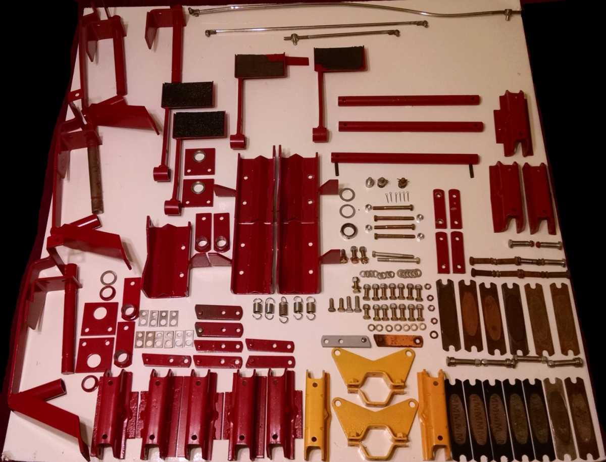

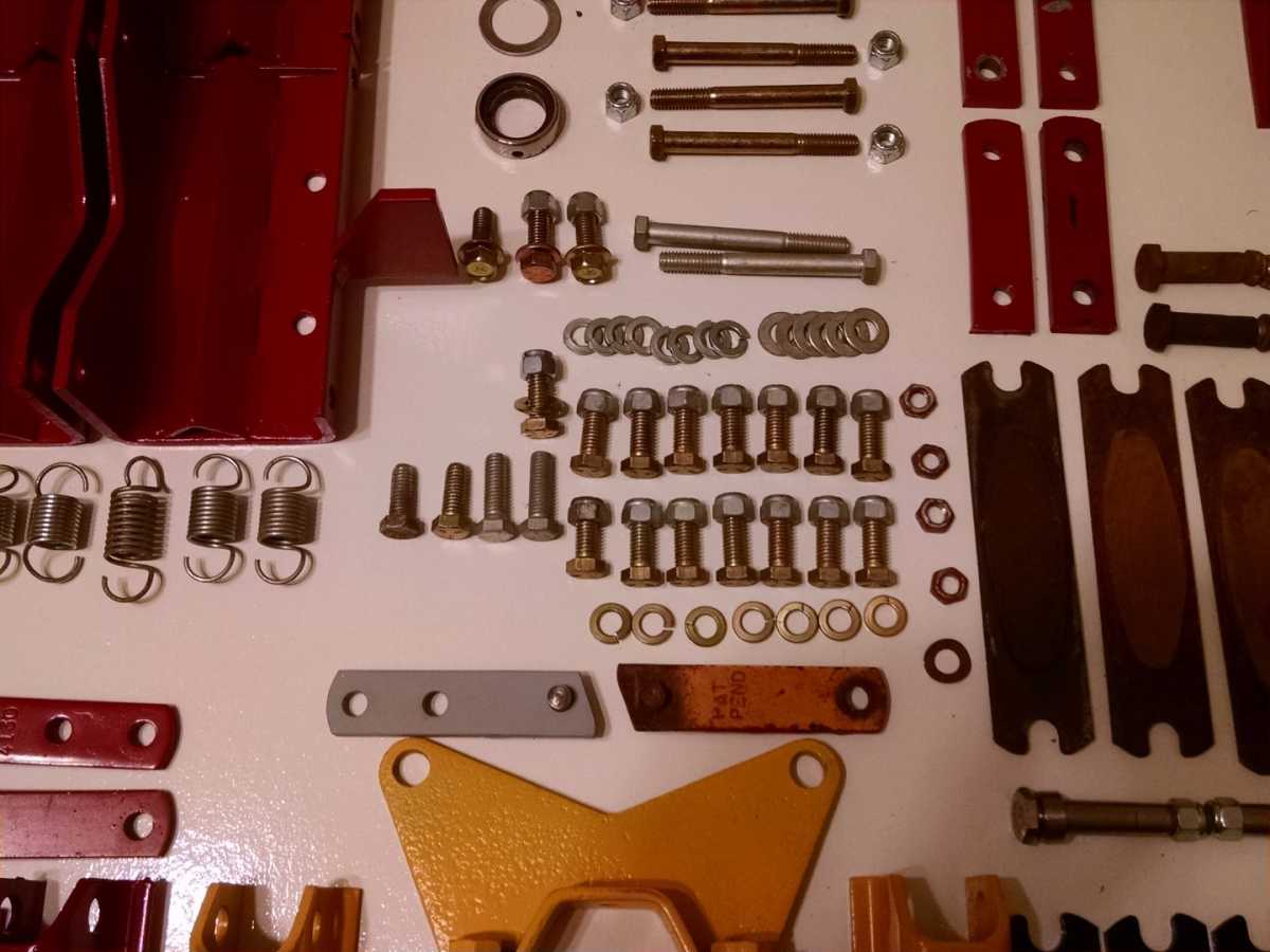

I assembled some of my turning brake parts that I have collected for a photo op! Some parts have been restored, others have not, and I inadvertently forgot to include the disc in the pictures. This is only part of my collection as I also have turning brake parts on my D-180.

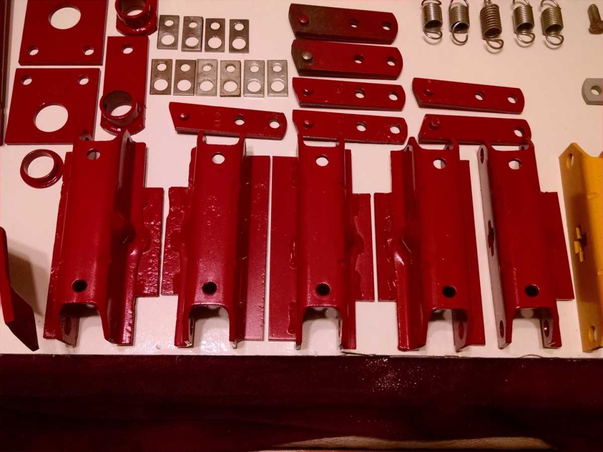

Most are Wheel Horse; however, some are from a Cub Cadet. The parts from Wheel Horse are comprised of parts from an 18 Automatic { Turning Brake part # 8-1901} and "D"- Series. Even though there are differences in parts most should still be interchangeable, although it may require some modification. The Secondary Bracket from an 18 Automatic was beefier and wider than the one made for subsequent models, and the metal was thicker than those used on the Cub Cadets as well.

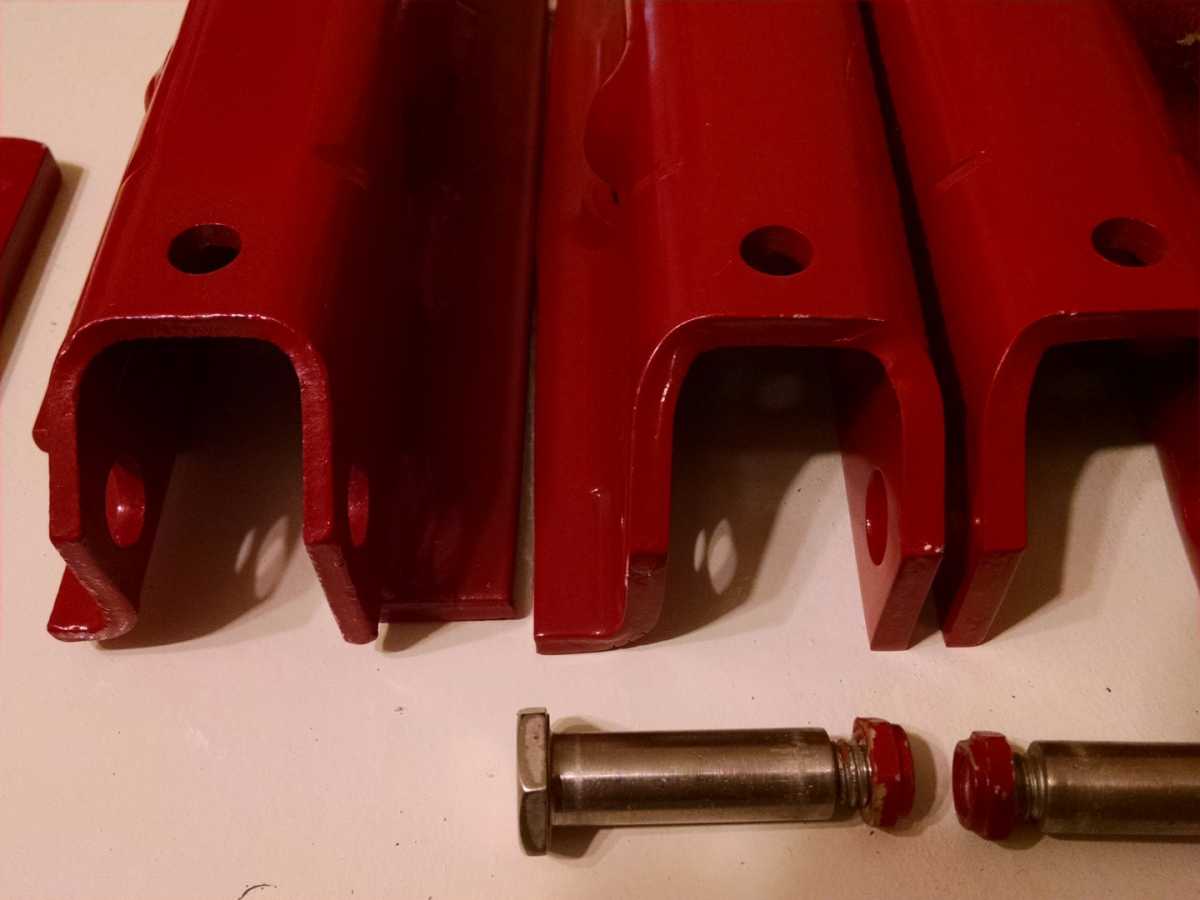

Notice the two on the right have thicker metal than the one on the left. Also note the ones from an 18 Auto did not have the little flat bar {or two} welded onto the bottom.
The 4 Shoulder bolts on the 18 Auto were 3/4" longer than those on the later systems, bottom right.

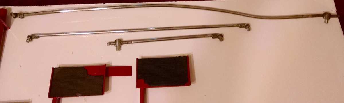

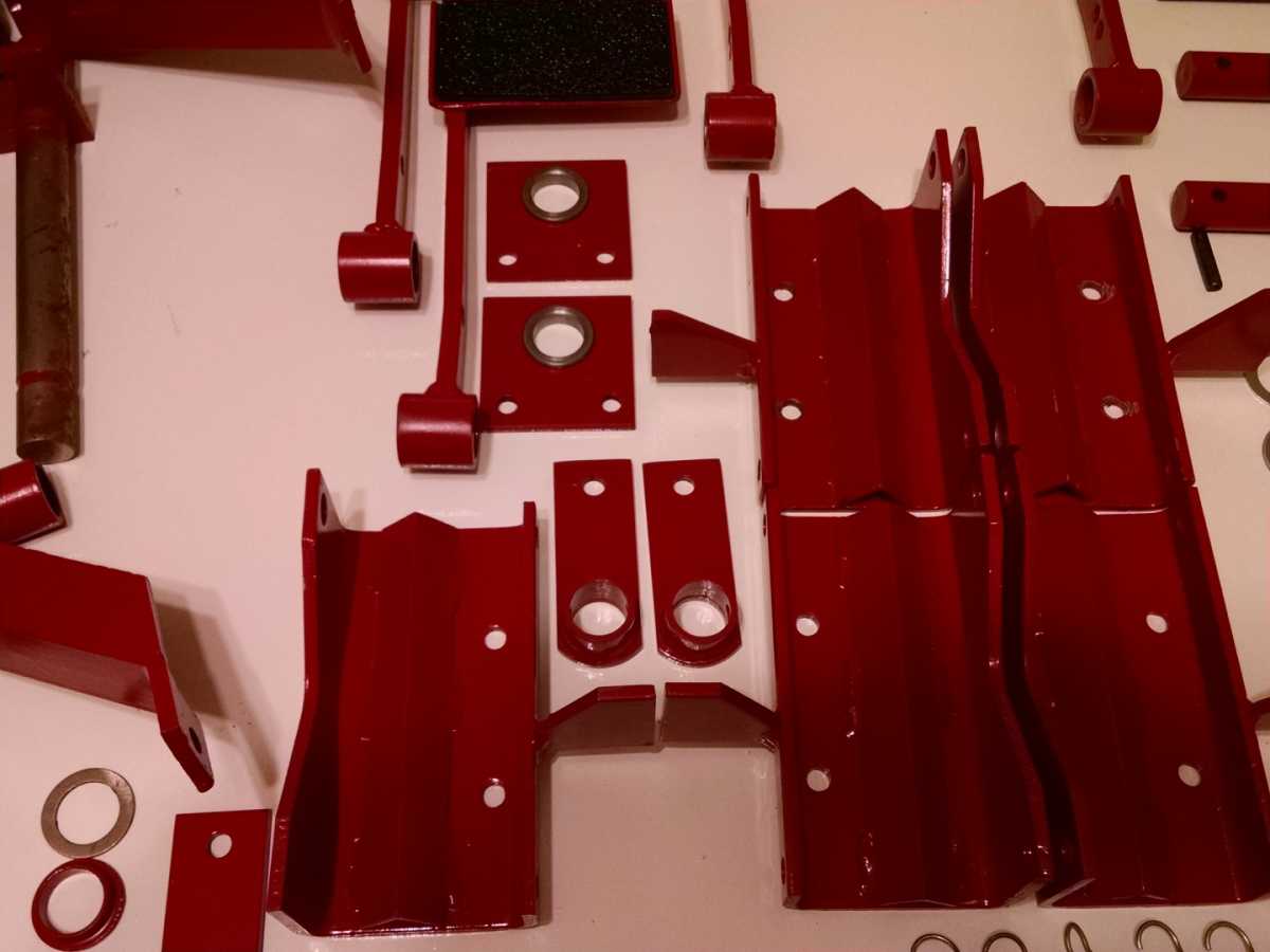

The long rod as well as the short rod remained the same but the medium rods were assembled with a footrest stop on the latter models. This is a picture of the early style rods.

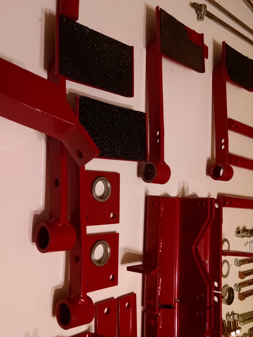

The pedal pivot assembly on the latter models had a cut-away portion {to retain grease} at the points where the pedal attaches.
The pedals on the 18 Automatics had only one hole each; whereas, those on latter models had two holes each.
The brace assembly had an extra support bar welded to attach under the footrest, those on the 18's did not have this bar. The rubber material for the pads were different as well and followed the same material as what was on the footrest.

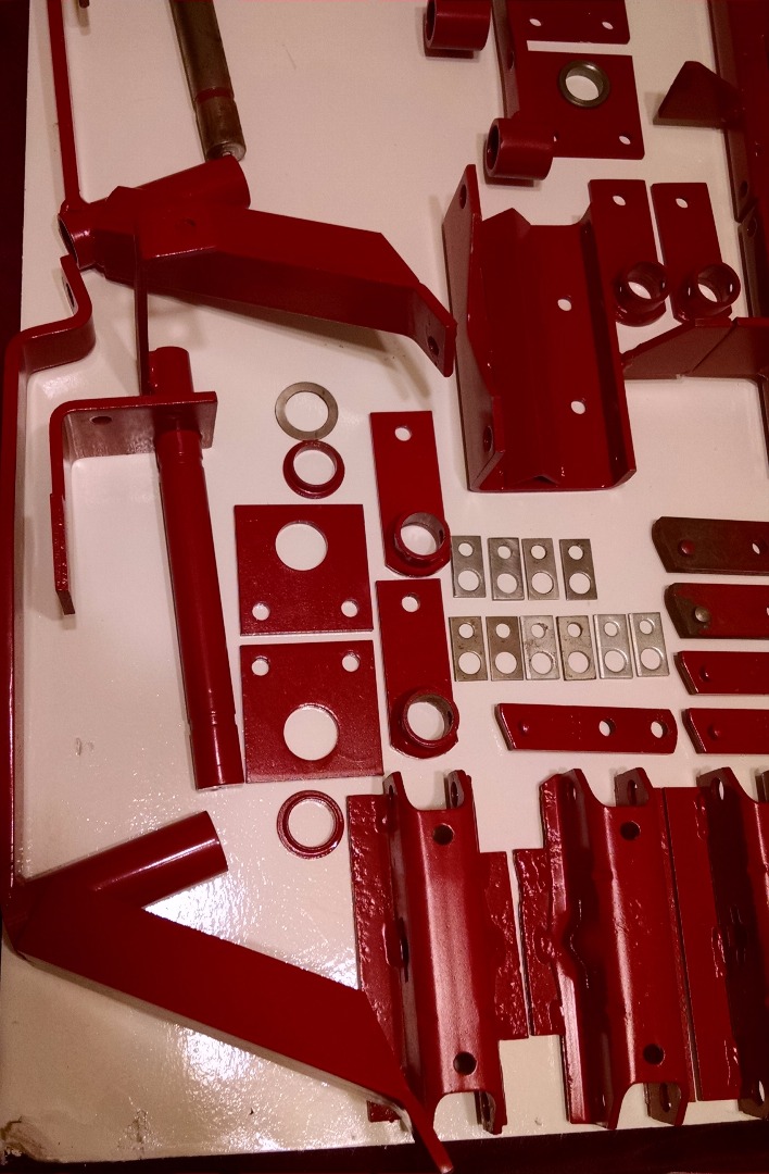

The latter brake mounting plates had a piece of angle welded to the upper side.

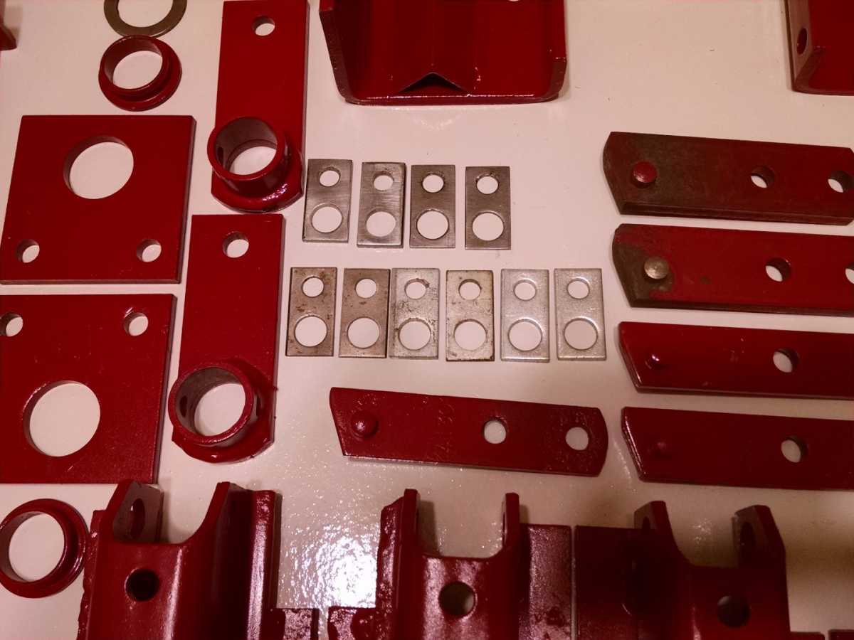

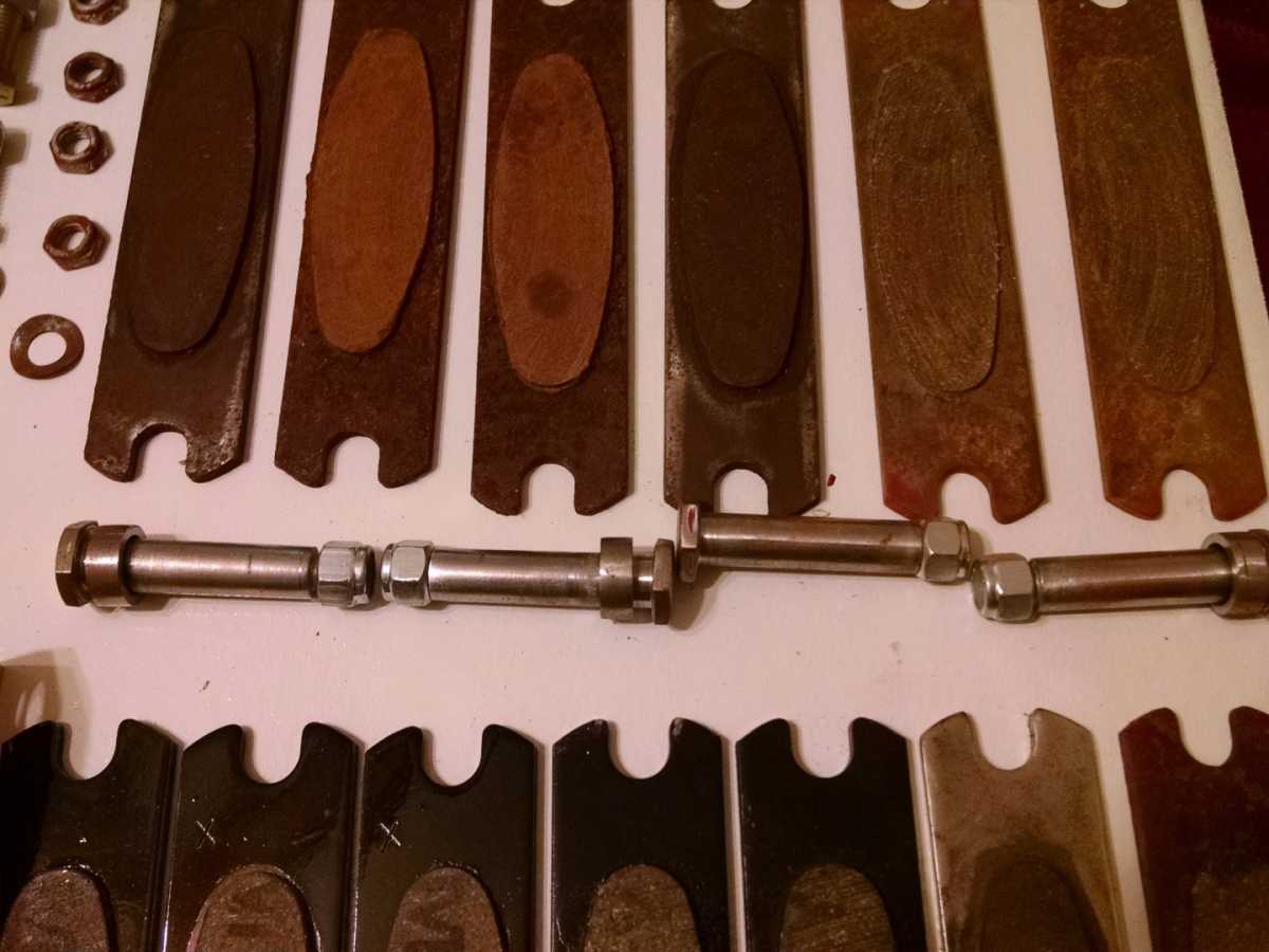

The early shafts were drilled to accommodate a 1/4" pin to secure the arm, while the later models used a 5/16" roll pin, this hole size change was the same for the arms, respectively. The two shaft bearings on the 18 Automatics were wider than those on the later models. The discs have a different part # for the 18 and latter models but I have no idea why. The 18 parts list only lists one size of spring anchor plates, while the latter models add two additional thicknesses to the parts list, presumably to be used on an as required basis dependent on the need.
The plate assembly with the pad has a different part # between the early and latter models but here again I do not know what the difference might be.
