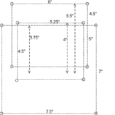

The 3 sets of holes I'm talking about that are adjustments are in the rear pan for the tractor. The part that bolts to the hinge to flip it up. :)
19 Mar 2015 03:46 - 19 Mar 2015 04:06 #1343 by Trouty56
Replied by Trouty56 on topic Seat Help Please?
The seat only has one set of holes that fit....On the diagram I posted they are 4 1/2 back from the front and 11 1/2 back from the front....so look at the spring hole and measure 4 1/2 inches towards the steering wheel.....that will be the front of the seat. The seat you have may be the same. Just drill new holes in the spring......
I'll look at the Charger I have....see where I have it bolted.....I have springs on it also.....

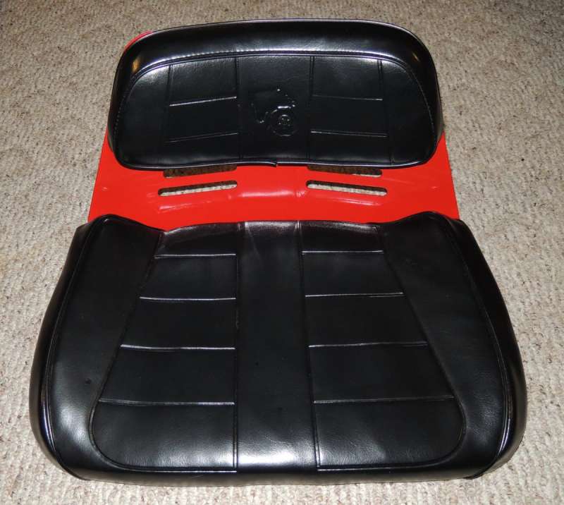

26 Mar 2015 07:42 #2005 by rmaynard
Replied by rmaynard on topic Seat Help Please?
I know where you can get one of these, but it's pretty pricey.
$350.00 plus shipping!

26 Mar 2015 07:46 #2006 by Geno
Replied by Geno on topic Seat Help Please?
That one is beautiful. :drool1
