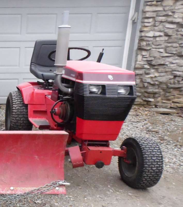

21 Mar 2015 08:38 #1479 by M Bailey
Replied by M Bailey on topic What i havent been doing 85 416-8
Any luck with those bolts yet Pappy? Here's my 416-8 with a Ford 8N muffler. Part number FD1110
21 Mar 2015 10:04 #1480 by nappypappy
Replied by nappypappy on topic What i havent been doing 85 416-8
M Bailey wrote: Any luck with those bolts yet Pappy? Here's my 416-8 with a Ford 8N muffler. Part number FD1110
no luck yet....been putting oil on them........I like that stack thanks.
