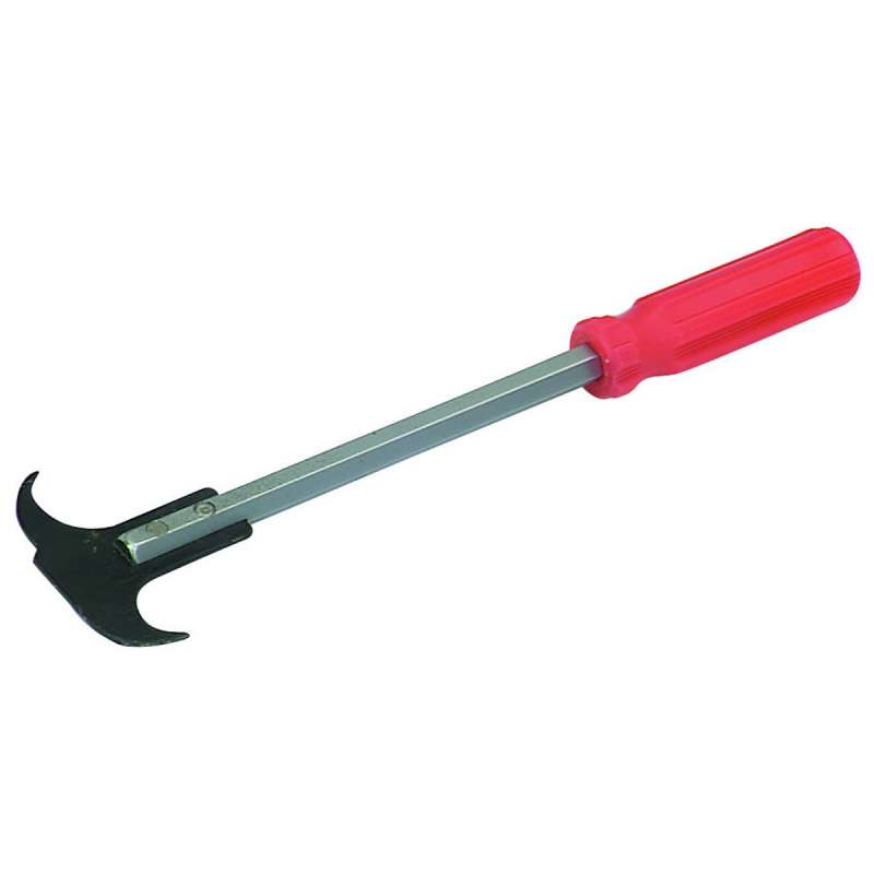

Thanks guys. I have a seal pick, I'll try that first. My seal pick seems too flimsy. If that's a no-go, I'll try the screw/small screw driver approach. New seals on order, due here on Thursday.
