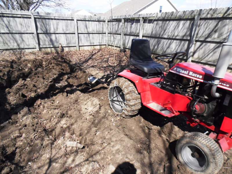

The ground here was perfect for plowing today. Decided it was time to put the 416-8 to work pulling the 12" Brinly. Wow! The old Horse did a great job with just chains and no weights, errrrr, except for my 210 pounds. A couple of more weeks and it'll be time to run the disc. :woo

You are really going to town.
31 Mar 2015 19:02 #2313 by Geno
Replied by Geno on topic 416-8 Plowing the Garden
Awesome Major! :woo That thing plows deeper than I thought. :thumb1

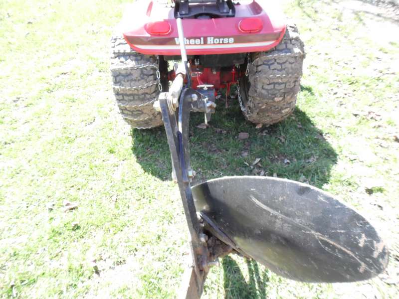

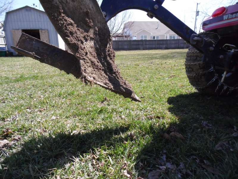

These old Brinly's do a great job when the set up is right. This one is pulling from hole 2L with the right front wheel in the furrow and the pitch set for 6+ inches of depth.

Bob, the space between my wheels is only 19" but for whatever reason, the 2L position works best for lining up the front wheel in the furrow. Here's a couple of pics of how it looks lifted (before I cleaned it off), a lot more pitch than one would think.

You know Major.....guides are only that....guides....whatever works best. That 12 inch plow is big.....hard to believe a tractor can pull it....
