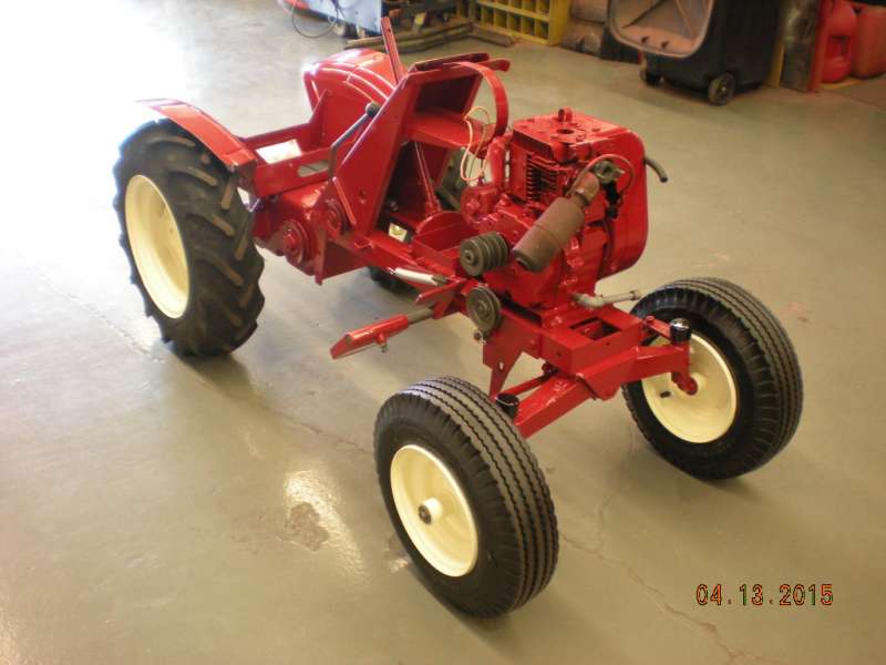

Looking to see what works best for getting these pipes out of the engine blocks. What has worked best for you guys? :idea
I asked Sandra if she wanted a stack, she said "well duh". :rolling
Here's what we're working on -

I've been putting PB Blaster on it for about 5 days. I got out the 2' pipe wrench and took a hammer to the end of it and gave it some hammer action and she came out. I like hammer action better than constant pressure, seems to break less things overall, sort of like an impact. Thanks for all the advise guys. :thumb1
