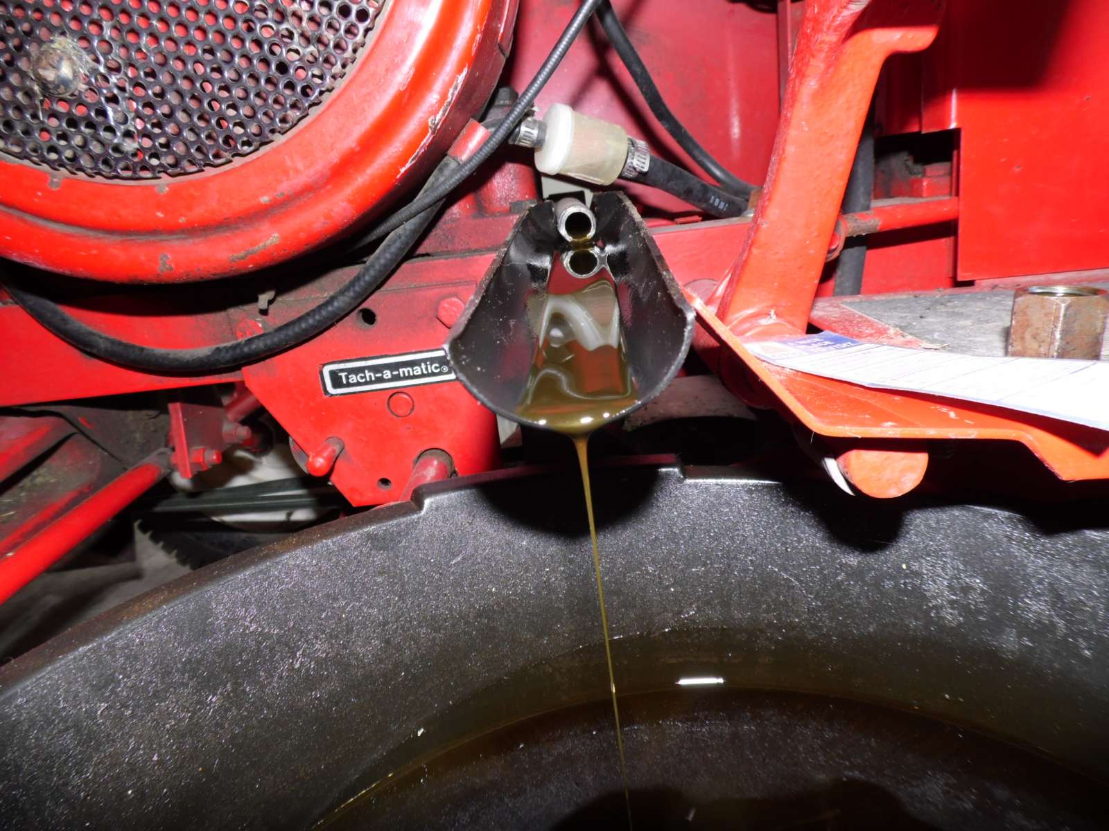

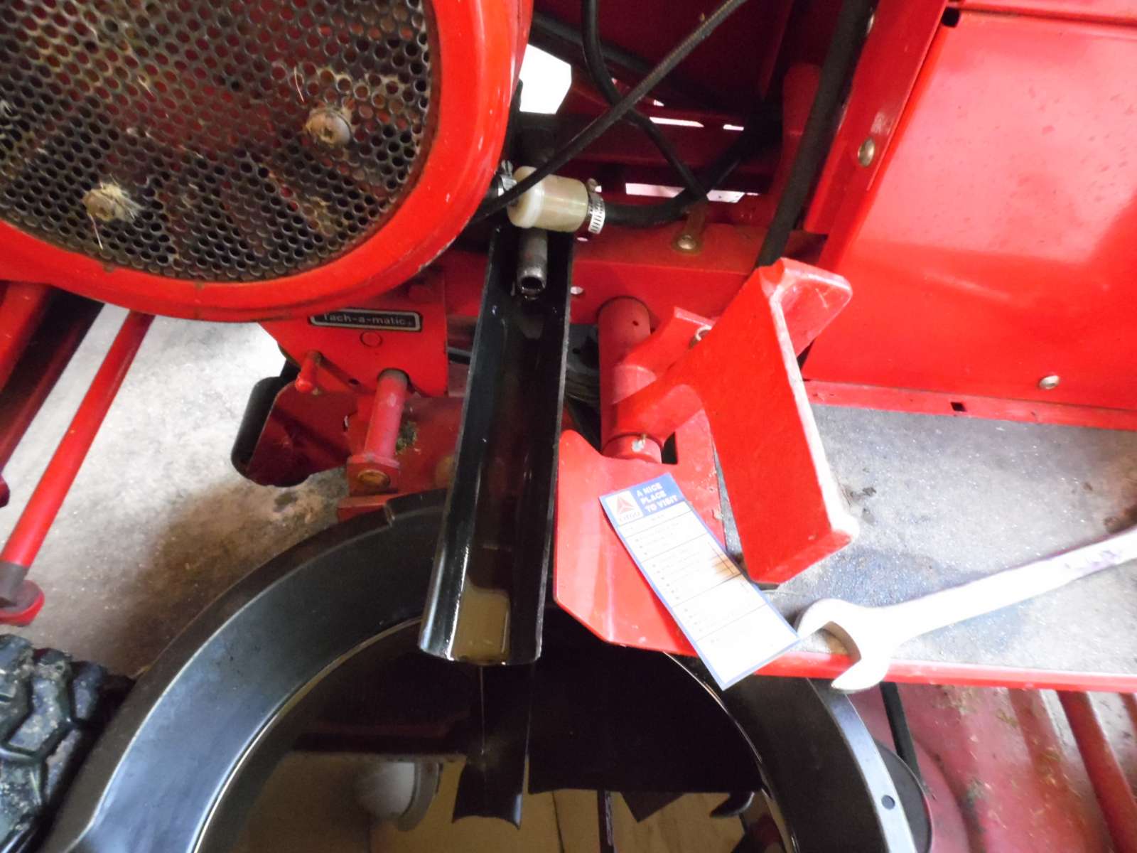

Get out the tools for the oil change including the handy little oil trough which makes changing oil with a deck on a snap.

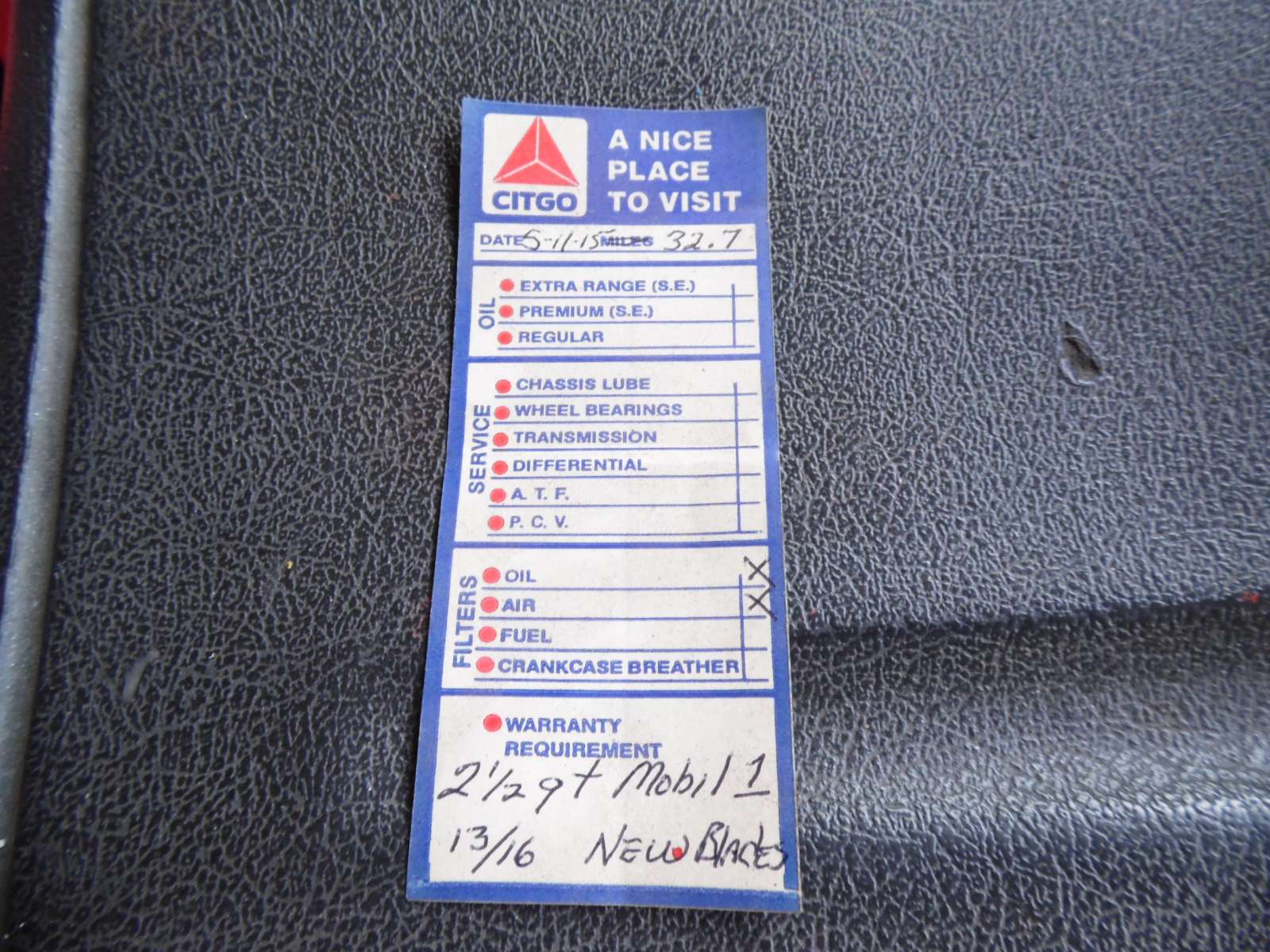

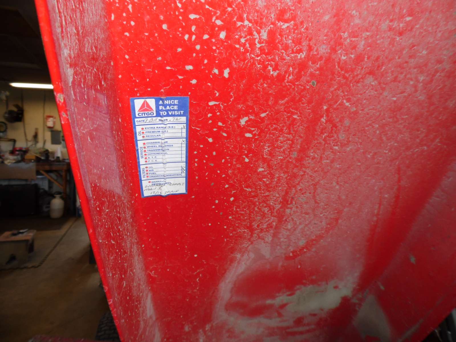

2-1/2 quarts of oil and a new sticker under the hood and the old horse is good for another 25 hours.
Putting the wrench size along with oil capacity on the sticker helps out for next time, especially if you're like me and can't remember what you had for breakfast :rolling3

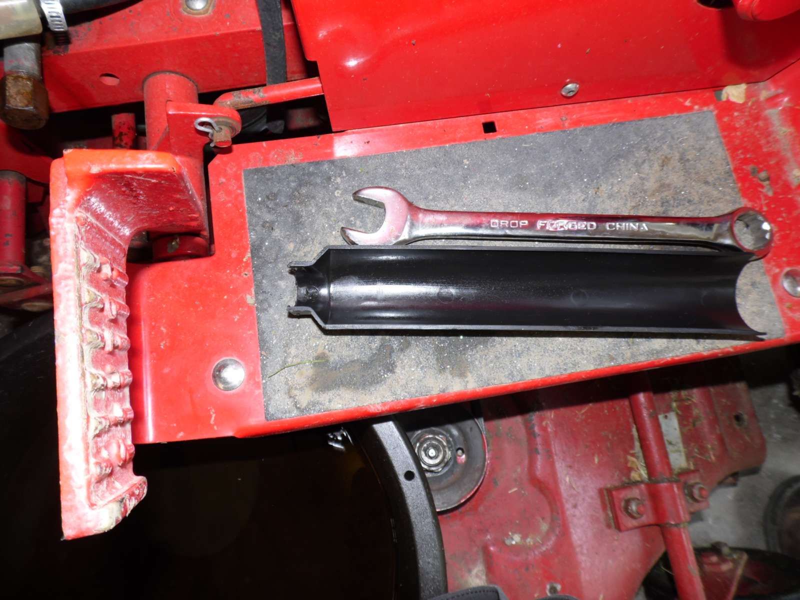

11 May 2015 16:17 #4336 by M Bailey
Replied by M Bailey on topic Routine Maintenance
I should have posted this earlier, here's what the drain trough looks like in its entirety. Can't remember where it came from but it's been around for a long time.
11 May 2015 16:24 #4337 by AJ WH Ranger
Replied by AJ WH Ranger on topic Routine Maintenance
It look like a housing for a small air pump cut in half.. :)
11 May 2015 16:32 #4339 by nappypappy
Replied by nappypappy on topic Routine Maintenance
Deck in the way.... Front mount it
....I cant say enough good about it.....
