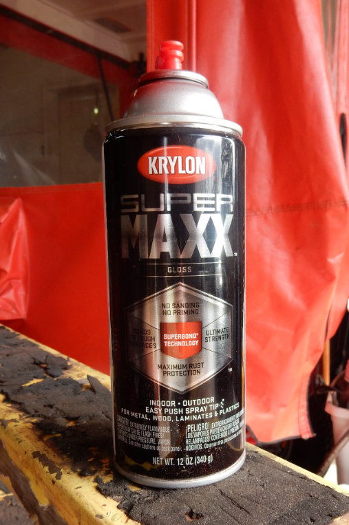

18 Mar 2016 15:13 #10874 by Geno
You have the Super Maxx, we have some of that to try out here and it's supposed to be pretty good. How do you like it Kurt? :)
The problem paint is the Cover Maxx, in the can with the red label, or usually has the color of the paint on the label.
18 Mar 2016 16:03 #10875 by Kurt-NEPA
Replied by Kurt-NEPA on topic Wheel Horse recommended paint colors and codes
I didn't know there were two kinds of Maxx, so I'm learning something. I've used this Super Maxx for several years now and I'm generally happy with the paint. It goes on easily and dries quickly to a nice finish. Its been holding up well so far, but I've only used it for about 5 years. All my horses are kept inside in the stable, so fade has not been a problem.
My only issue has been color match, and that's not Krylon's problem. One red is too dark and one too lite on my 520H's. Valspar IH Red does a little better for color, but its still too bright and I can't get it locally anymore. When TSC was carrying it I used it often. For what its worth, I prefer to use quart cans with my HVLP gun and hardener. Works great, but clean up is a PITA.
I have a snow plow for my 8N painted in Rustoleum Sunrise Red. It took forever to harden and has faded badly. I've been steering clear of the old standard Rustoleum enamal for some time now.
In rattle cans, Krylon and Valspar are the way to go.
