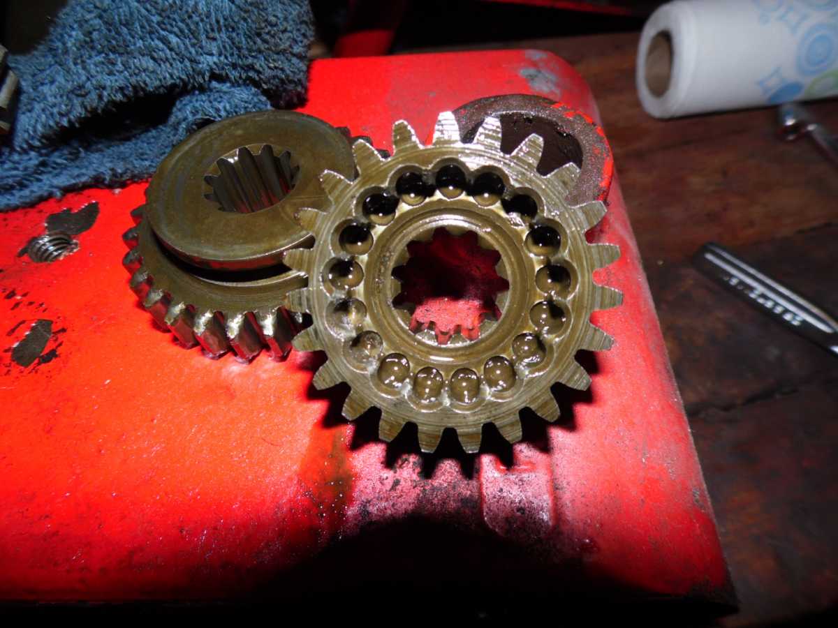

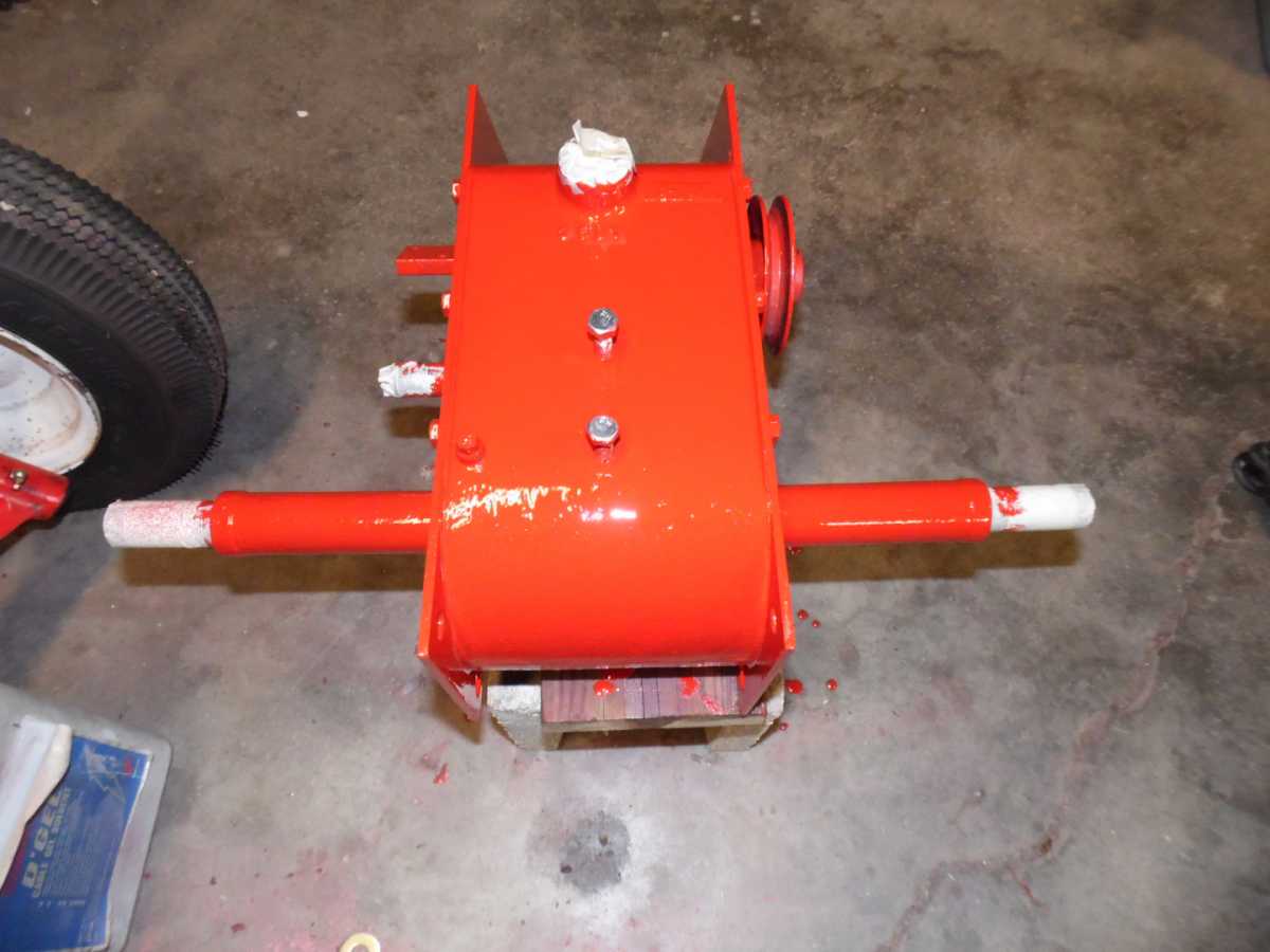

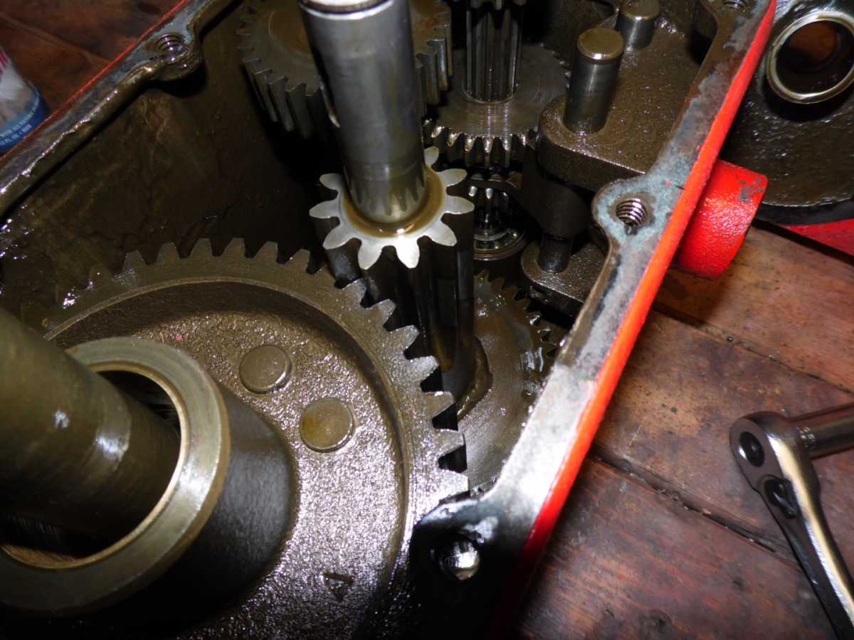

A few pics of a 5010 I rebuilt last fall

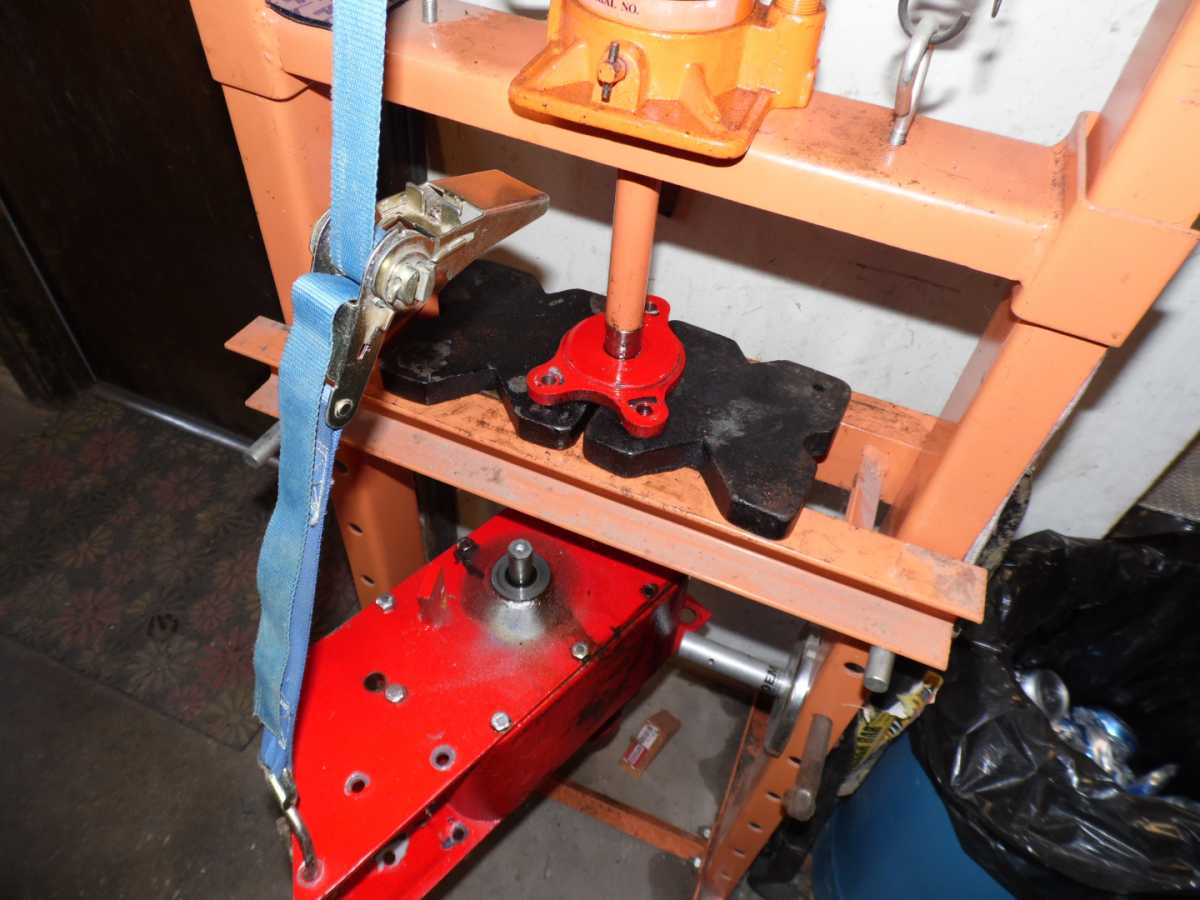

Pressing out the hubs

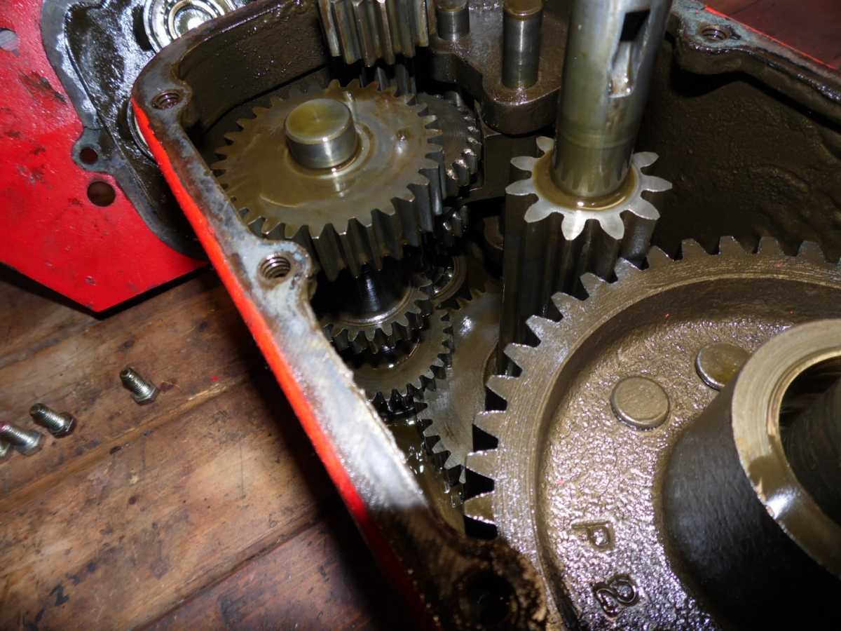

Internals

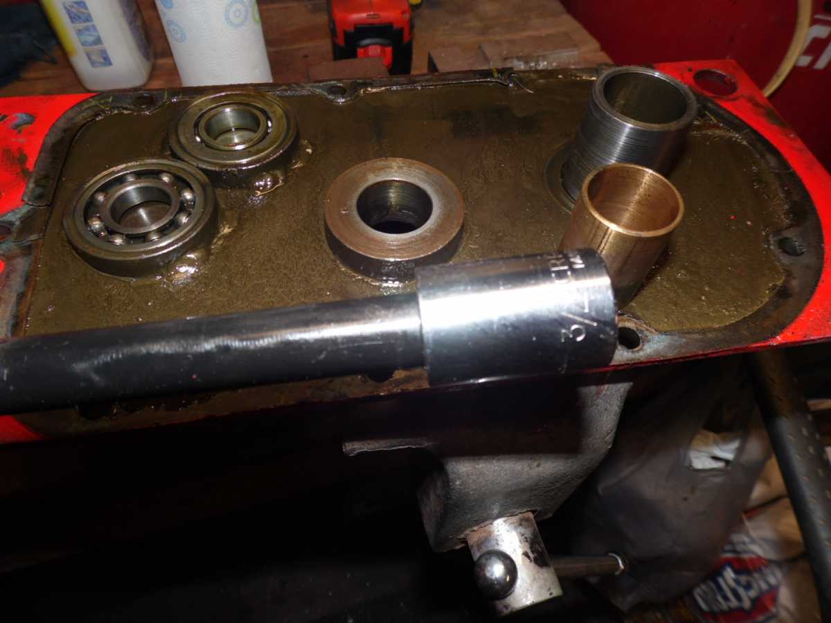

Axle bushing removal tool....

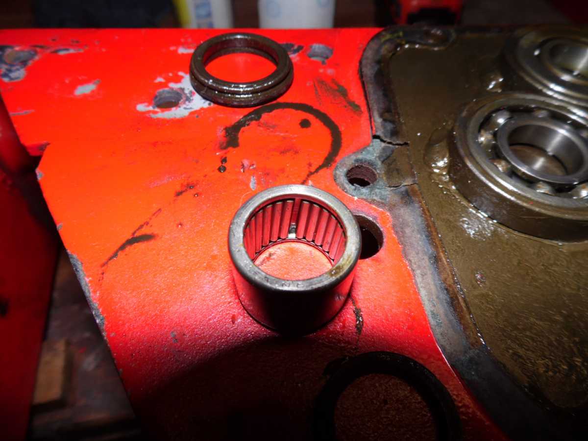

Bad brake shaft bearing (missing a needle) and seal

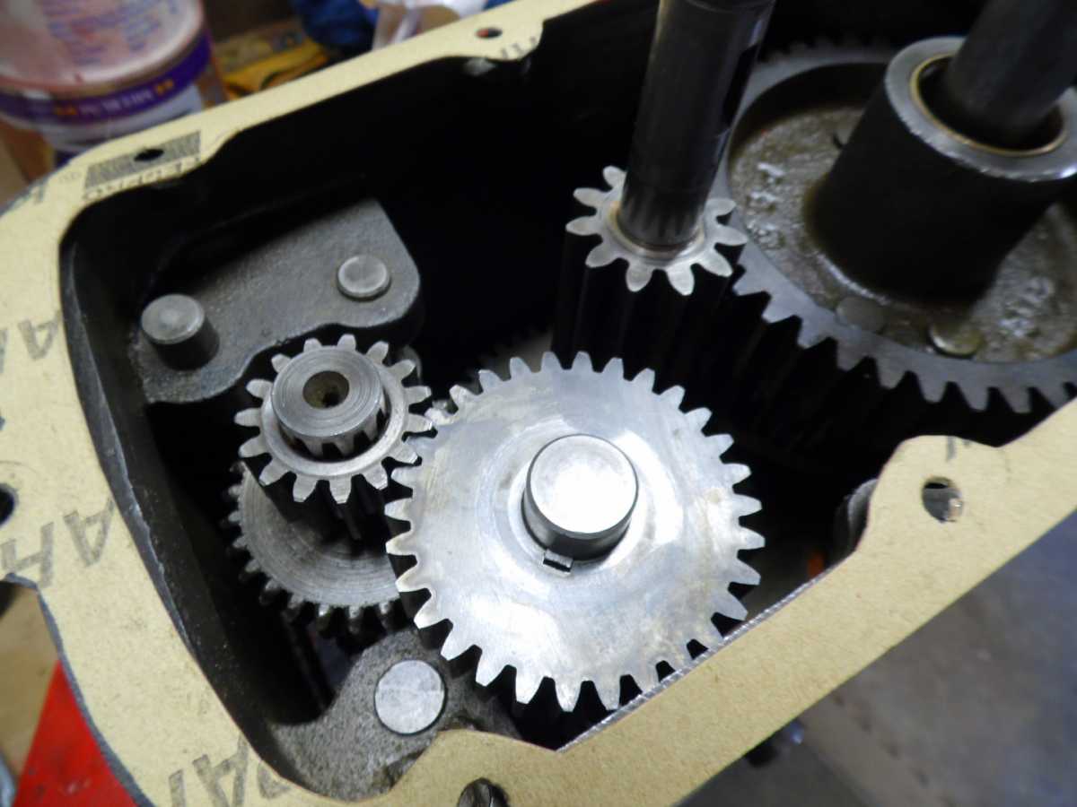

Closeup of the 2-3 gear

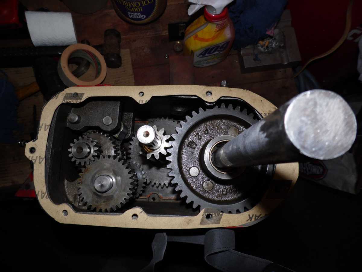

Reassembly nearly complete.
Buttoned back up and a fresh coat of paint
Wish I'd taken more pics of the reassembly but my camera crew was late for work that day :rolling

Same press as mine Bob, good price too. Money well spent for sure! I never would have got those hubs off without it.
