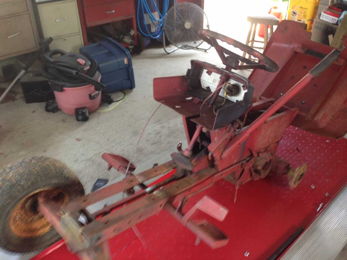

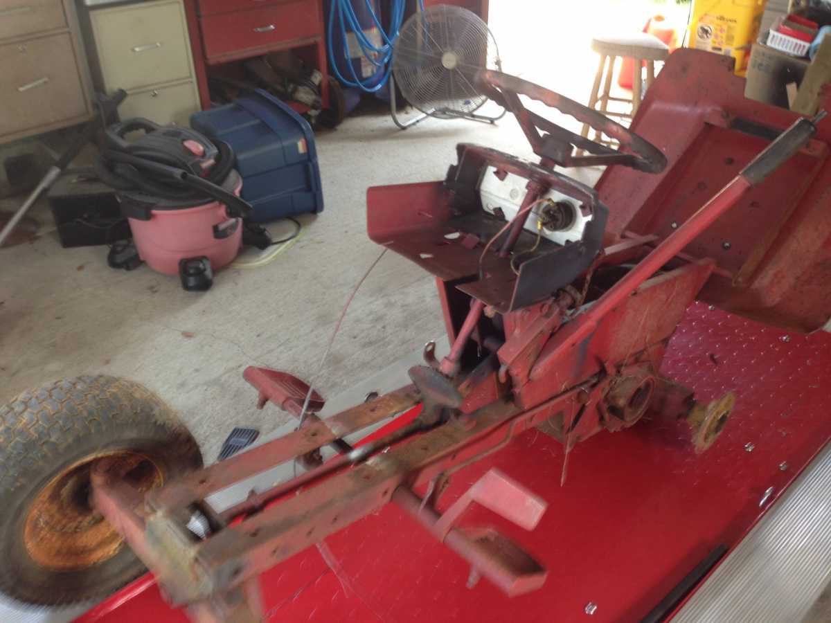

28 Jul 2015 19:42 #7215 by Bobster
Replied by Bobster on topic 857 tranny may be toast
I found a tranny donor today. Nice guy even delivered it to my garage and put it on the lift for me.
I have already got it off the frame and cleaned up some
