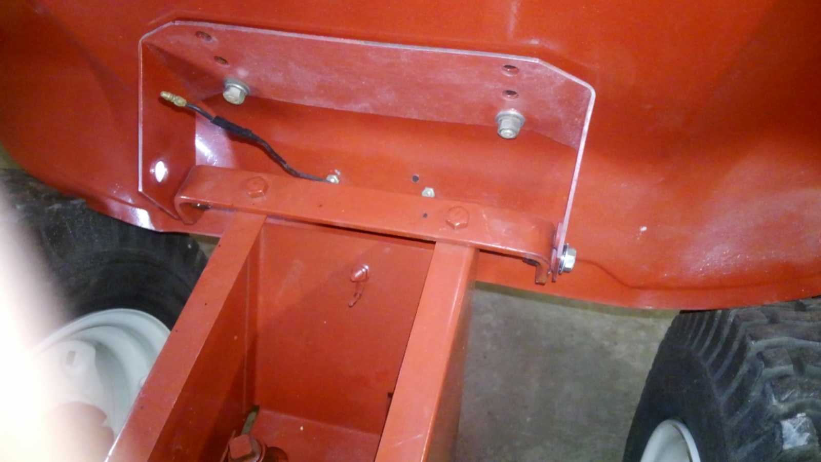

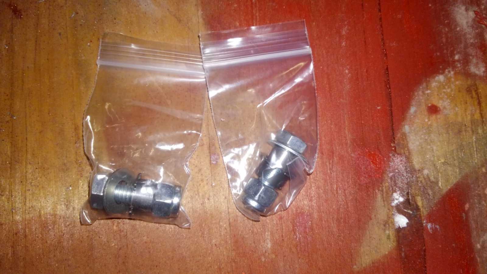

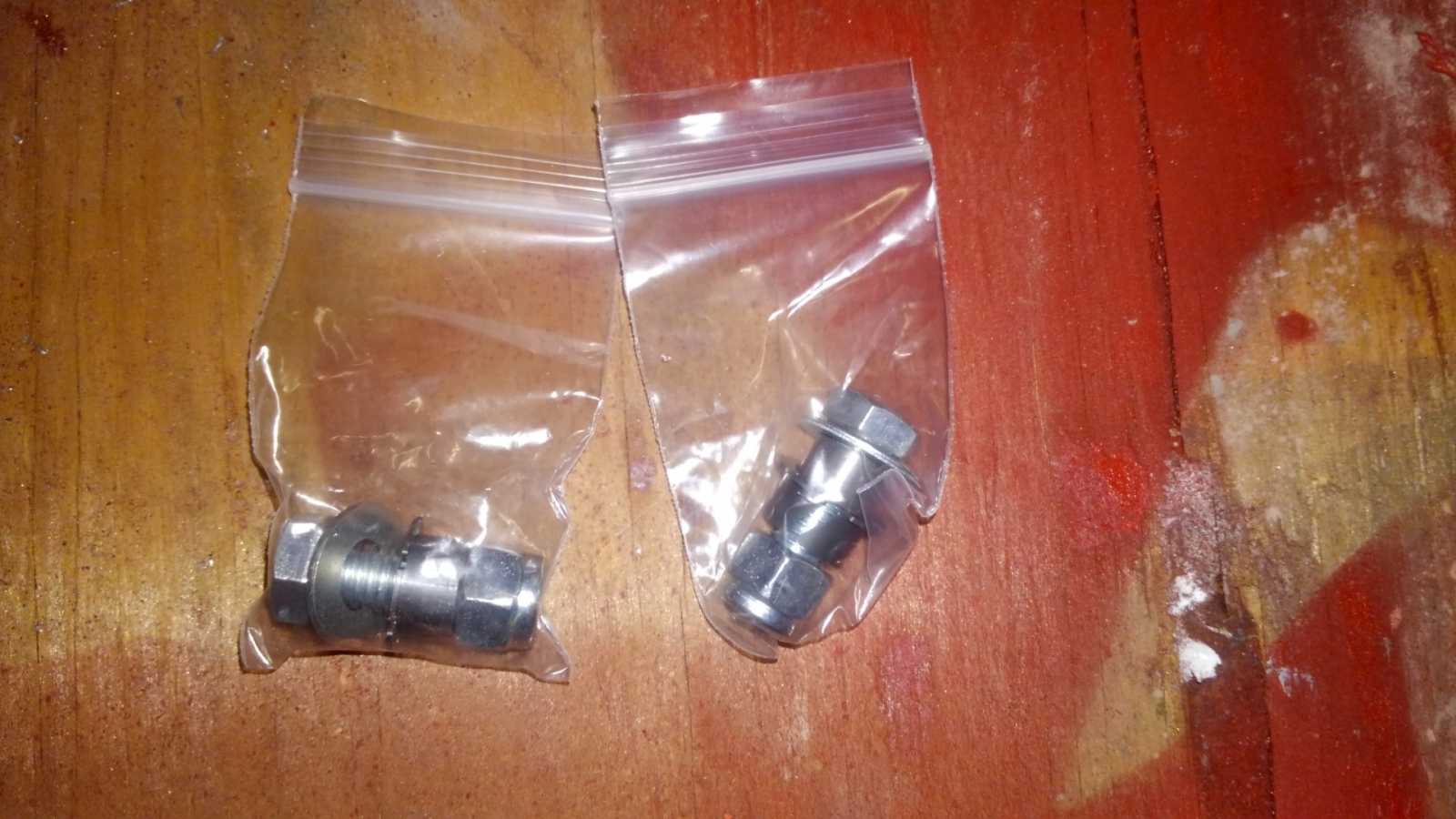

Working on the Wheel Horse 4937 Spacer. I need to ship out a few of these next week so they will be in the store shortly. I have something that works nicely for this and is the same OD and a little smaller ID which is good considering the original was a little too loose around the 3/8" bolt.
It will prob be sold separately for other uses and also as a kit with the bushing, bolt, and lock nut for the seat flip setups. The parts breakdown pics are below. :thumb1

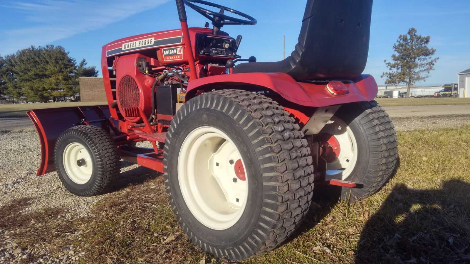

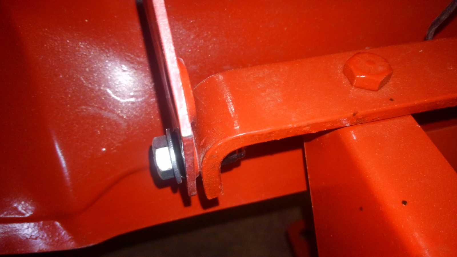

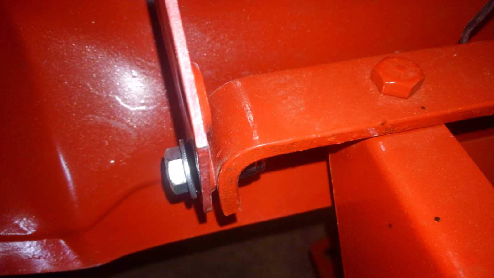

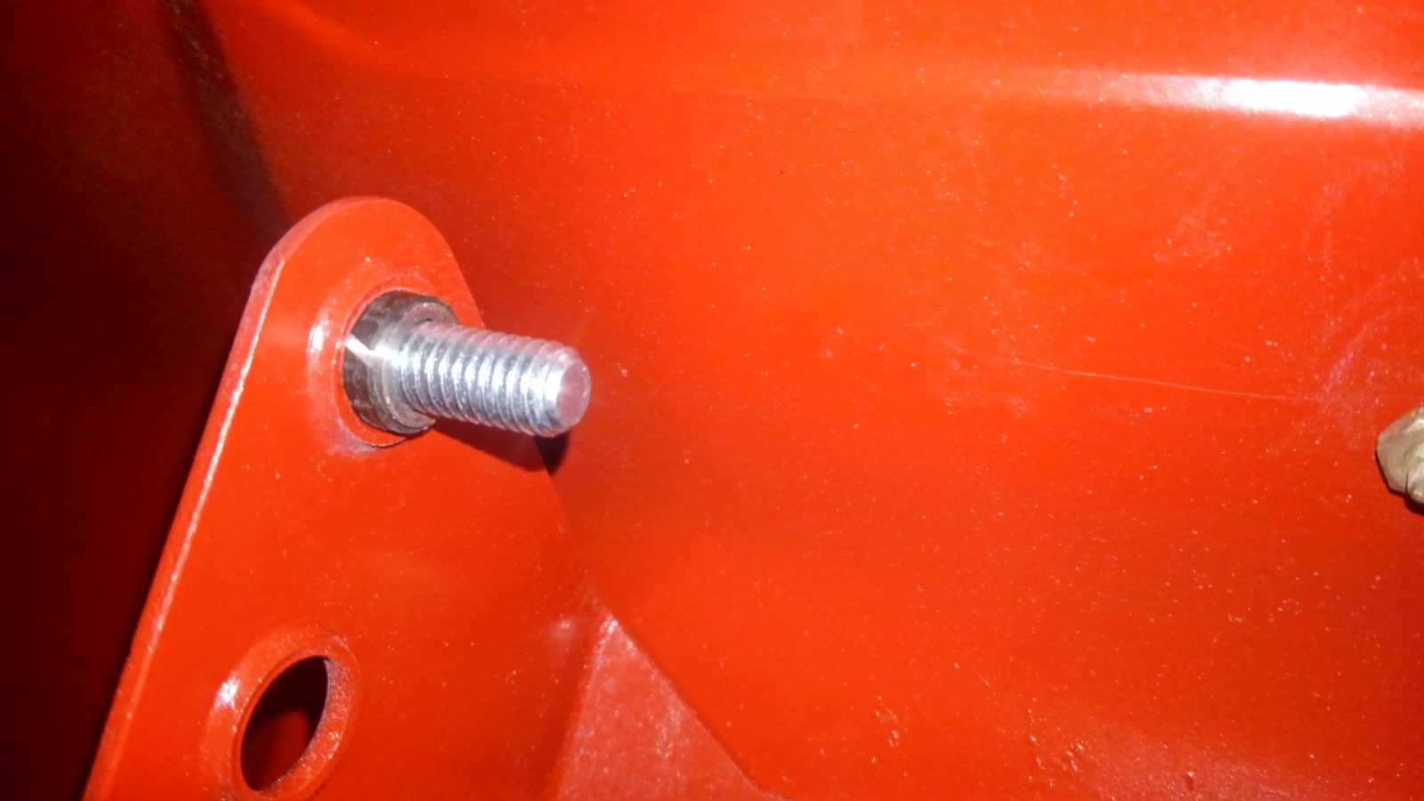

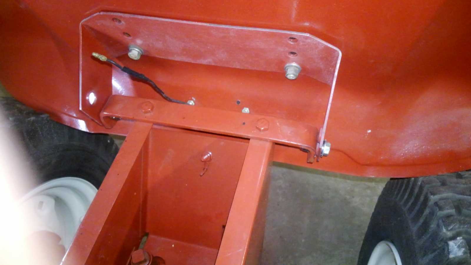

22 Dec 2020 21:49 #16563 by Rusty Tinsnips
Replied by Rusty Tinsnips on topic Wheel Horse 4937 Spacer
These came today and I got then installed, they fit perfect. Seat works better than new!
Thanks Gene for making my horse well again. You are awesome!
