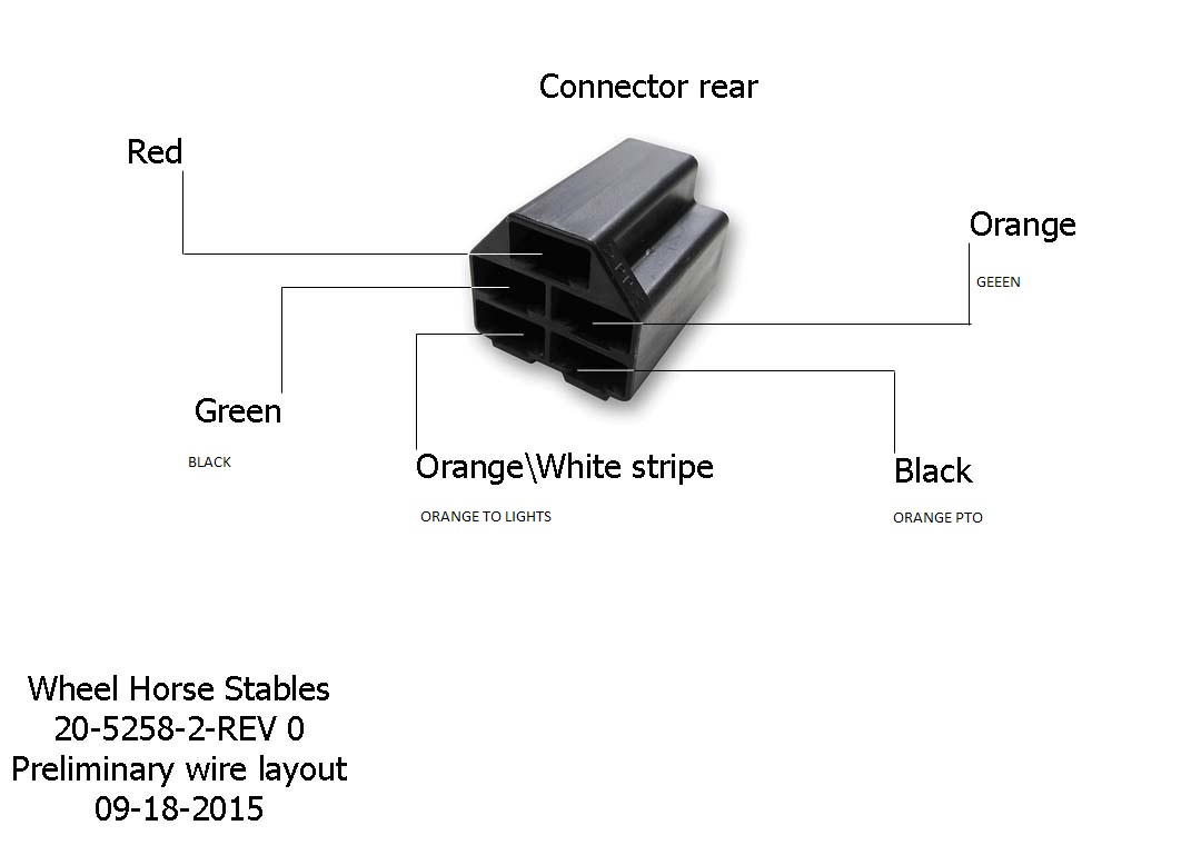

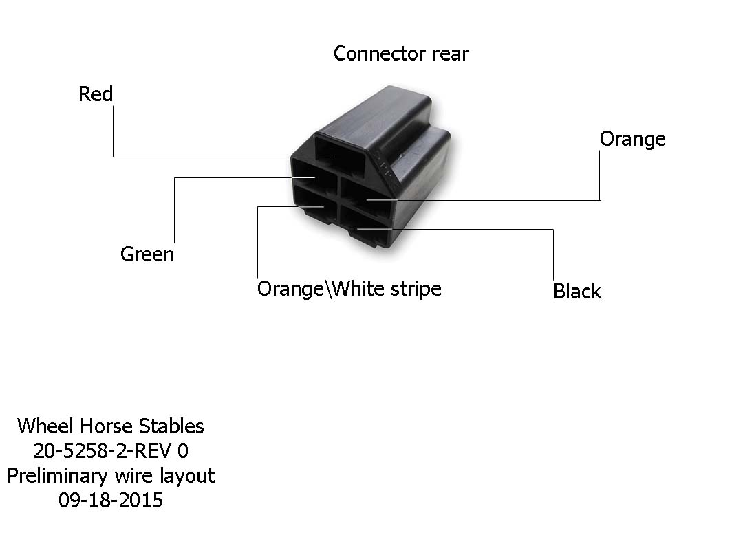

We have a quote and quantities we are satisfied with and are proceeding with a sample. Can you guys that have any pre black hood Indak switch tractors please double check me on this wiring pigtail wire color pic below?
The pic should be the pre black hood wiring scheme, only thing being changed is the light wire will be orange with a white stripe instead of just orange. I will be emailing it to a few of you guys also. :)

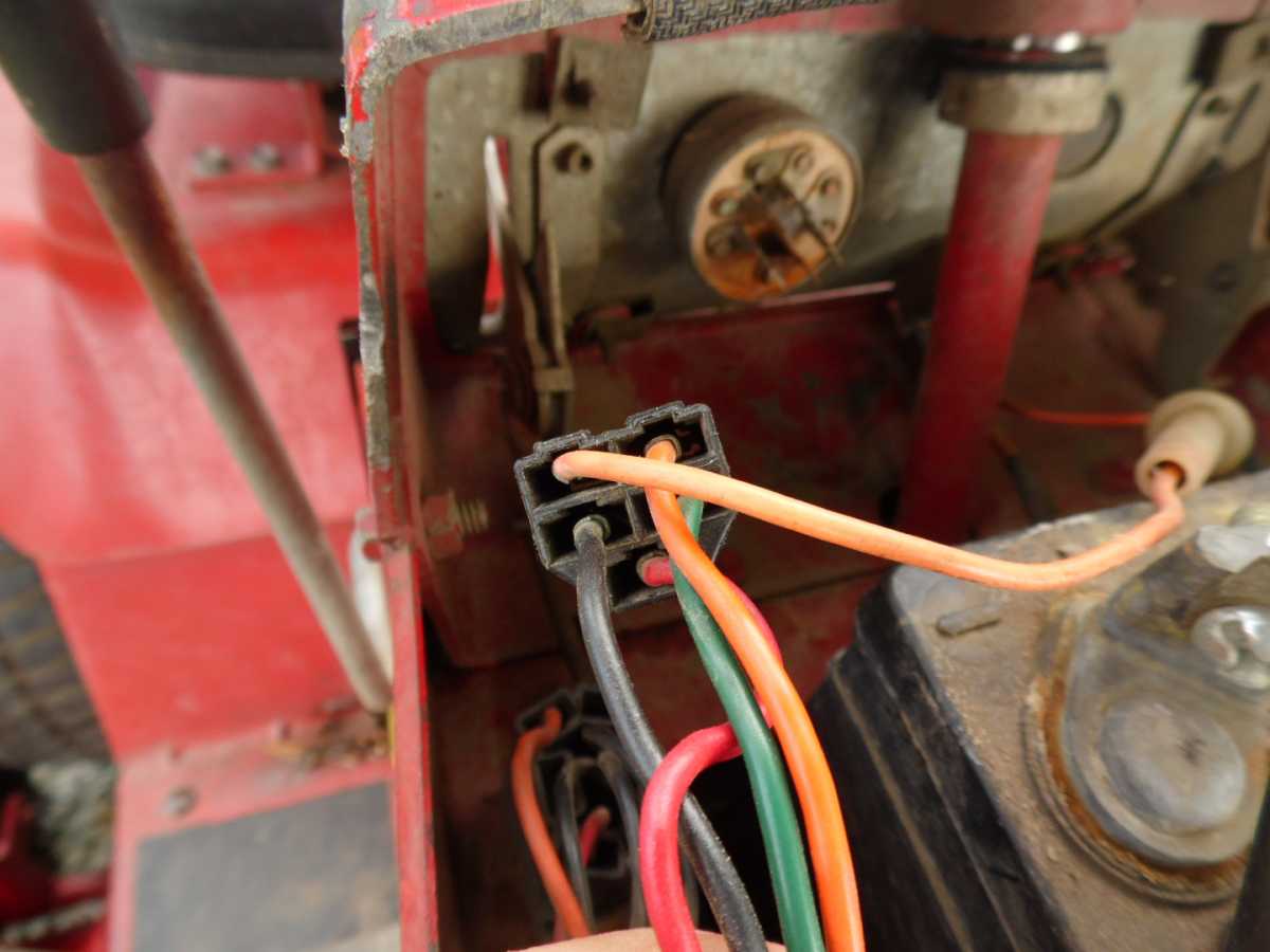

Geno here's the wiring on my C-161 Auto from the front of the connector/female side
Last edit: 19 Sep 2015 11:46 by M Bailey.
