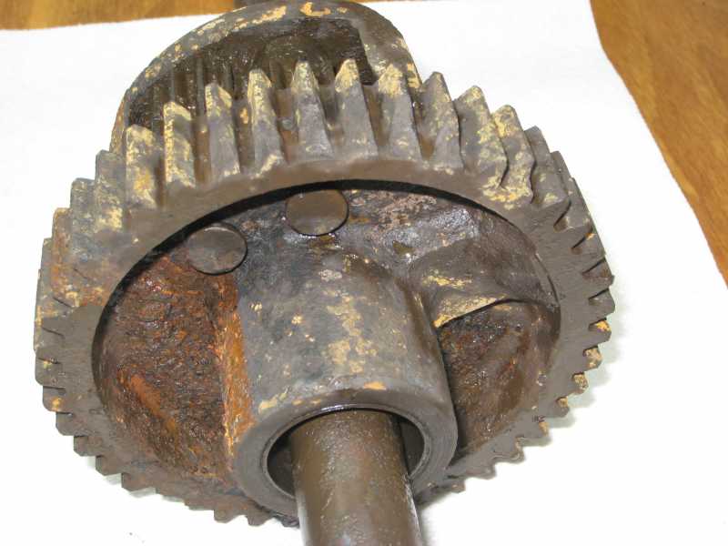

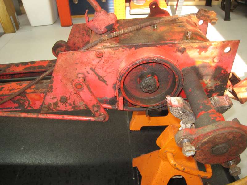

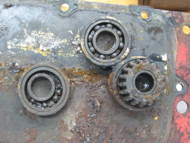

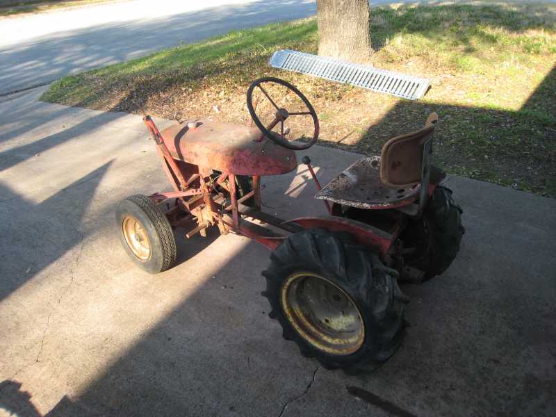

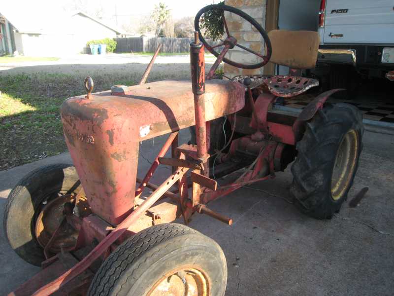

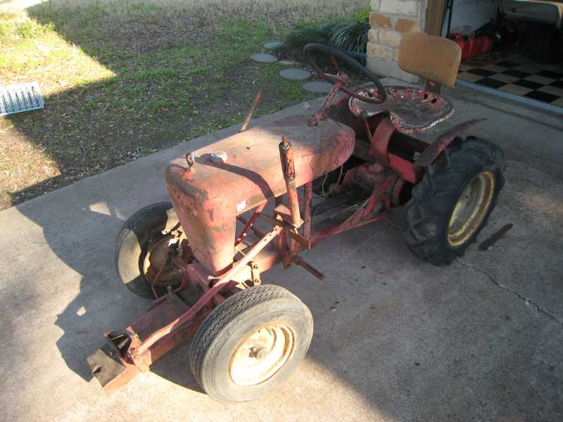

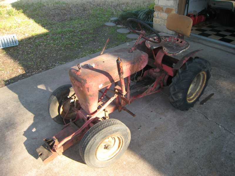

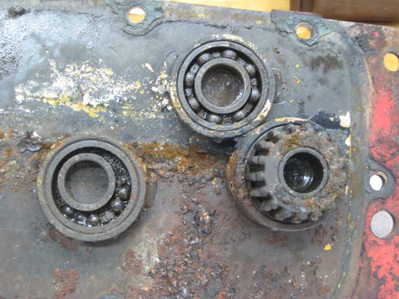

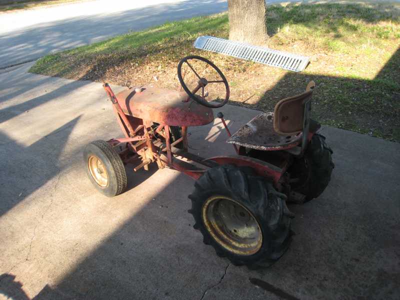

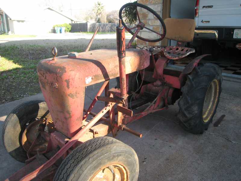

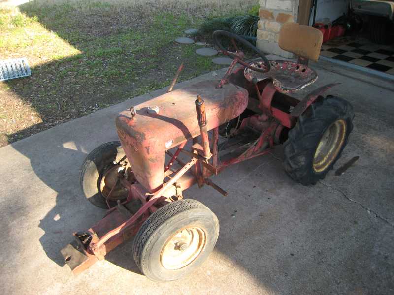

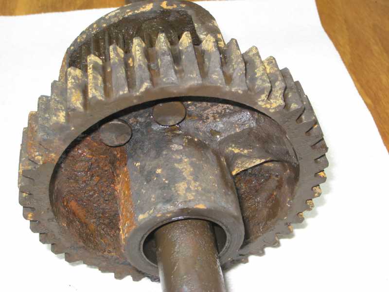

On Geno's prior Wheel Horse site I had started my RJ58 project and will continue to post updates and pictures on the new site. I know everybody likes pictures. Just a recap of where I am now. The tractor has been taken apart and cleaned. This week the big parts are to be sand blasted and primed, The transmission was locked up and when I tore it apart, I found broken teeth, lots of rust and the trans fluid had solidified .I have since completed the trans rebuild, found replacement gears on E-bay, put in new bearings and new bushings, and seals and gaskets. Today I was able to paint the trans and tomorrow I will put on pulleys and brake band and post some pictures. Here are some before
pictures of the tractor and trans gears.

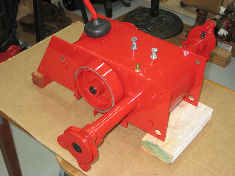

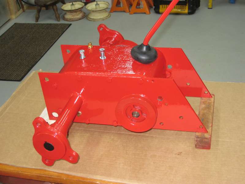

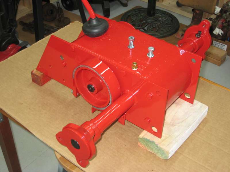

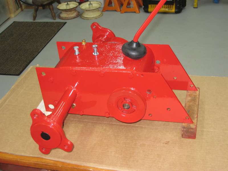

11 Mar 2015 14:28 - 11 Mar 2015 20:38 #726 by motor12

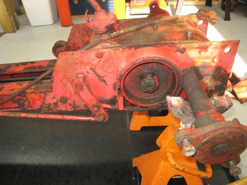

Finished up the trans and attached a couple pulleys. Here is a before and after picture.
Last edit: 11 Mar 2015 20:38 by motor12.
The following user(s) said Thank You: Trouty56, nappypappy
11 Mar 2015 15:09 #727 by nappypappy
Replied by nappypappy on topic Rj 58 progress
wow looks like new now or even better than new.....great job :cool
11 Mar 2015 18:46 #735 by Geno
What a handful, especially the welded on brake pulley. You do some nice work Motor. :goodjob

11 Mar 2015 22:54 #747 by jm46322
Replied by jm46322 on topic Rj 58 progress
nice work on the trans, It looks like your setting the bar pretty high for the rest of us.
sealing up a rebuild is almost bitter sweet, a LOT more work goes into it then most ever see or know.
when you open them up to find a mess and nothing turns its great being able to run through all the gears and see the wheel shafts turn when your done;
Then that nagging question what were they thinking when that brake got welded?
I know we all hate that feeling when run across those speed bumps.
SPEED BUMP was about the only thing i could think of that describe them that would not get in trouble.
cant wait to follow the progress.
