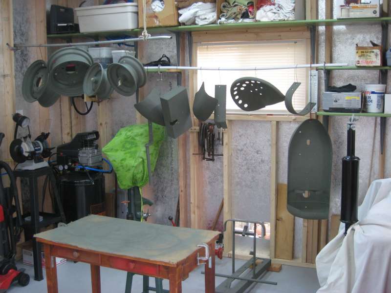

If the weather is not wet Monday, this is what is going to be sand blasted. Then I can start the body work, filling holes, fixing dents and repairing cracks. All the small parts have been cleaned and painted along with the steering wheel I repaired using epoxy and micro balloons. I'll get a picture of the steering wheel after it is dry.

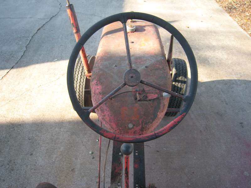

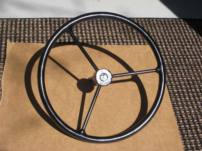

14 Mar 2015 18:46 #944 by motor12

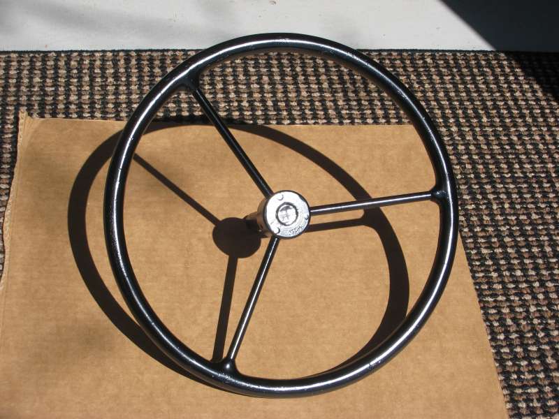

Here are a couple of steering wheel before & after pictures. I restored it to look almost new, but not over done.
14 Mar 2015 19:22 #946 by jm46322
Replied by jm46322 on topic Rj 58 progress
nice job on wheel but you lost me at " I repaired using epoxy and micro balloons."
can you go on about this topic or what the stuff is or can be gotten at?
i have a wheel that was going to get 2 part epoxy & body bondo maybe its now plan B
14 Mar 2015 20:08 #949 by Geno
Came out really nice Motor. :thumb1
  • motor12
14 Mar 2015 20:51 #951 by motor12
jm46322 wrote: nice job on wheel but you lost me at " I repaired using epoxy and micro balloons."
Micro balloons are a light weight filler designed to be mixed with a two part epoxy. I use a 15 min epoxy that can be purchased at any hobby shop or hardware store. The micro balloons are made of Soda lime borosilicate glass and need to be used per the instructions. What they do when mixed with epoxy is allow the epoxy to flow into cracks where bono may not go. Also they allow for easier sanding of the dried epoxy. In other words it gives the epoxy more body. The micro balloons I am using I purchased from our local hobby shop. Hope this helps

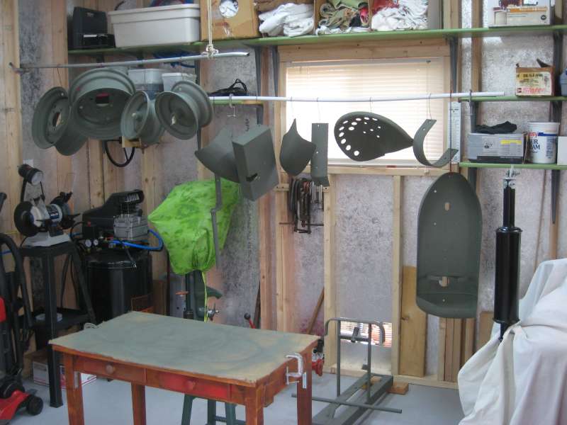

My sand blast guy started bustin rust and paint about 0800 hrs and called me a couple hours later to pick up the parts . I got the parts home and primed right away. We have rain moving in tonight and I did not want the humid air to rust the bare metal. Now I can start the body work, the greasy stuff is done, thankfully.
16 Mar 2015 16:56 #1131 by AJ WH Ranger
Replied by AJ WH Ranger on topic Rj 58 progress
Wow! That looks great! :thumb1

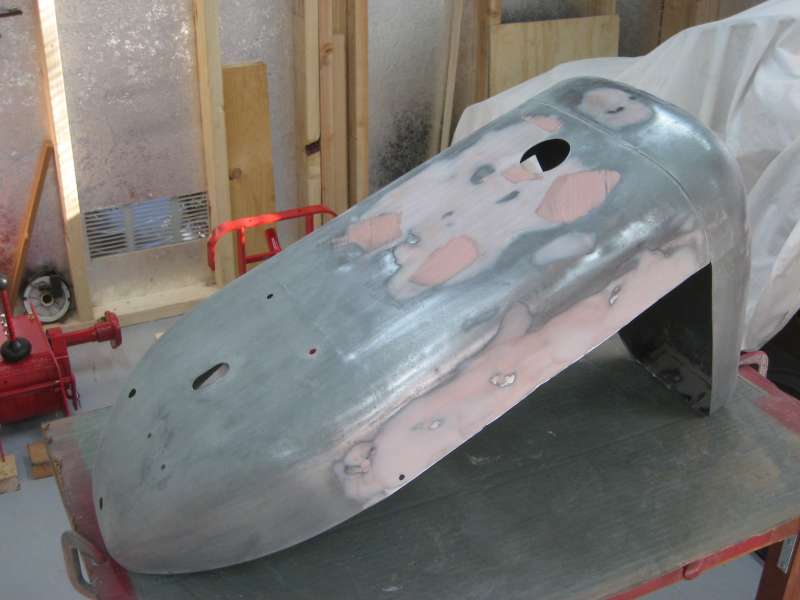

18 Mar 2015 20:24 - 18 Mar 2015 20:28 #1323 by motor12
Spent a day and a half on the hood, I had 13 holes to weld up and a bunch of cracks around the gas tank fill hole. Had to make a new tank strap and weld in also the bottom attach point was cracked and rusted, had to add new metal in this area. Lots of small dents that take time to fill and sand then fill and sand some more. It looks bad now but once painted it should look ok.
