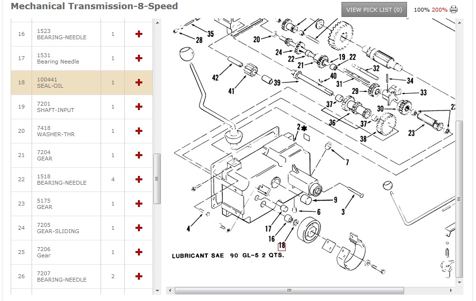

Hey Nappy. Here's a breakdown. Sorry so late, we were out cutting wood all day yesterday. :)
The Toro seals aren't very good, look for a seal #7410. NAPA has them and so do lots of other places.

Geno wrote: Hey Nappy. Here's a breakdown. Sorry so late, we were out cutting wood all day yesterday. :)
Ok thanks....I got a breakdown and after looking at the tranny I couldn't see a seal...but now I know its small small...........:smile2
