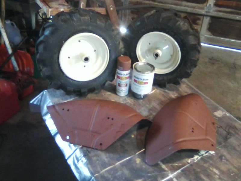

Yippee Ki Yay wrote: Rims look great. :clap
well its coming along just like spring.....
but that is just a sneak peak at the official "" RUSTOLEUM POST"" (aka shameless attempt at site sponsorship & discount coupons)
right now its top secret but legal and marketing need to review it, before release to the public.

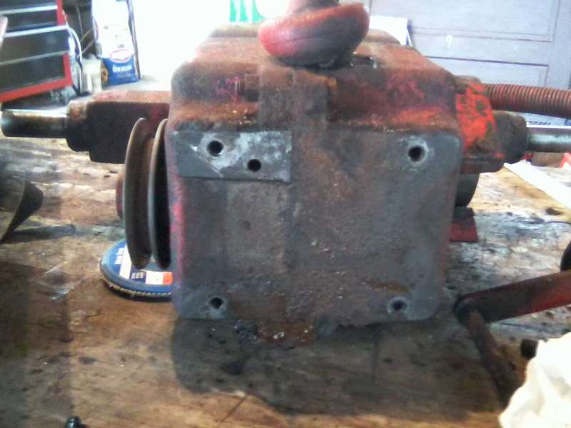

24 Mar 2015 20:05 - 24 Mar 2015 20:09 #1881 by jm46322
[size=3]Made a little progress today but also made a few U-turns also.

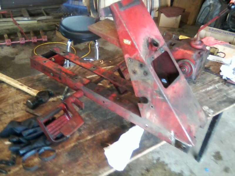

got the trans and frame separated, the trans held no surprises from the out side all shafts feel good,
but it will get opened up cleaned out and inspected with new seals as a minimum.
[/size]

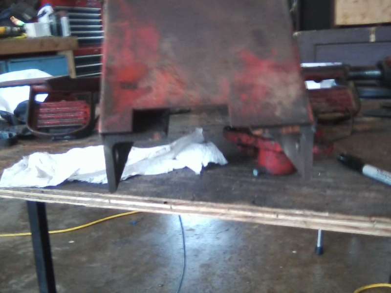

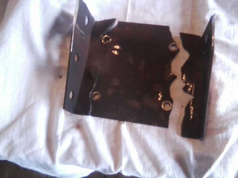

the plate that mounts the trans to frame is gone i knew it was bad but not this bad,
that smoke you smell is me thinking, or maybe the grinding from cutting it off.
the frame rails of the tractor is 2x2x1/4 angle i am thinking of notching a couple pieces and cropping them in
as a replacement for the bracket
i am planing a separate write up for this repair fab-up as i do it, might even get a measured pdf out of it.

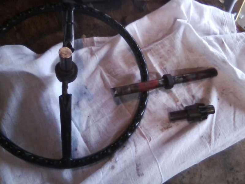

U-turn was the steering wheel, the steering wheel its self is poor shape and at best needs to be drilled out to be removed, and the lock collar was locked and not coming off.
So Mr Sawz-all come out now i got 3 in place of 1, But i will be cheating and going back with stainless .
but every thing else that came off the frame looked good.
so all in all full steam ahead.

Making a lot of progress there. :thumb1 I haven't seen a mounting plate that bad. :doh
