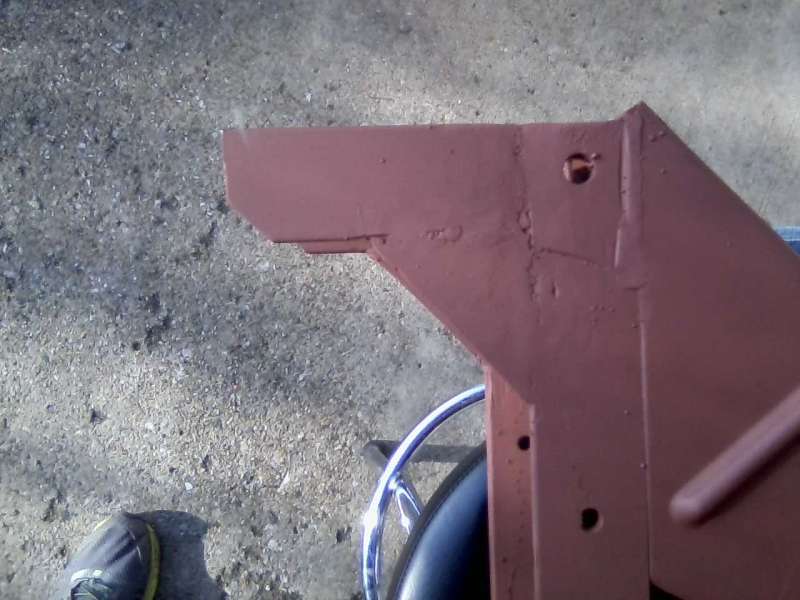

time for a update on the progress

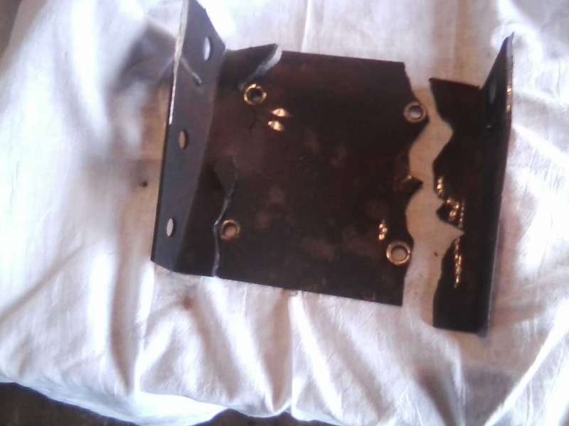

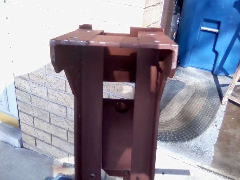

if you all remember it had a destroyed mounting plate
well this is the reworked redesign
the frame rails on the tractor are 2 x2 x 1/4 angle
with that in mind i made up brackets out of the same stock
and cropped them in at a 90* return and added a gusset on the side
along with a spreader at its base.
a full more detailed write will follow with measurements.

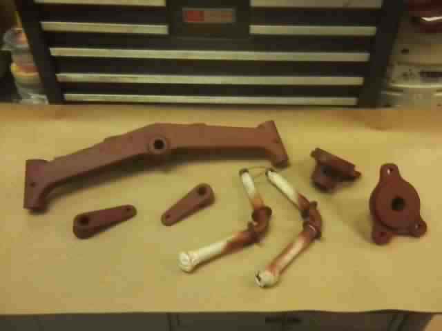

this makes the last batch of stuff to get under primer

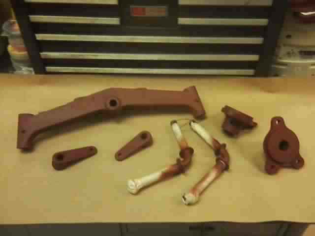

with that being said, when i did the front axle i had just put fresh black beauty in the blaster
and it came out shining making me think CHROME
has anyone ever seen the front end chromed?

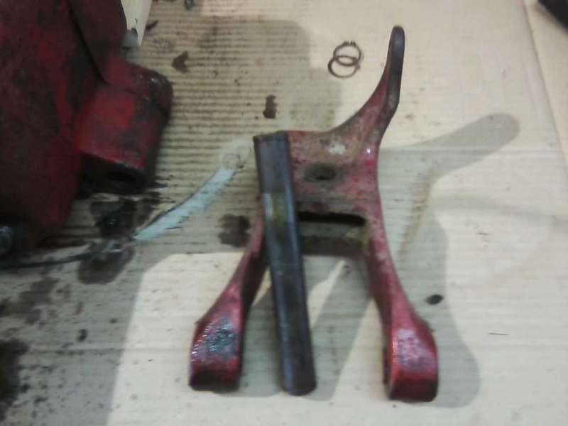

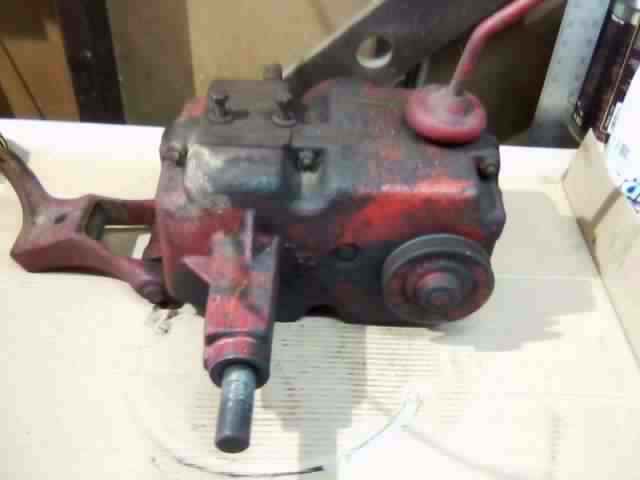

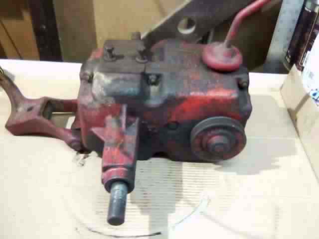

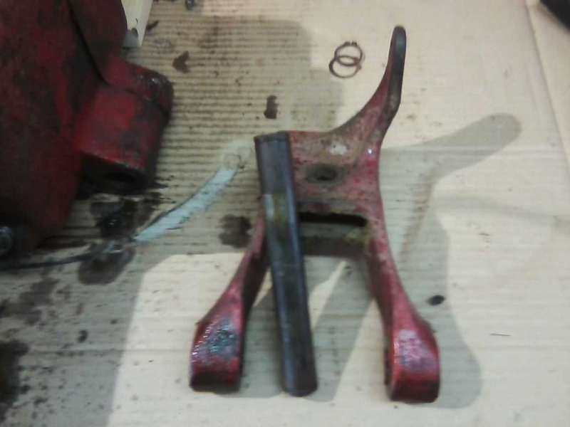

i was going to get the trans opened up, cleaned up and such today
this is what i started with
but this next picture is what i ended up with today
the pin is out and i will leave it at that.
sneak peak at whats next

Chrome....you know they have a powder coating that looks almost like chrome......anyway.....lookin' good. Those pins can be a bugger......hitch pins, steering wheels, and hubs......worst part of a tear down.
That frame looks really rigid now..... :)
03 Apr 2015 04:50 #2523 by GT 14
Big improvement on the plate. :goodjob
03 Apr 2015 08:13 #2543 by Geno
There's a plate that can't be broken. :goodjob
03 Apr 2015 08:19 #2547 by M Bailey
John that transmission mount looks bullet proof :goodjob

awesome work that plate will be intact 50 years from now
