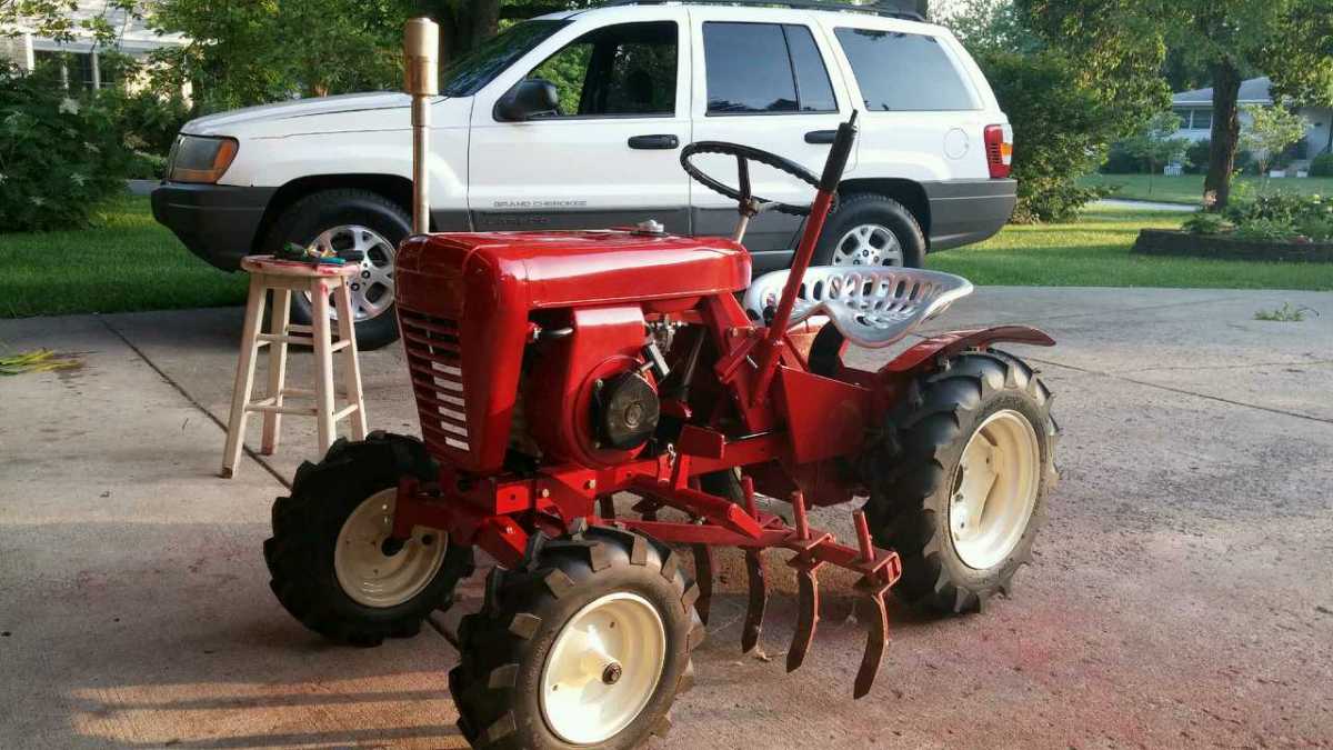

04 Jul 2015 00:21 #6490 by JERSEYHAWG
Replied by JERSEYHAWG on topic 654 full restoration
Your in the groove, looking better. Let me ask please, why the 3m sanding foam? Curious on that. Ty
oh, also, like the way you found that brass bushing. Might have to scarf one up.

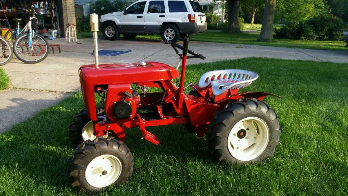

04 Jul 2015 06:30 #6493 by GT 14
Looks great! :thumb1 Are you rebuilding the engine or just paint?
04 Jul 2015 06:51 #6499 by M Bailey
Coming together nicely John. If that seat is what I think it is you shouldn't need any additional weights. :goodjob
04 Jul 2015 09:55 #6503 by jm46322
thanks guys for all your comments it seems like we are getting to the fun part
to me the sanding foam gives me a much more even contact area.
it takes away the pressure points that i would see when using colth.
it also produces a very nice feathered edge all by its self with normal use.
i use 2 like different types i will post pic after today of them.
the bushing is something i could not happier about. the steering feels great !
its a 3/4id X 7/8od flanged bushing just over $2 funny thing is the lock collar was just a few cents cheaper...
let me know if you cant find any i would be happy to mail it to you.
GT the engine a H70 has been gone through sitting next on bench waiting to have magenito put back on and set up.
ANY AND ALL HELP WITH H70 MAGENITO & POINTS w/ 3AMP COIL PACK WELCOME TUESDAY EVENING IN FRONT GARAGE.
STUDYING THE WIRING DIAGRAMS TODAY>
A RUNNER TUESDAY EVENING WOULD BE CONSIDERED A GOD SEND
Major not even thing is what it appears to be that perty seat is 100% cast aluminum and wieghts just a few pounds
hard to tell from pics but its unpainted and just its cast aluminum finish it came from a amish farm supply store a little east of me.

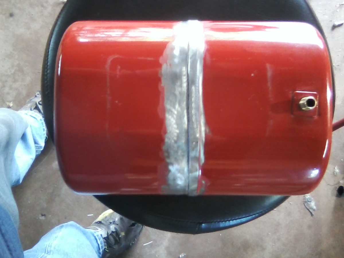

09 Jul 2015 22:36 #6661 by jm46322
when you smell gas, after the test run its not a good thing. the fact that the rustoleum is not effected by gas is very reassuring good thing! wiped off with no damage,
anyway added to the title today tin-smithing turns out the tank was leaking at the seam so i took it down to bare metal, added some good flux and some 95/5 silver solder.
no more leak, here a pic before the soldering.
